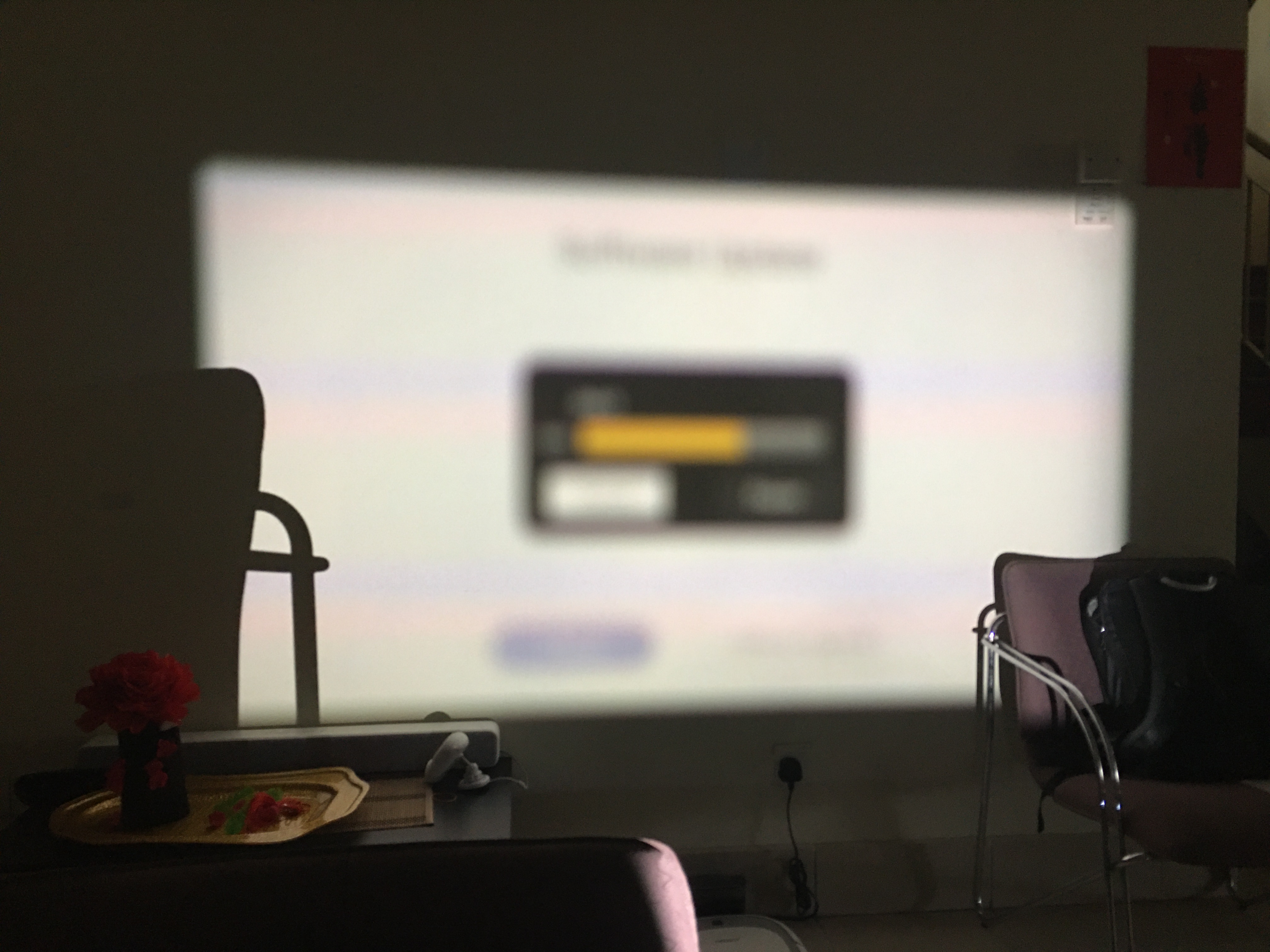

Please see if it’s possible to update the firmware and try again. If it still doesn’t work --> I’m afraid you need a replacement unit.
If you can’t see what you’re doing due to the image being out of focus, try moving it closer till it’s in focus so you can do the update.
Just Updated to FW 1.1.0 Still I am having the autofocus Freeze issue.
After Turning on the projector, for fine tuning the focus, i click the focus ring in the remote. The ring appears and the screen turns hazy and auto focusing freezes . Then as usual the ring disappears in 4/5 seconds then i again when i press the button and it focuses back(it sometime needs manual fine tuning too)
It happens everytime i turn on the projector or the first time i move the projector after turning it on.
@Philips_Support_P Please suggest. seems like the Update didnt fix it.
