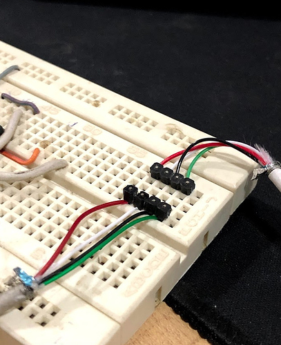

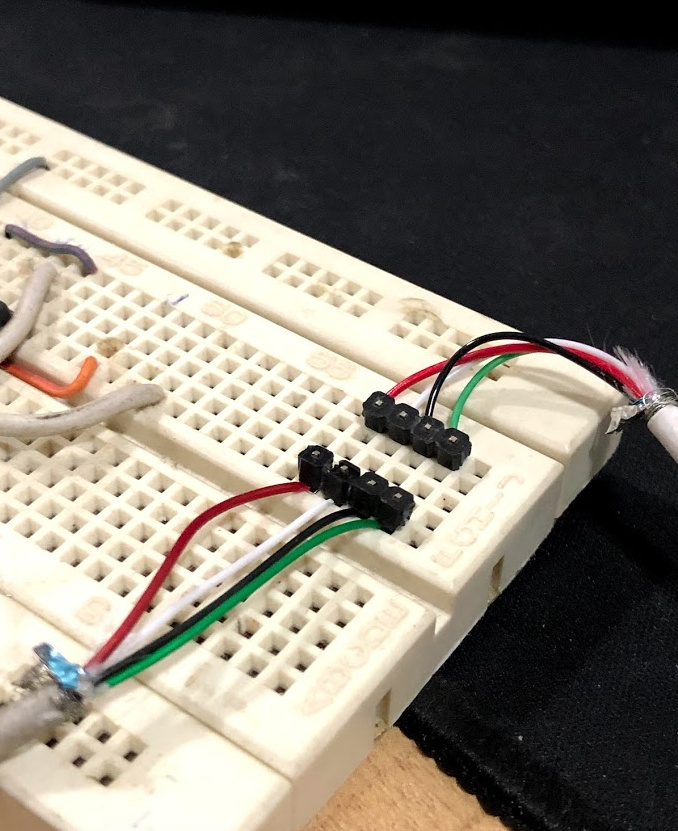

When I got my projector, the autofocus worked well out of the box (at least the first few times that I tried it) but I upgraded to the latest firmware and autofocus started to fail 9 out of ten times, sometimes every time, however, I could adjust it manually. I tried downgrading to 1.0.28 via the cable restore method. I didn’t have the cable so I found a hacky way of making one, which worked perfectly:
However, despite the older firmware (1.0.28), autofocus has not improved, as you can see in this video:
And this is how it was before downgrading:
Please advise what the next steps are for me and what is being done to address the autofocus issues. Autofocus is a fundamental part of a portable projector (if it doesn’t have an external manual focus dial) and even some cheaper portable projectors from 2-3 years ago haven’t faced this problem. It seems like everyone has gone silent about this and the only ‘focus’ is on the next lineup. Please don’t forget us ![]()
