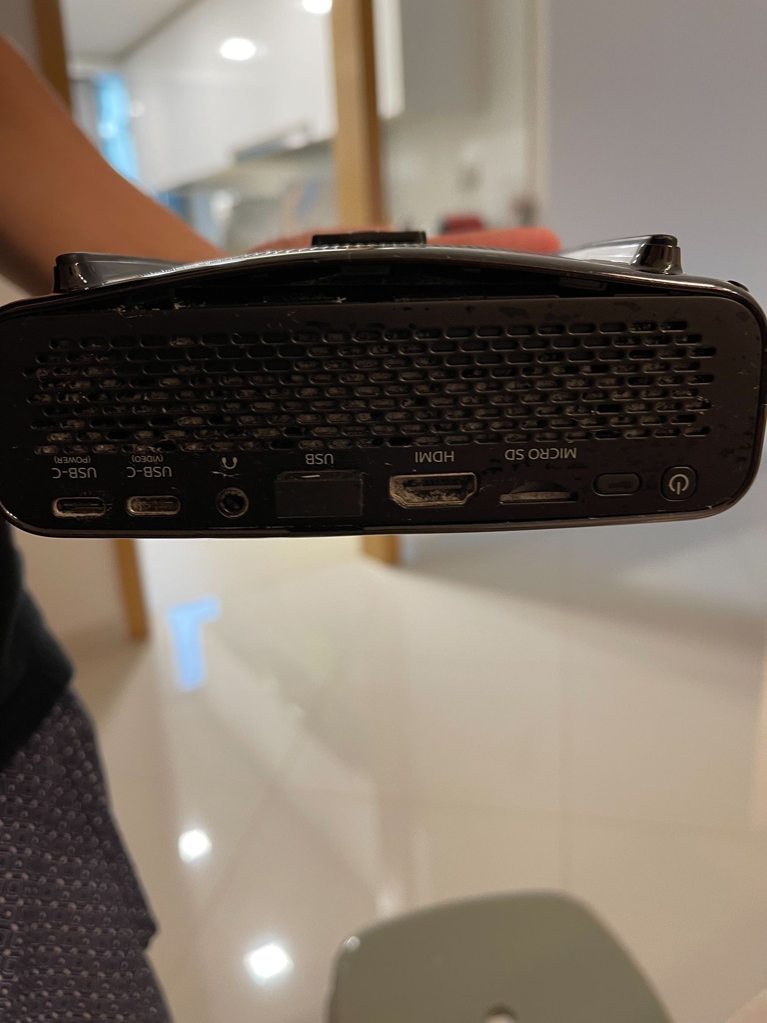

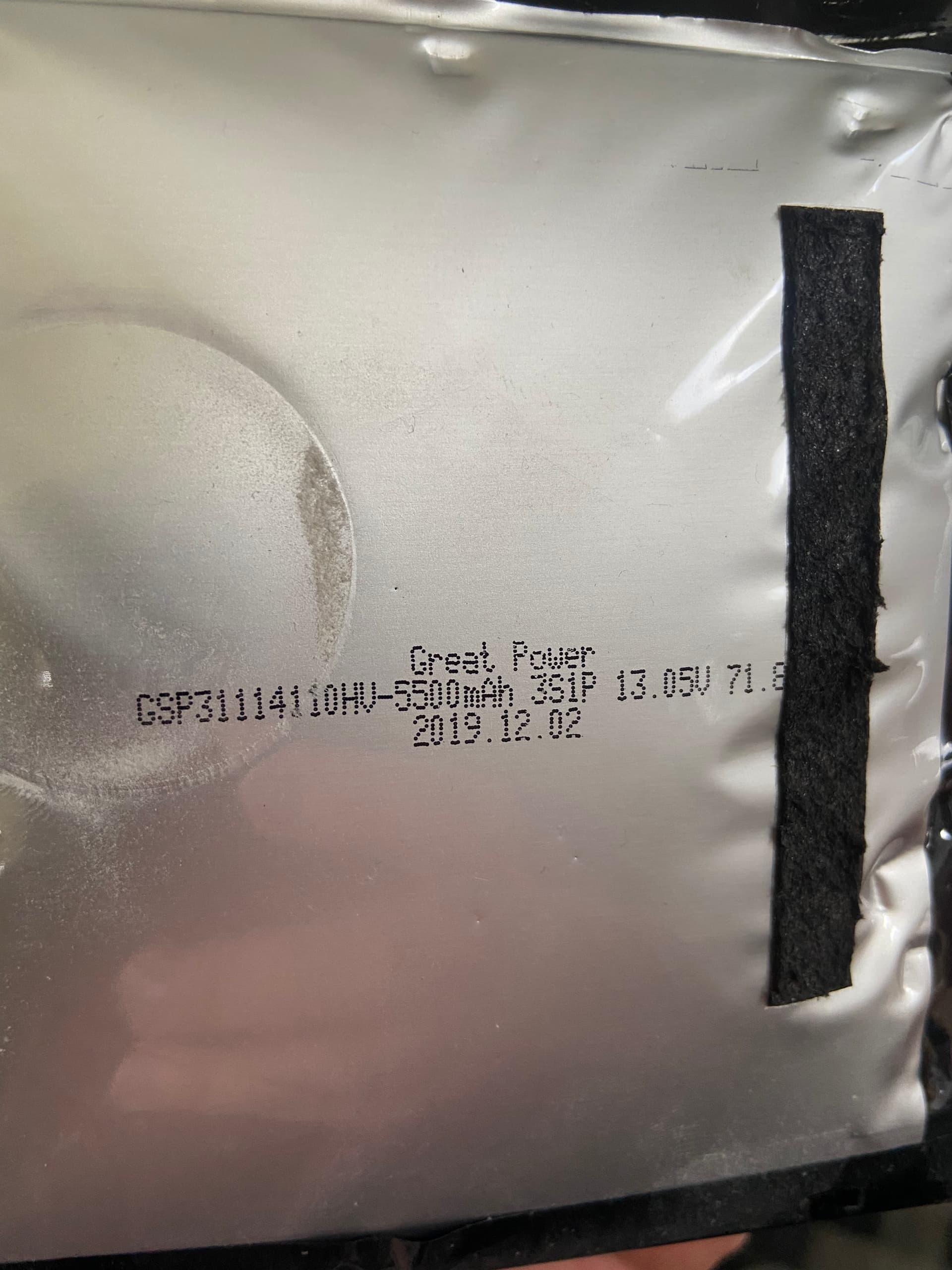

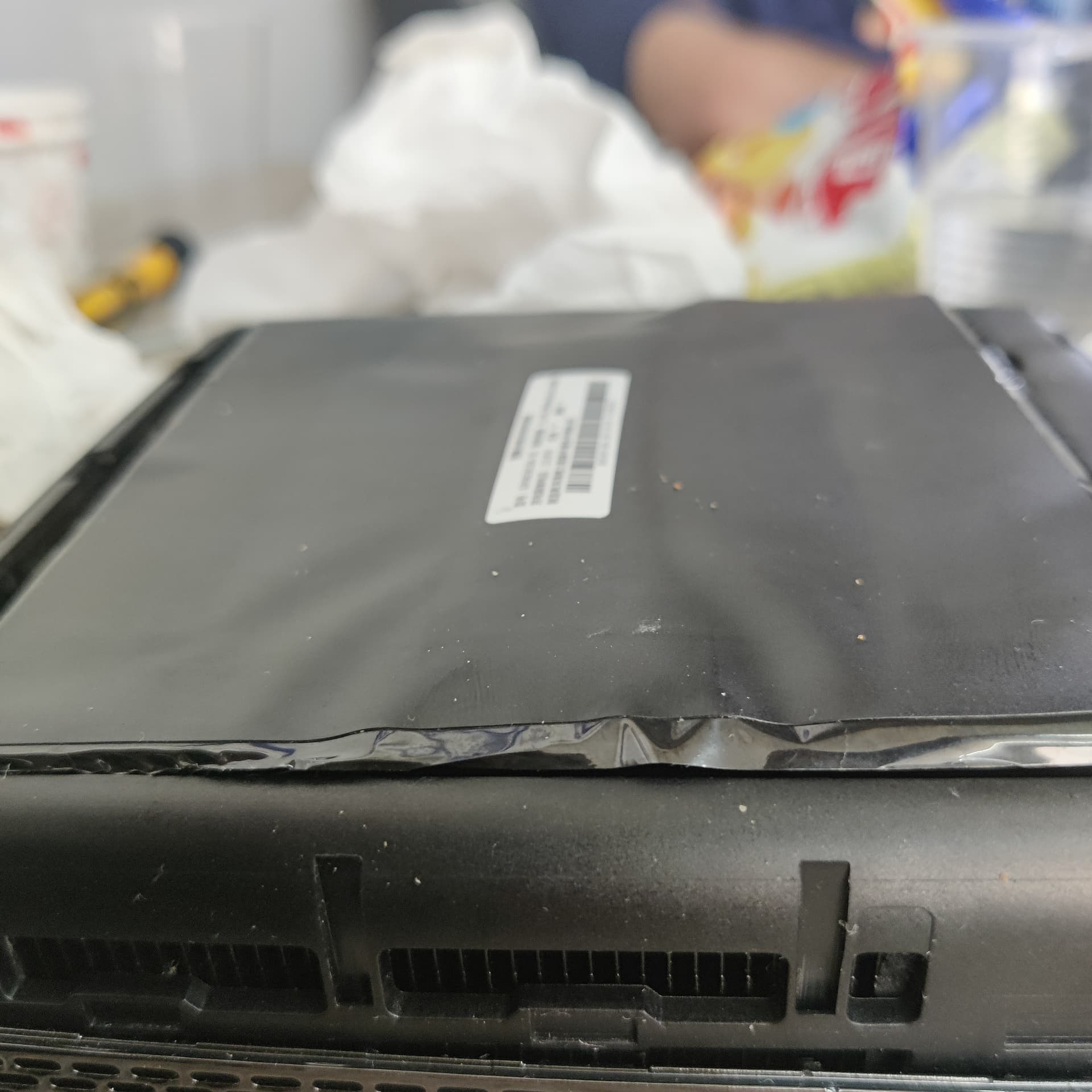

Hi, the battery pack is bloated, causing the casing to swell. It is very unsafe to use. How can i request for a repair?
That is serious bloating of the battery. Contact Phillips immediately for service.

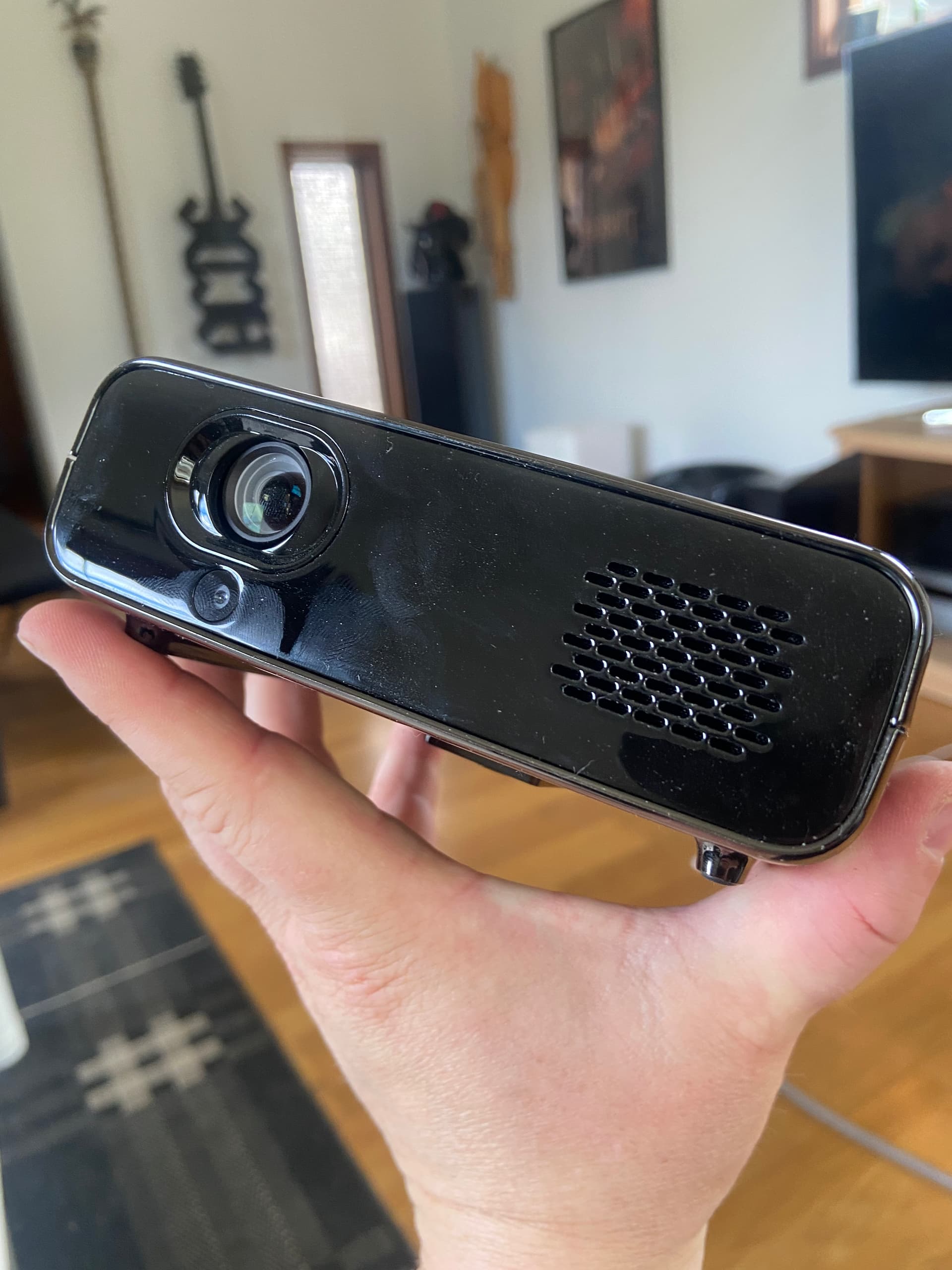

Hi.

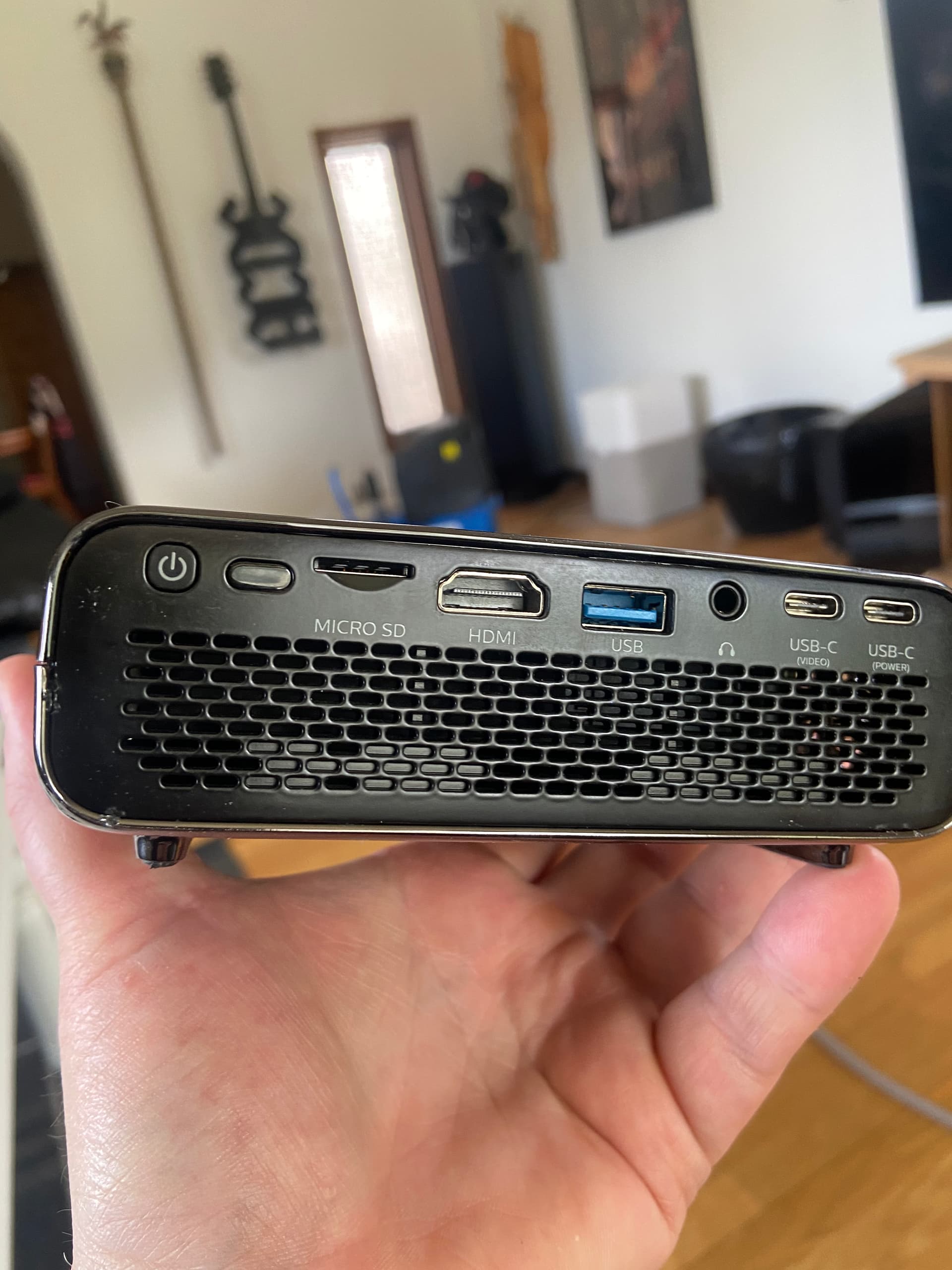

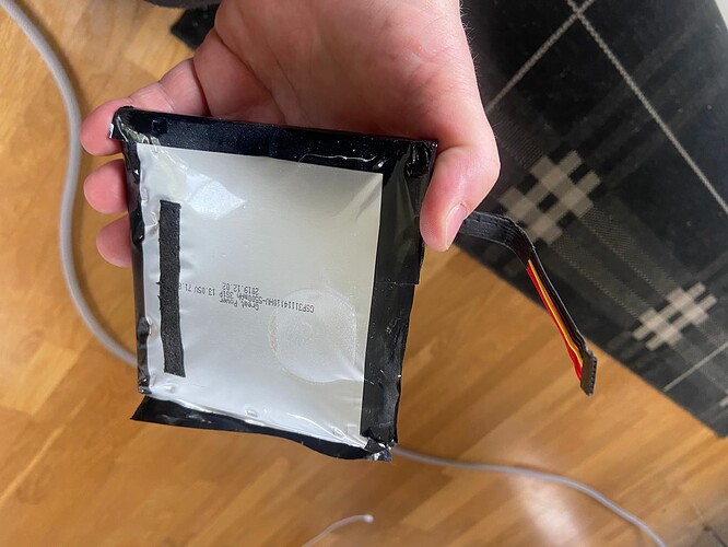

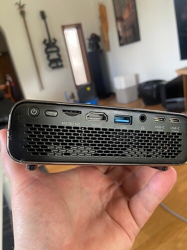

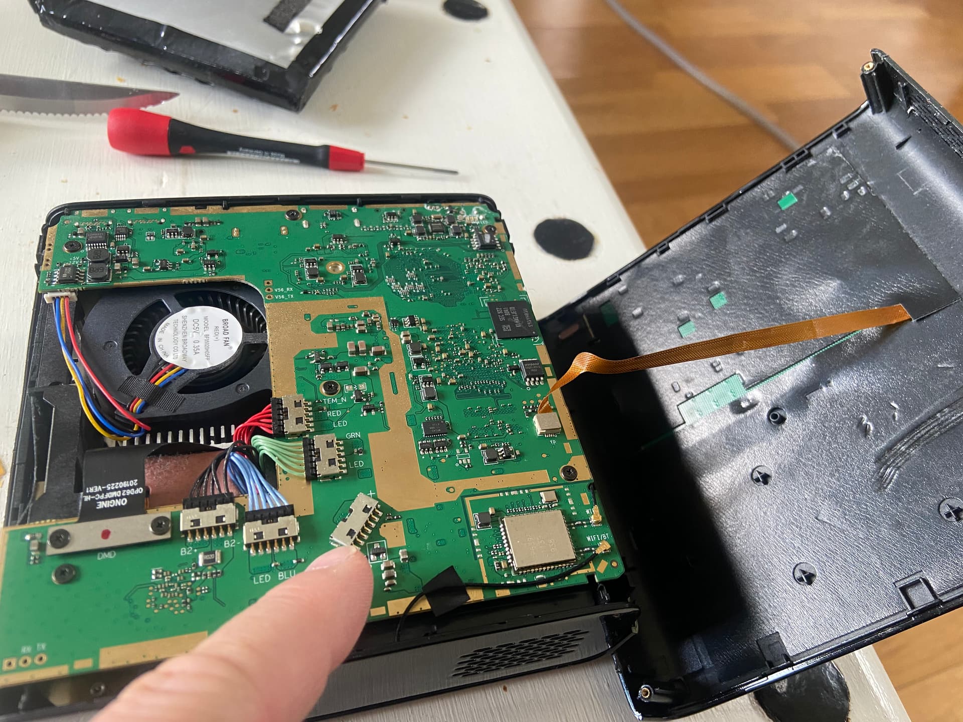

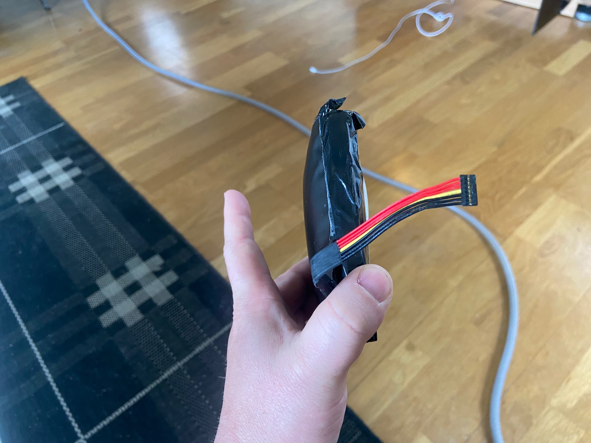

You can remove the battery and still use the projector with cable.
Now!!!
I DONT recommend anyone to do this by your own. ( if you have a warranty )
and if you are not a little bit handy.
Both you and the projector may get damaged if your not careful.
The most importantat part is to be careful when handeling the battery.
It may be more bloated/swollen then mine.
And risk of acid and so on.
Would recommend using both protective gloves and glasses. Proberbly best for full face protection.
It maby high unlikley that i would happen when its cold down. But its for your own protection.
Either way you shouldt use the projector AT ALL when the battery is bloated/swollen because of fire and explosion risk.
In my case ive bougth it from a guy and dont have any warranty or paper to it, for what i know.

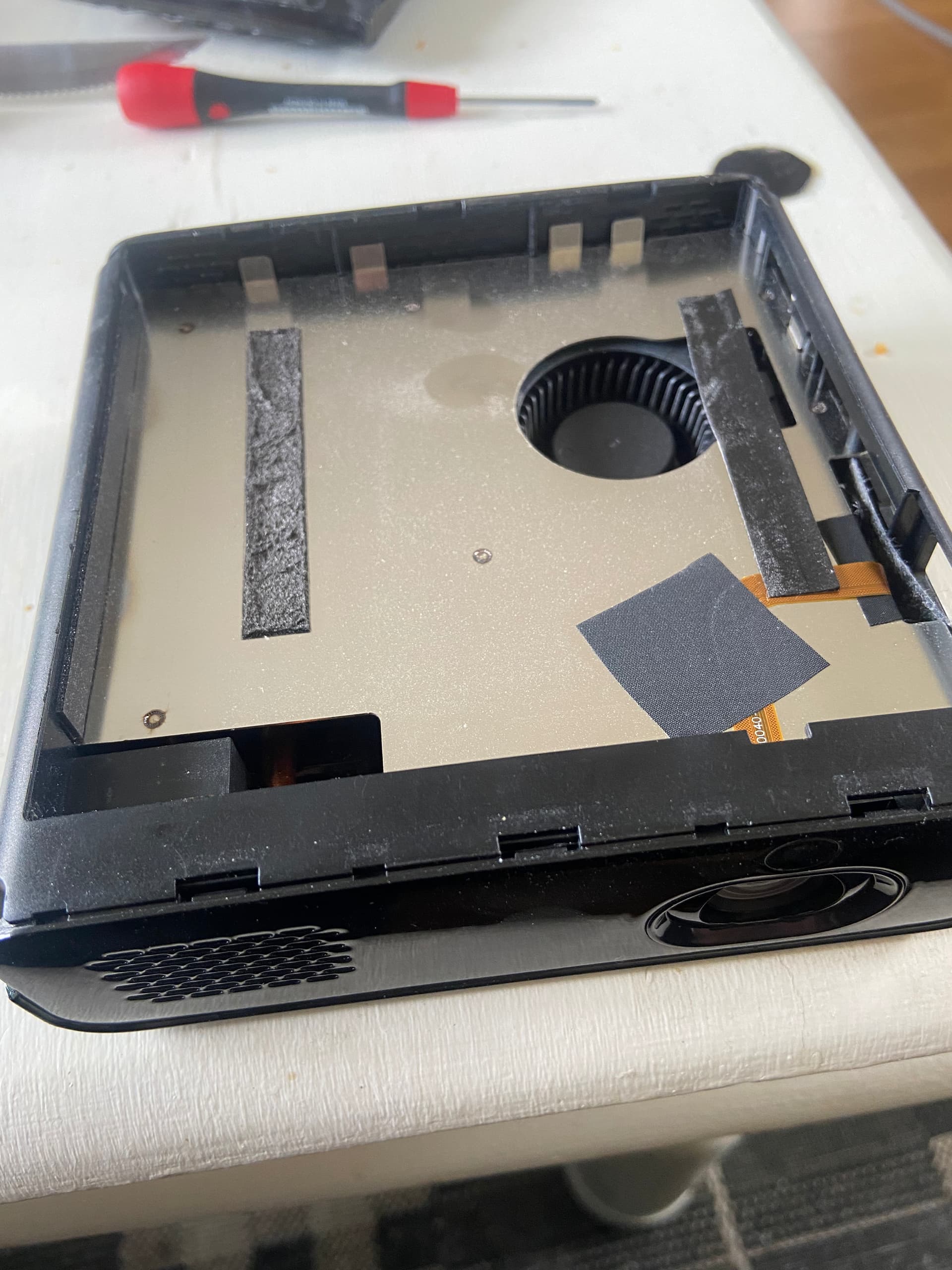

And i took a chance fixing it myself without waiting a long time for replacment or buying a new one.
And also because of the fire and maby explosion risk. I use it daily in my bedroom, and sometimes fall asleep from it so i didnt feel safe using it.

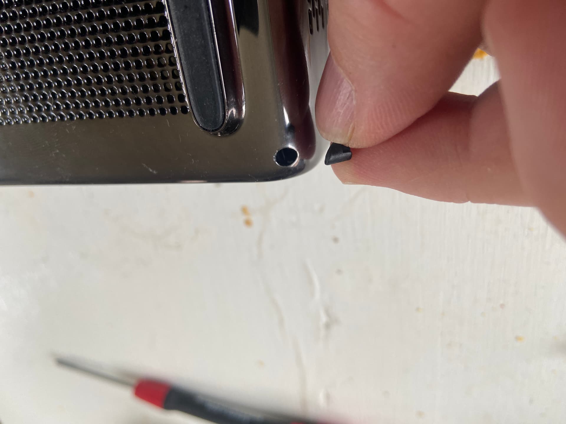

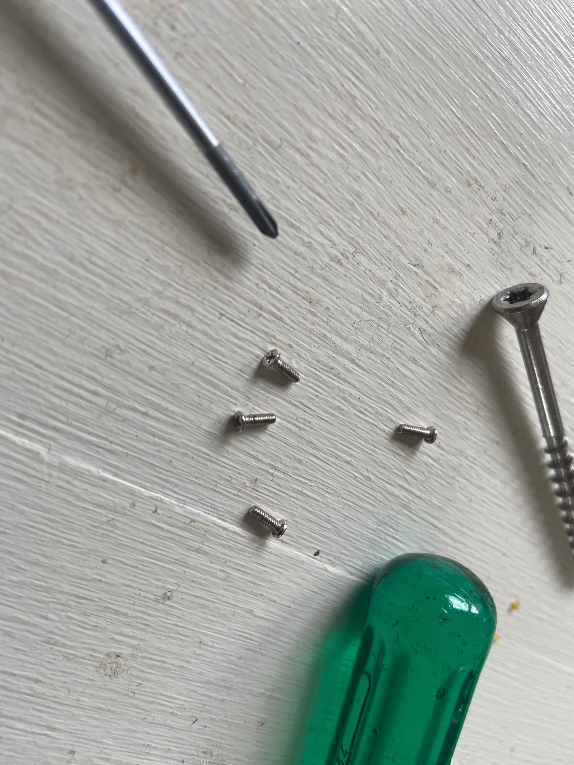

You proberbly need to buy a super mini screwdriver from a store or internet ( for like mobile phone screwdriver )
Turn the Max upside down and remove the 4 rubber plugs that covers the mini screws.
