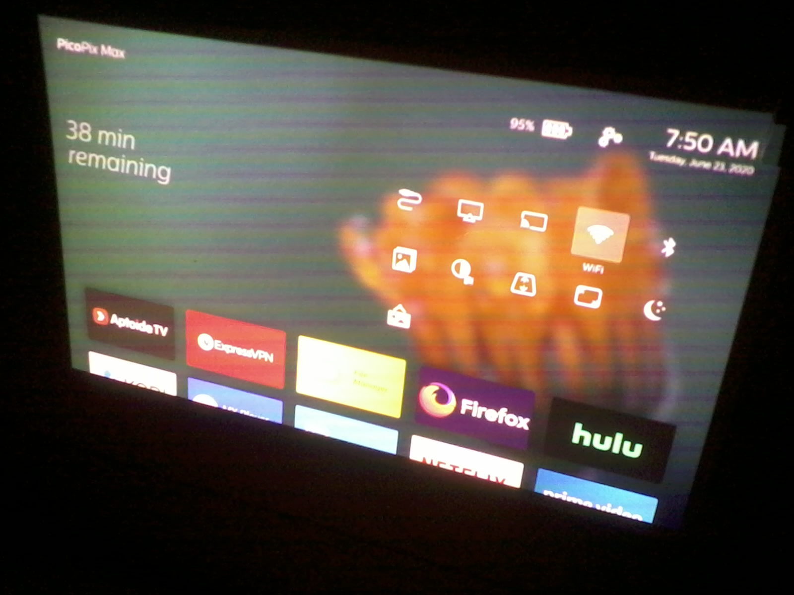

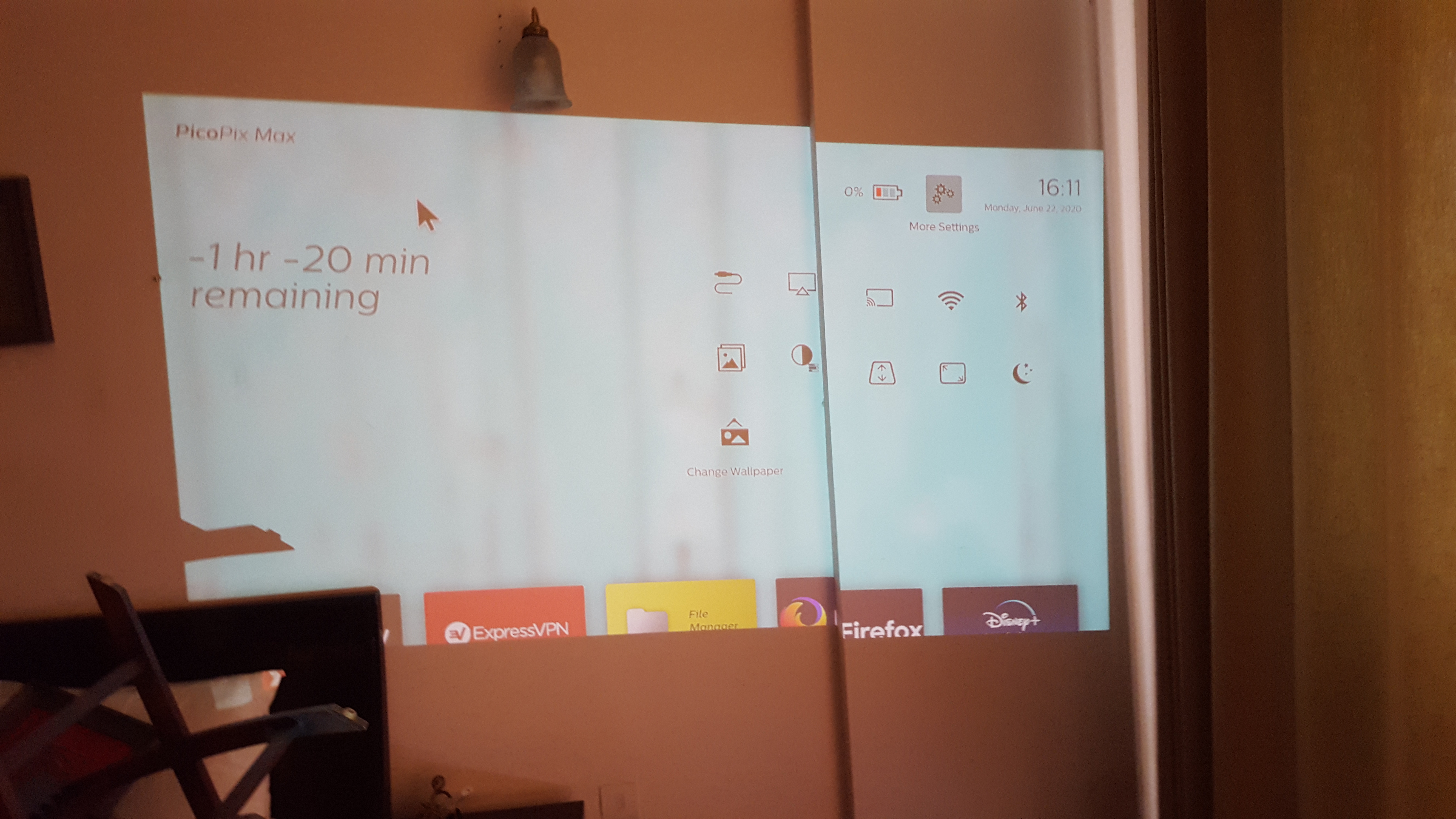

It worked for a while but this happened last night on normal mode.
Time variation kept happening

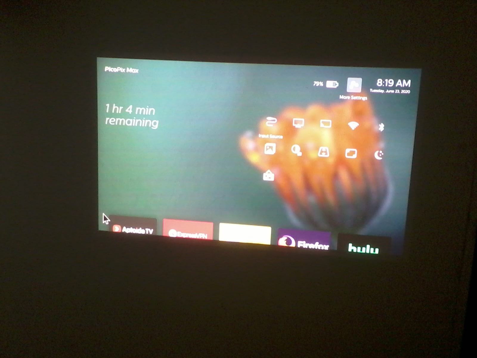

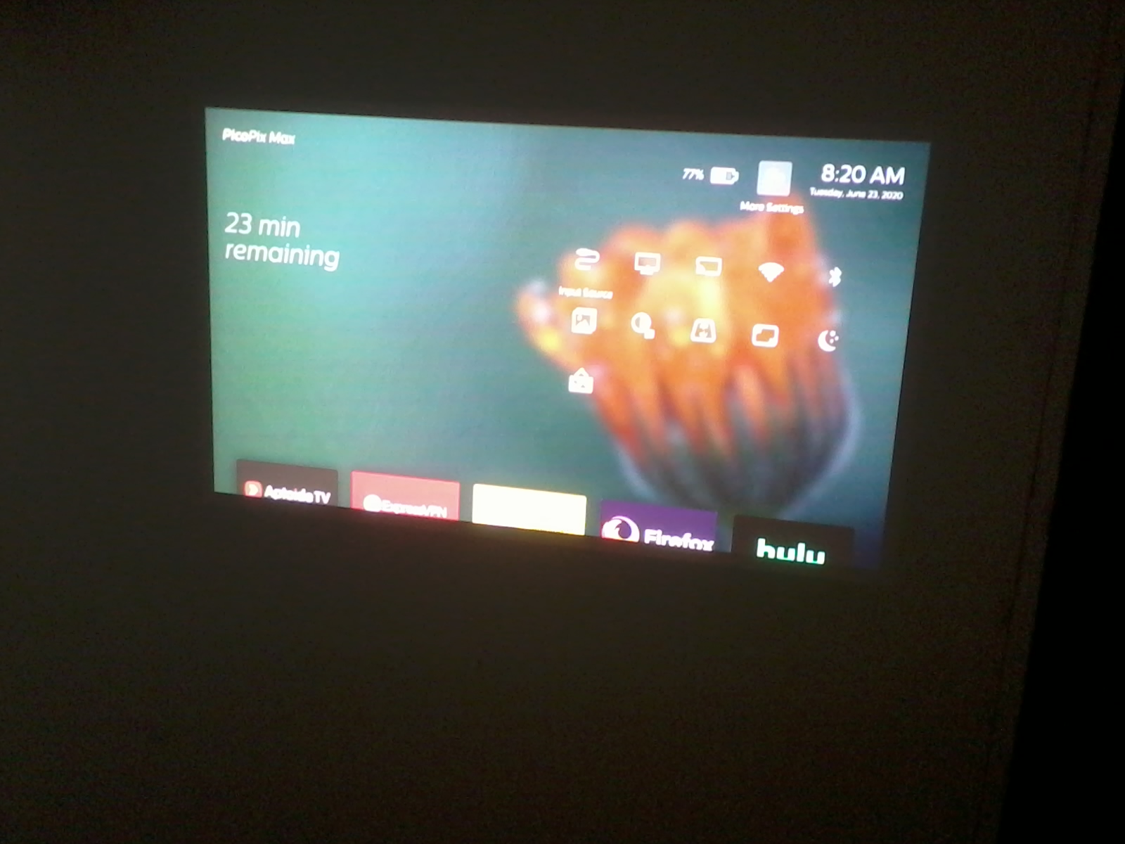

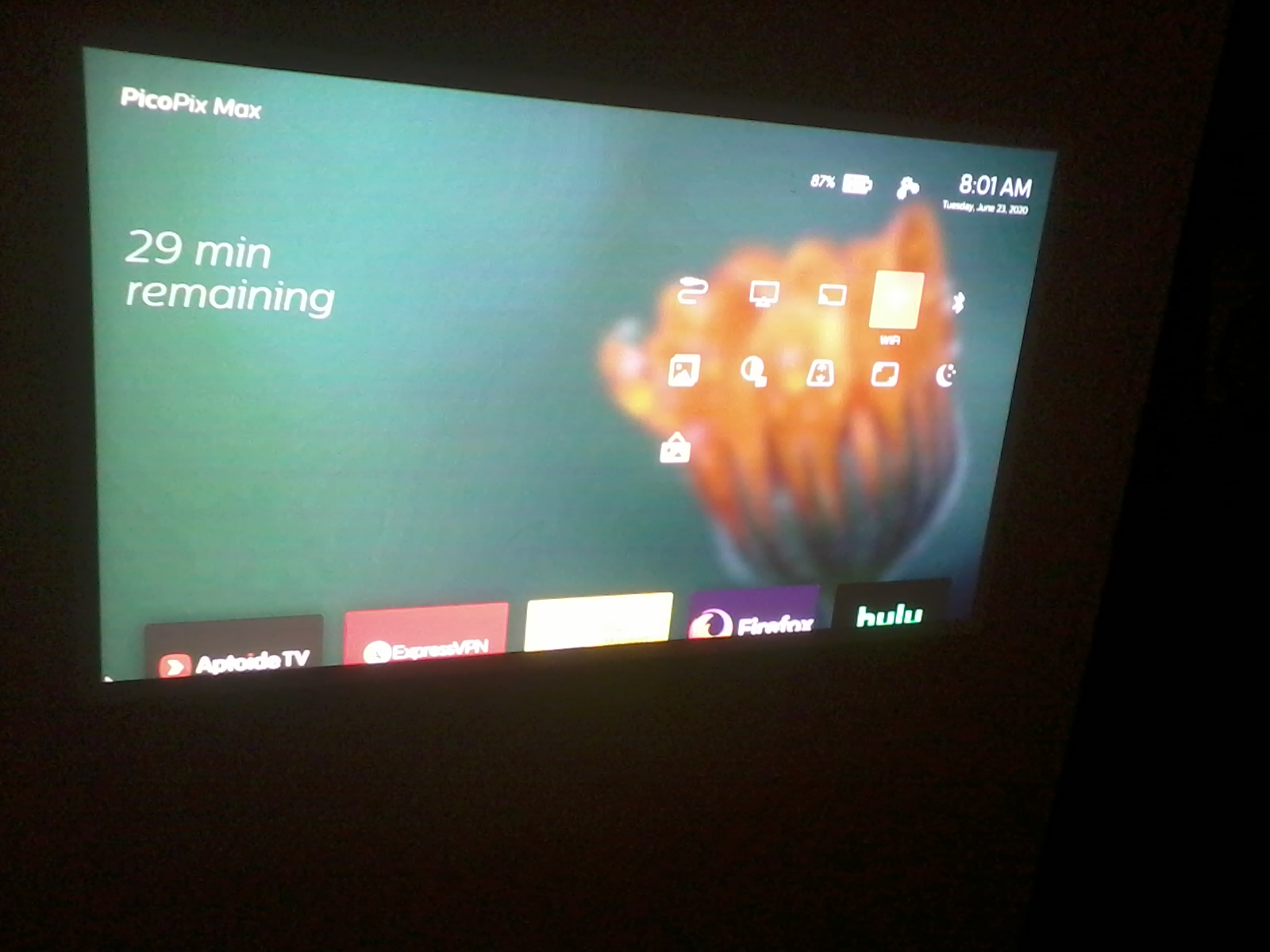

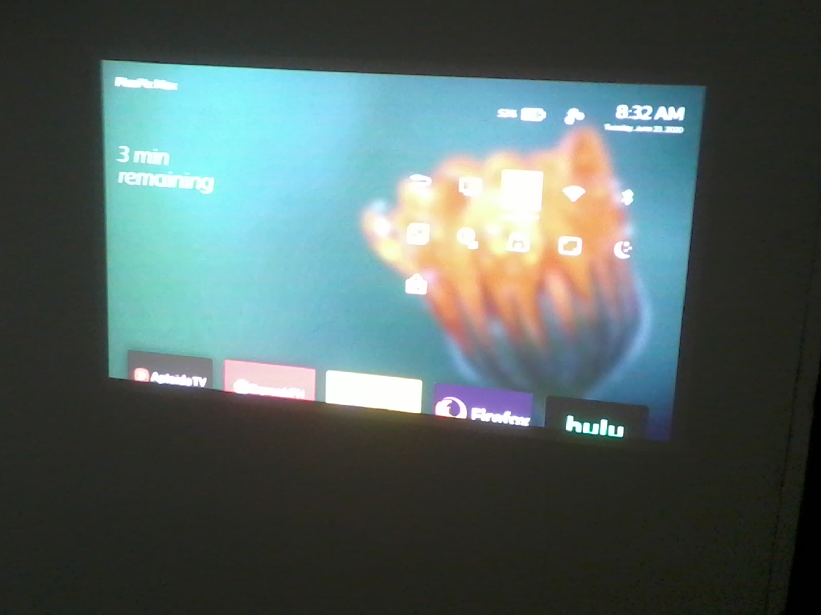

in the morning this is what happened.
I had hardly used it.

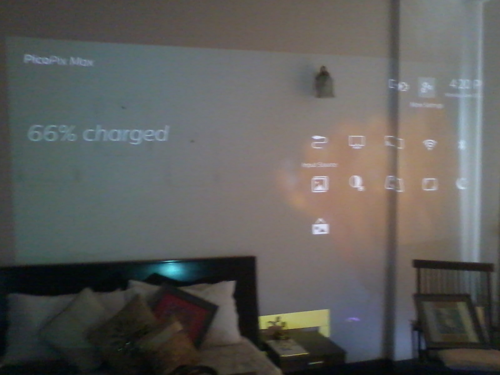

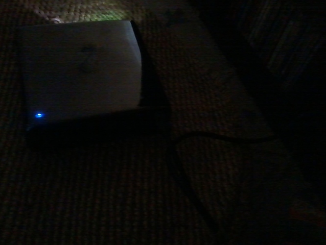

did a reset and after charge showing zero and going up to around 66%(may have happened earlier)the Charging light turned blue while should have been red
Its charging right now with blue light and I havent done an update as yet.
LIGHT BLUE WHILE SHOULD HAVE BEEN RED
POST SUPPOSED RESET TWICE

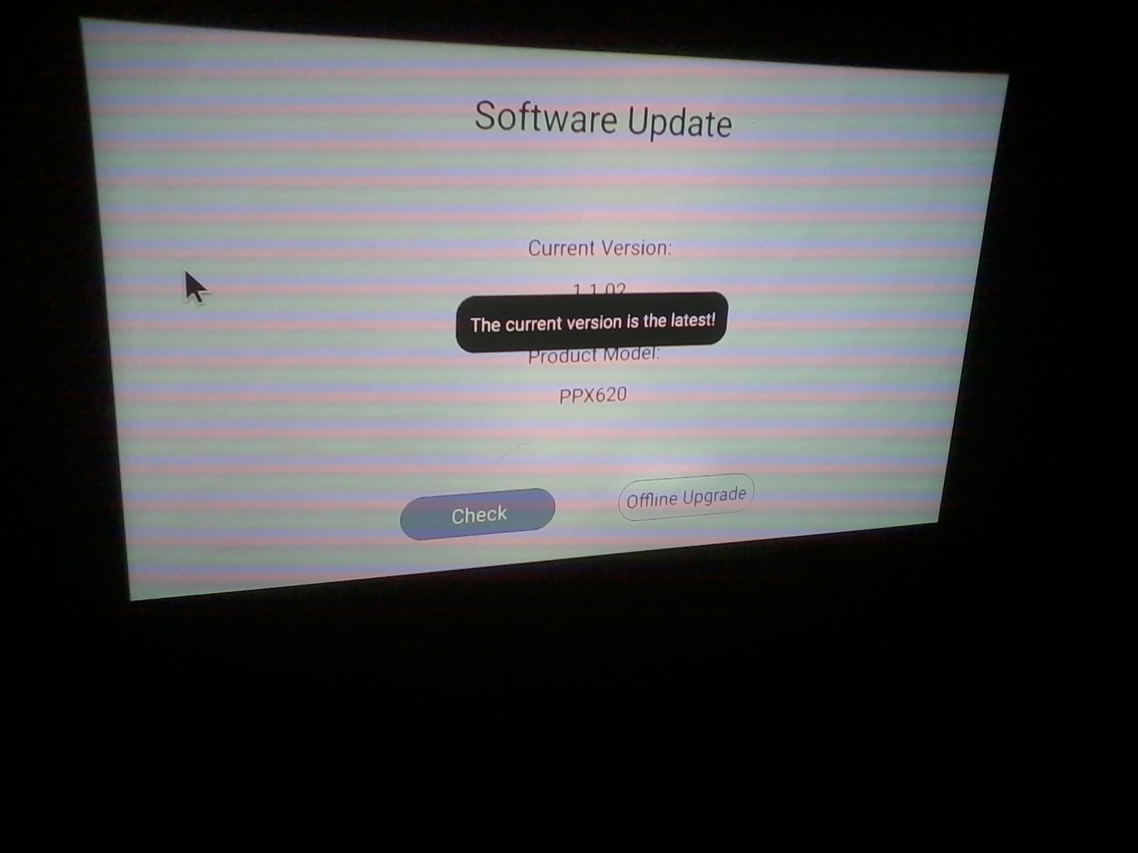

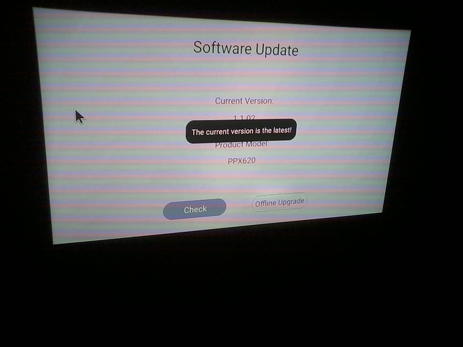

@IvoGrijt @Philips_Support_3 @Philips_Support_T @PhilipsNono hi guys …went to software upgrade section…reset twice but on desk loaded apps didnt change. wifi did need to be enabled again and so did bluetooth and airmote.
SOFTWARE REMAINED 1.102 POST RESET.AM I RESETTING CORRECTLY?
AM GOING TO SOFTWARE UPDATE PAGE AND SELECTING FACTORT RESET. BUT SHDNT IT REVERT BACK TO OLDER VERSION?

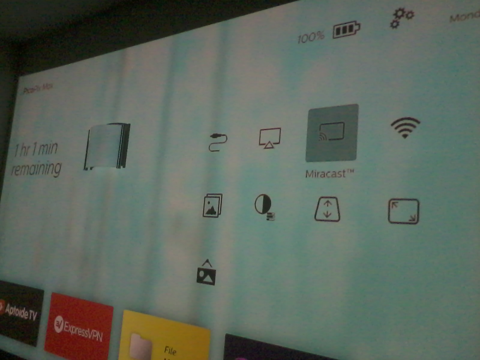

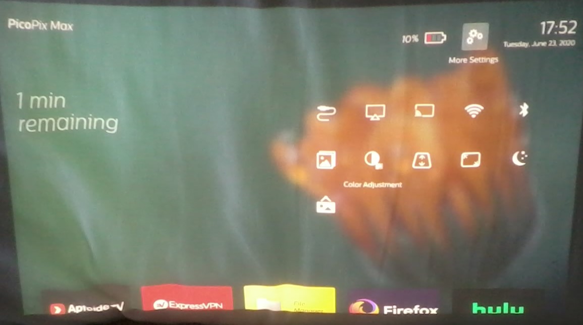

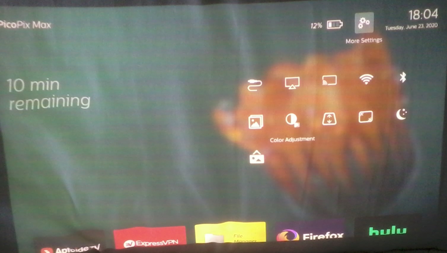

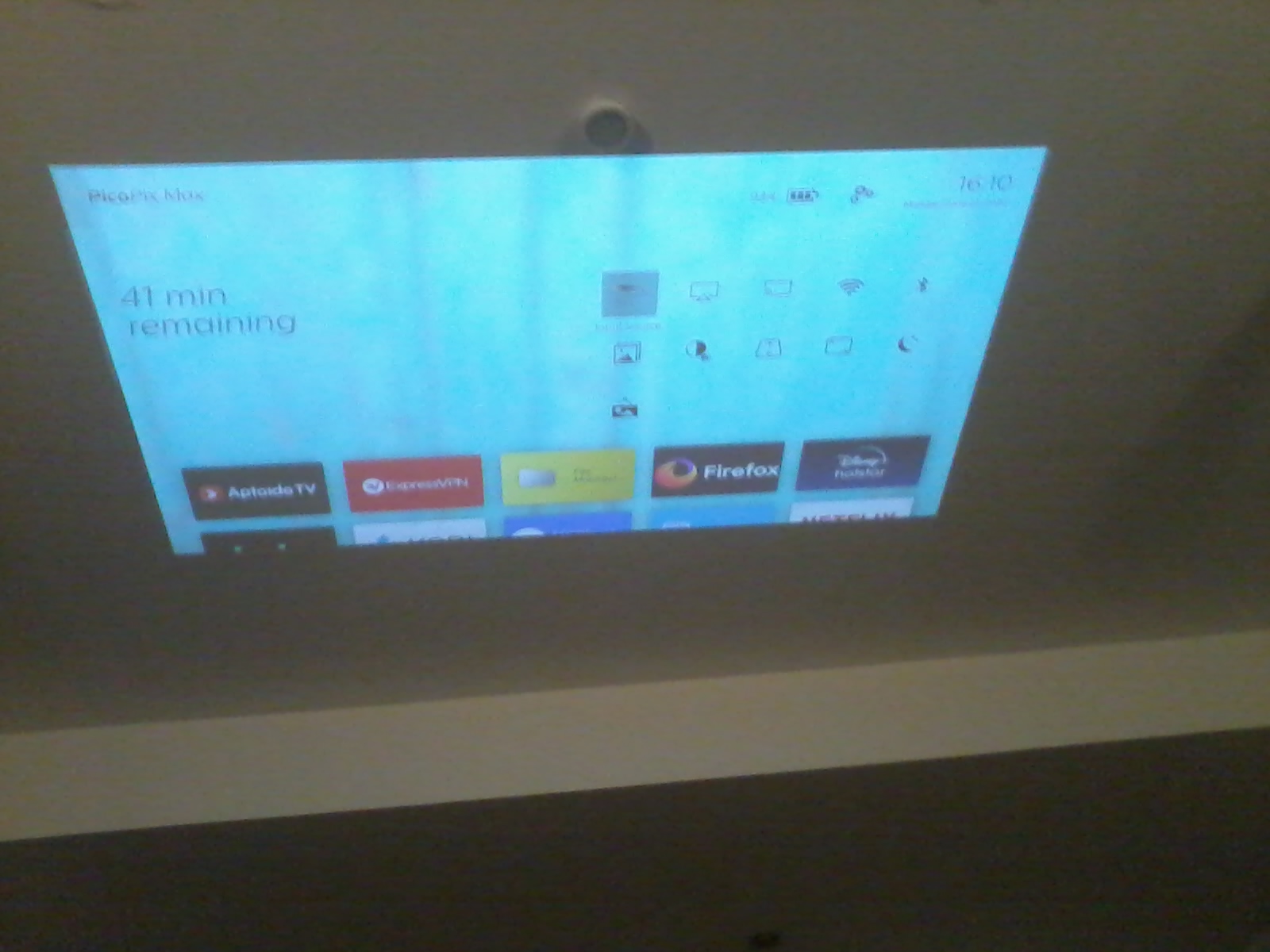

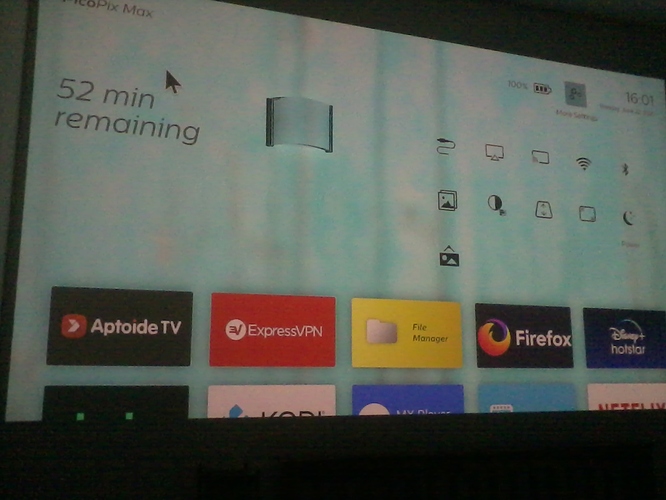

charged pico again and when it reached 100% as per screen checked and after a few minutes battery time changed a few times and started going down.
did I do the correct reset ?

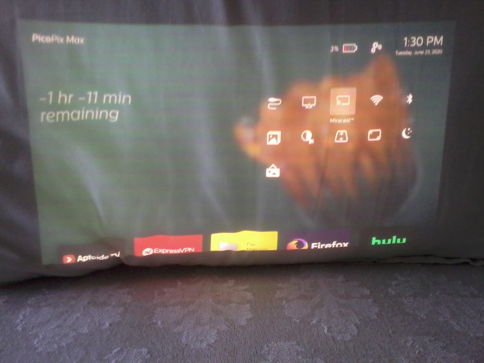

what is happening here?
pls help
depleting fast

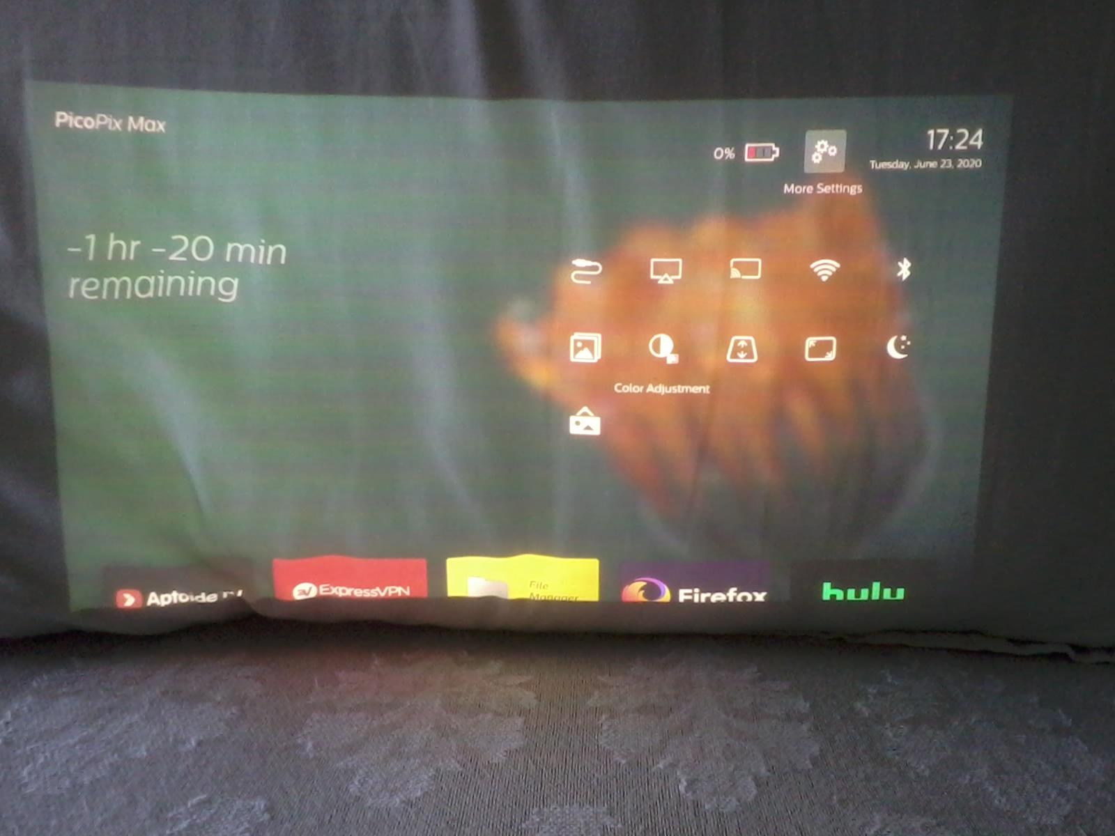

Are 111% sure it’s not on Presentation mode? Please set it to Eco mode and try the same rundown test.
to do rundown i had gone to presentation mode.
status now…its energy saver now.Should i do caliberation again? By the way its zero now and still on
First let it die off, then charge it fully, with the device off. Afterwards you can test again.

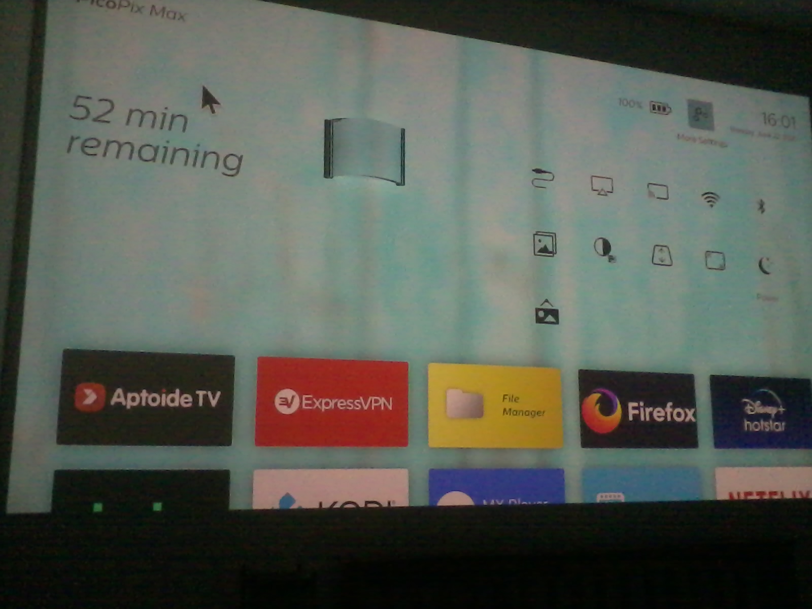

Sorry have to show you this.Its started increasing on its own.whats happening?
