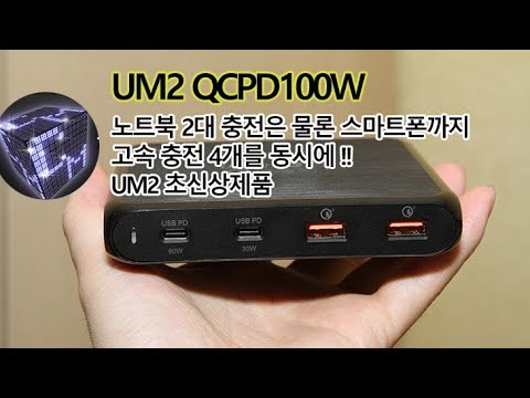

[Update June 28, 2020]
I purchased a USB-PD 100W charger to see if the original charger is causing the issue.
However, the red/blue LED siren flashing symptom is still present and is identical to the issue I’m experiencing when using the original charger provided by Philips.
Here’s the spec of the new charger I purchased.
USB-C PD output: 60W Max (5V/3A, 9V/3A, 12V/3A, 15V/3A, 20V/3A)
Here’s a YouTube video of someone else who reviewed the charger I purchased. (Language is in Korean tho.)
The charger has a 60W USB-C, a 30W USB-C, and two USB-A ports and I ran my test on the USC-C 60W port.
Next, I’ll test using a different cable which I haven’t received yet, but at this point, I doubt the issue (in my case) is related to the charger or cable, but with the PPM itself. I’ll have more updates once I receive my new cable.
[Update July 2, 2020]
Purchased a 2 meter USB-PD 100W (USB 3.0) cable.
It will charge the PPM and my Galaxy S10 5G phone, but the red/blue siren flashing issue persists.
So, I’m concluding the red/blue flashing issue in my case is not related to the charger nor the cable, but the PPM itself. ![]()
I received a return ticket ID through support@screeneo.com but plan on running a cable test, and see what the Engineers have to say about this issue before sending in my PPM for replacement.
