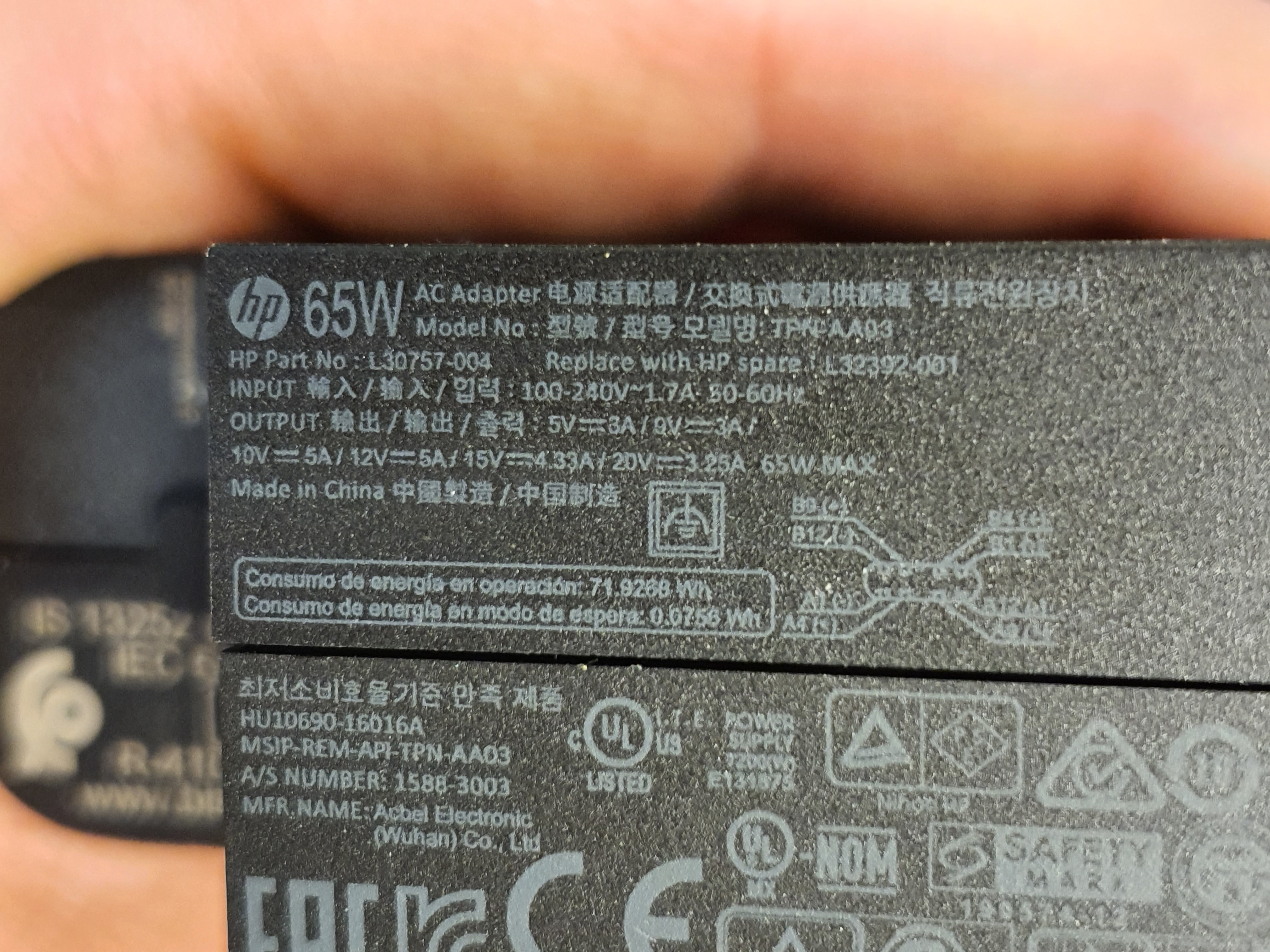

What are the specs of the new charger?
And unfortunately the policy is that we need to get yours back first, else anyone could abuse the option to have it replaced.
My charger spec is 15V 4.33A
