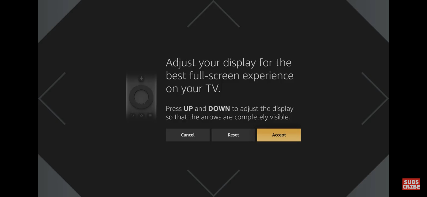

All the time I thought the missing Digital Zoom (Shrinking) will be a showstopper for me an my bought FireTV Stick.
But today after unboxing and setup my PPM I reminded me myself about THAT FireTV Feature:
Problem solved :partying_face:

Most firesticks had that settings disabled years ago. It now only shows a screen suggesting that you set the overscan on the display device.
Yeah, mine only says to do it on your TV, not on the firestick itself
