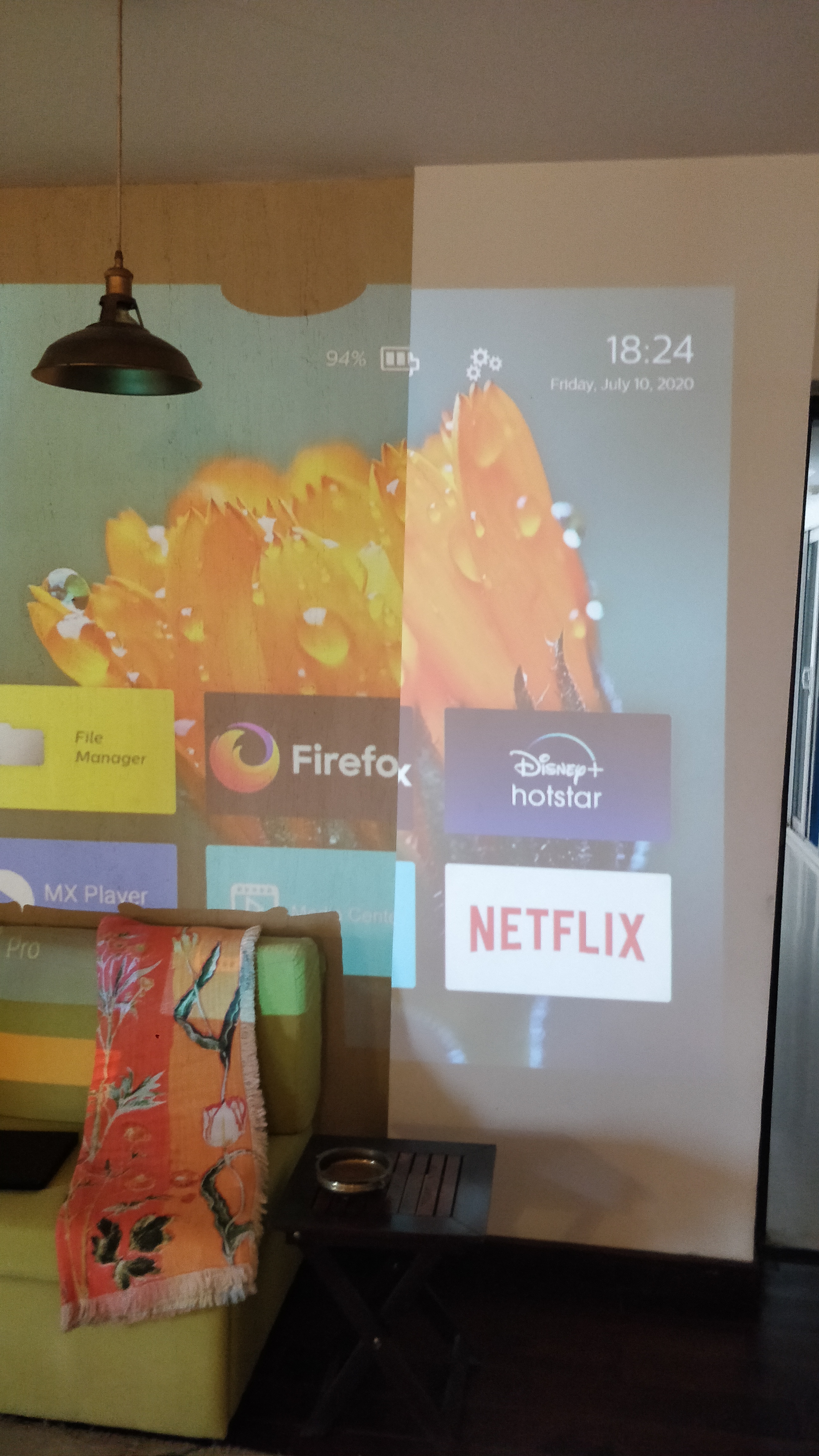

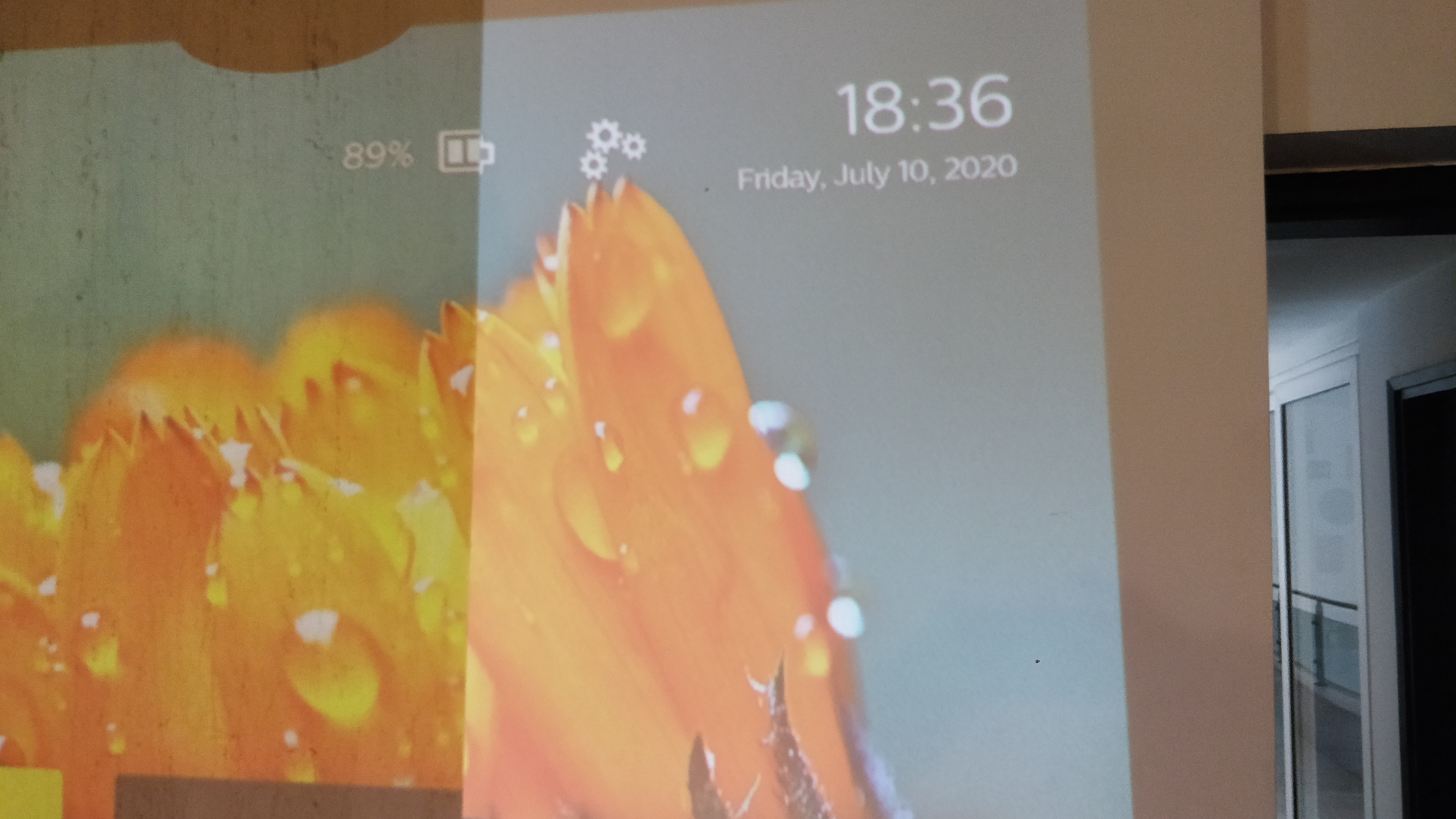

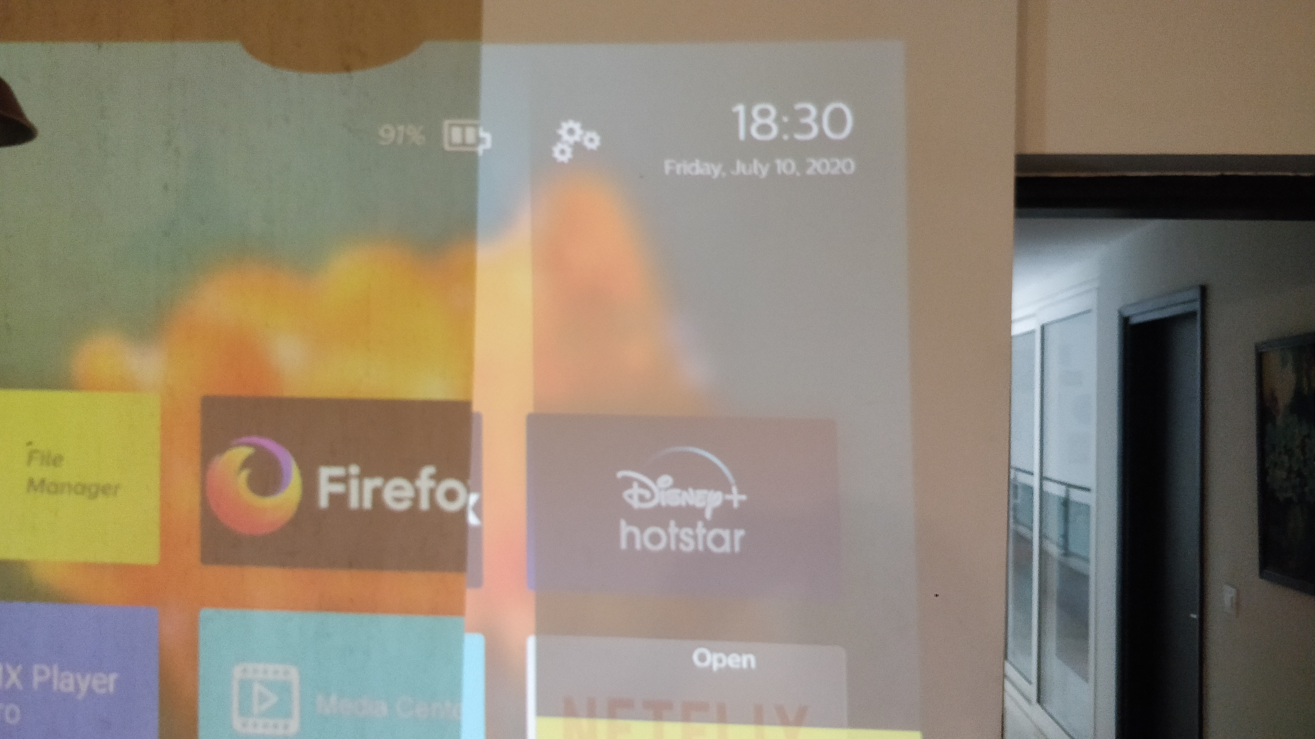

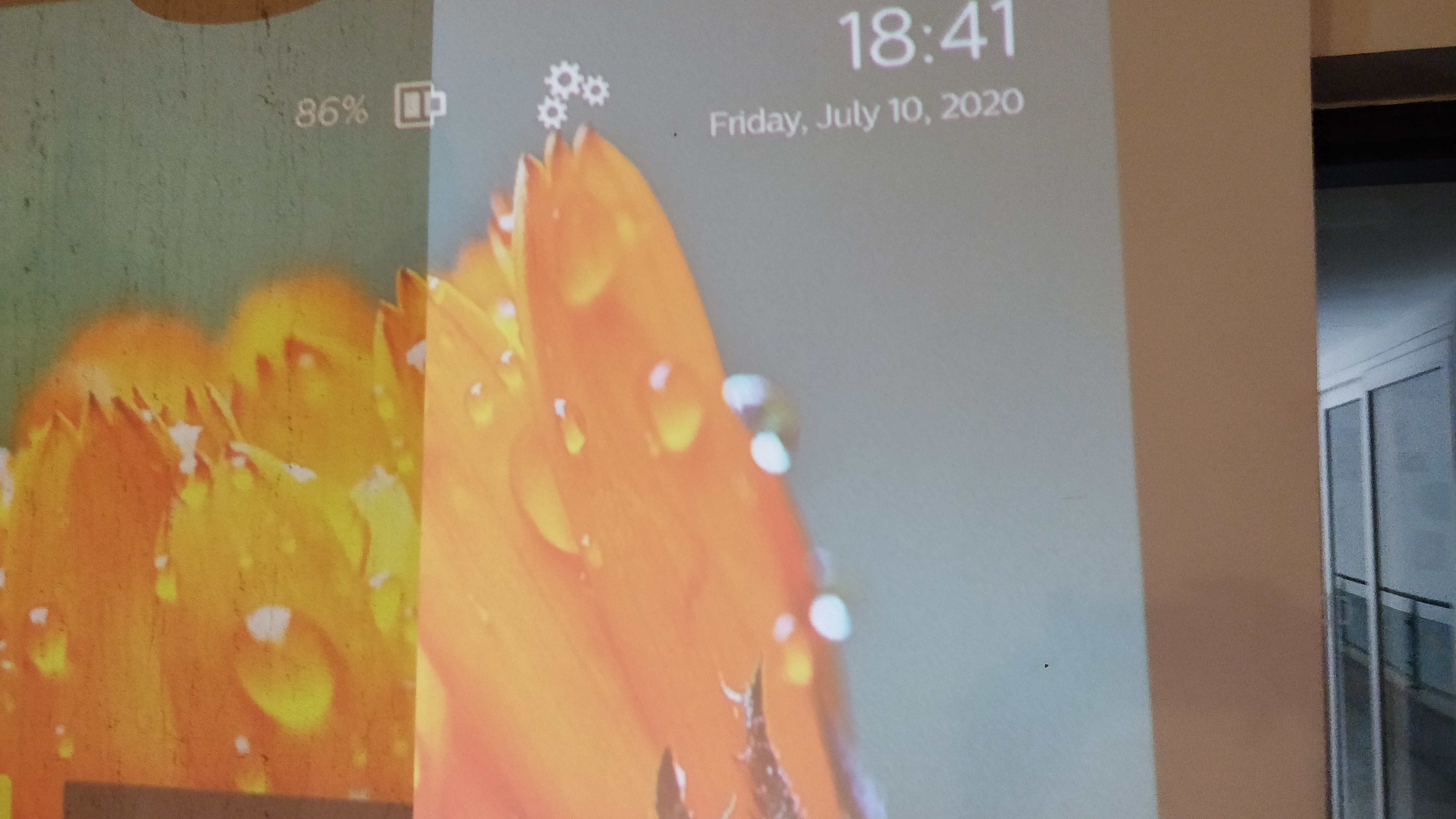

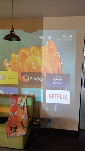

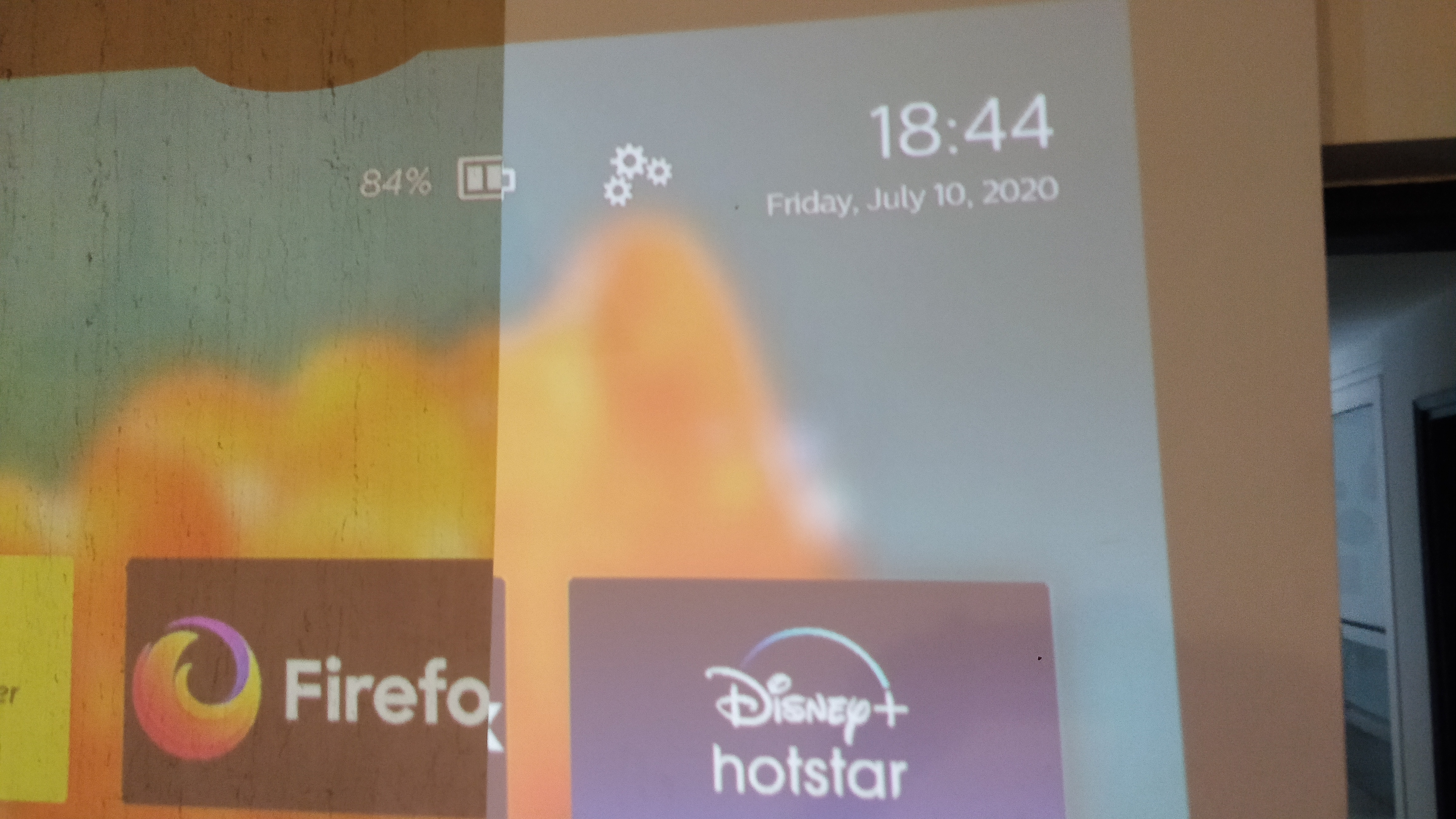

@IvoGrijt @Philips_Support_P hi âŚcant charge beyond 98% now. is that ok?
also battery drains fast .Here I started with 98%(not in picture) and see the progress.
also if i switch off and check the next day its down again despite being off.
pls advise.
engineering had downloaded the battery doctorâŚCouldnt find in aptoide. Did it help?
Does the charging light turn blue?
When Iâm charging it turn blue at around 93% and I charge for anthr 45- 1hour after that but max it goes upto 98%.
Yesterday on normal mode reached 83-23% in 90 minutes.will recheck again todayâŚ
