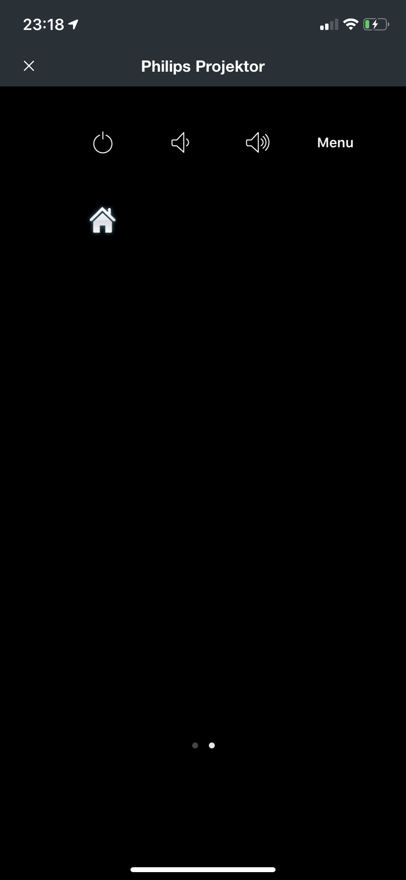

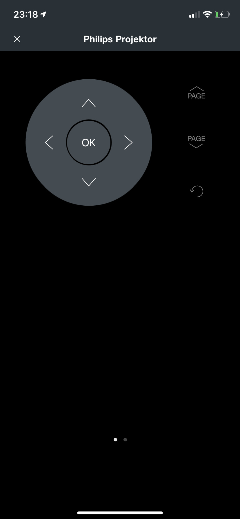

Hey @Philips_Support_N, feedback time: integration works well on my Harmony Hub. The mapping it gave me is missing the focus button (already mentioned) and the back button. Impossible to navigate without the latter. Power on works, power off doesn’t so far, but I’m not done playing with that. Could just be a question of finding the right setting.
One request/suggestion: currently, Harmony seems to be communicating via IR. That’s necessary for the power switch, but everything else is bogged down by the delay (and potentially the directionality of IR). Navigating the PPM with it feels like walking through mud. Would it be possible to integrate a pairing as a Harmony keyboard (BT)? Other smart devices do this (AppleTV, ShieldTV, the PS4) and it works brilliantly. Exposes all keyboard commands to Harmony, and is snappy and independent of line of sight.

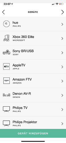

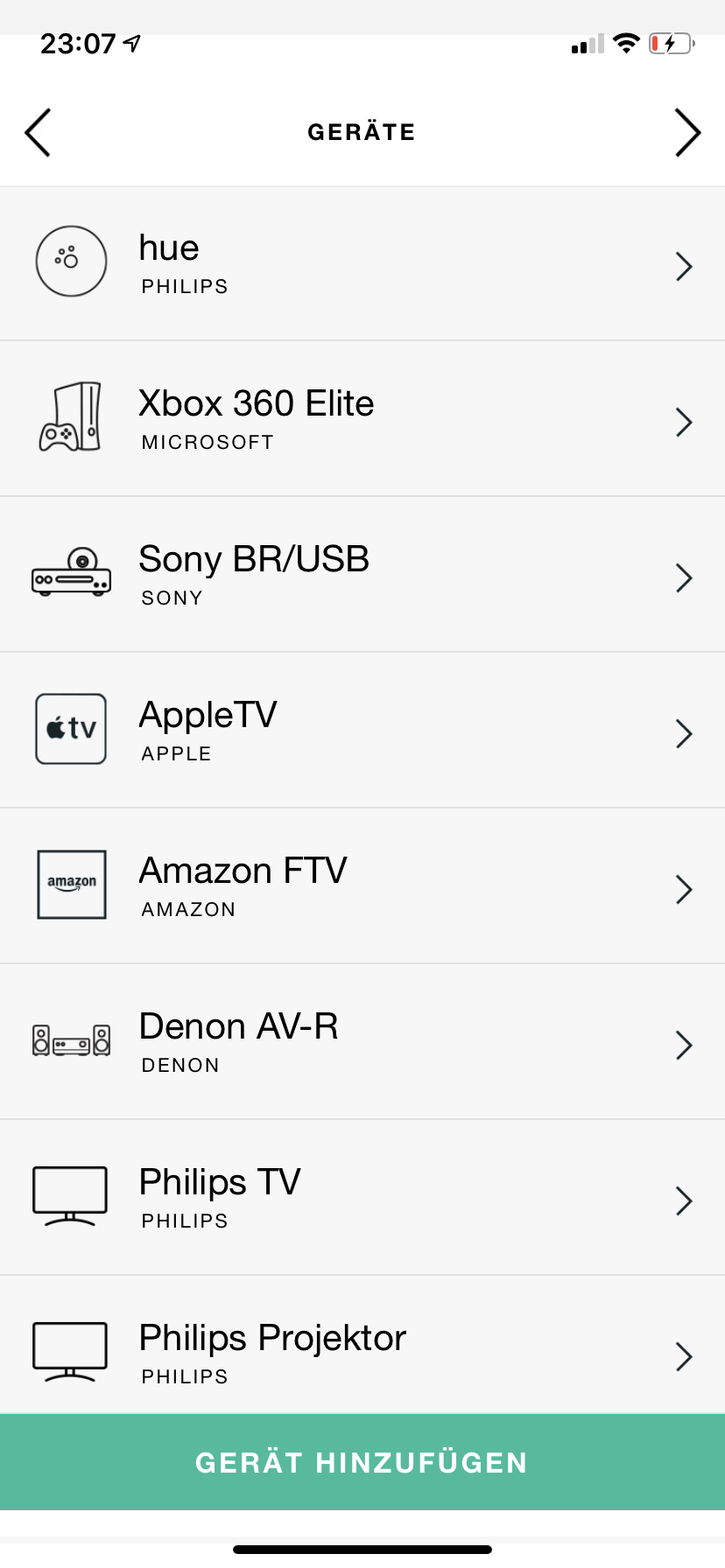

Very excited to add Philips Picopix Max to my Harmony Hub and sucessfully Power On!
Sadly, it doesn’t seem to be able to Power Off.
Can someone advise me if I need to change delay settings to make it work

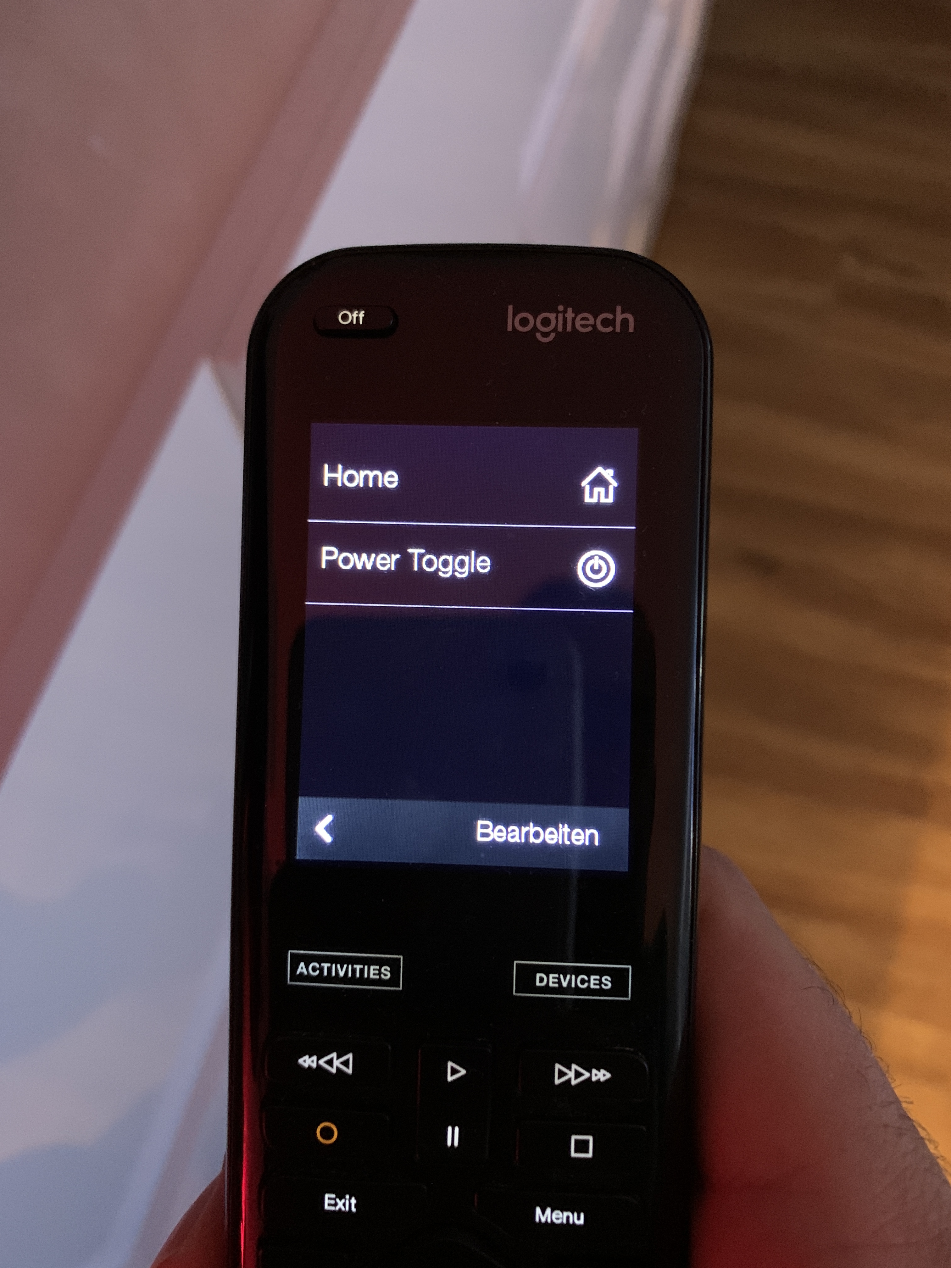

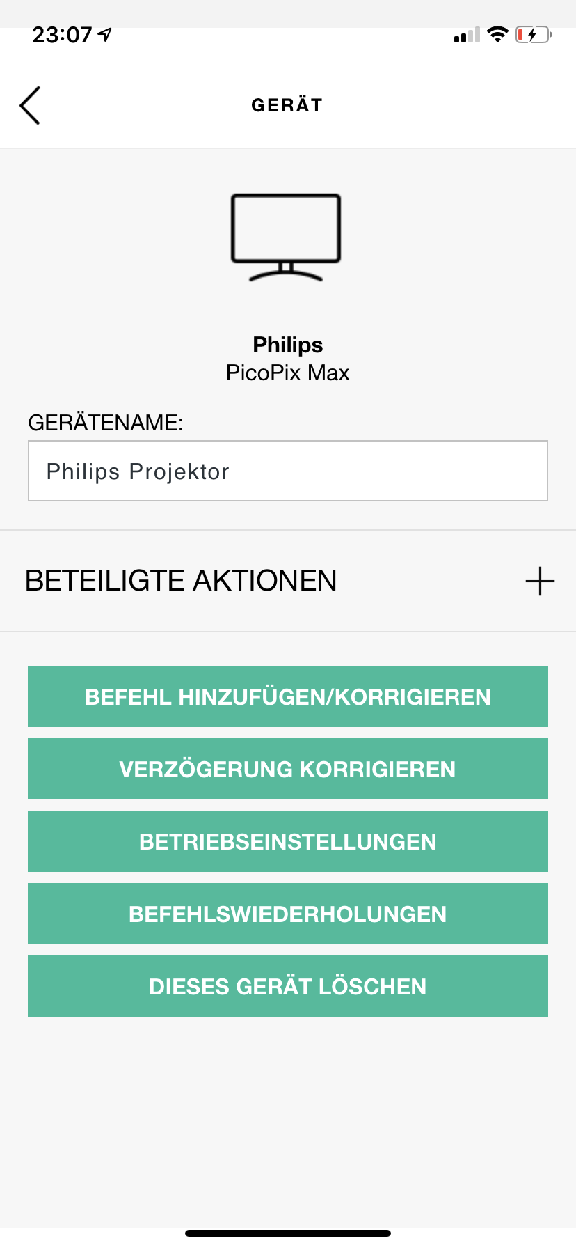

OK, think I’ve fixed the Power Off issue. Try this in the Harmony App…
Devices > Edit Devices > Philips Projector > Power Settings > Turn off when not in use > Using single button > Add a step > Power Toggle > Duration 2s - done
