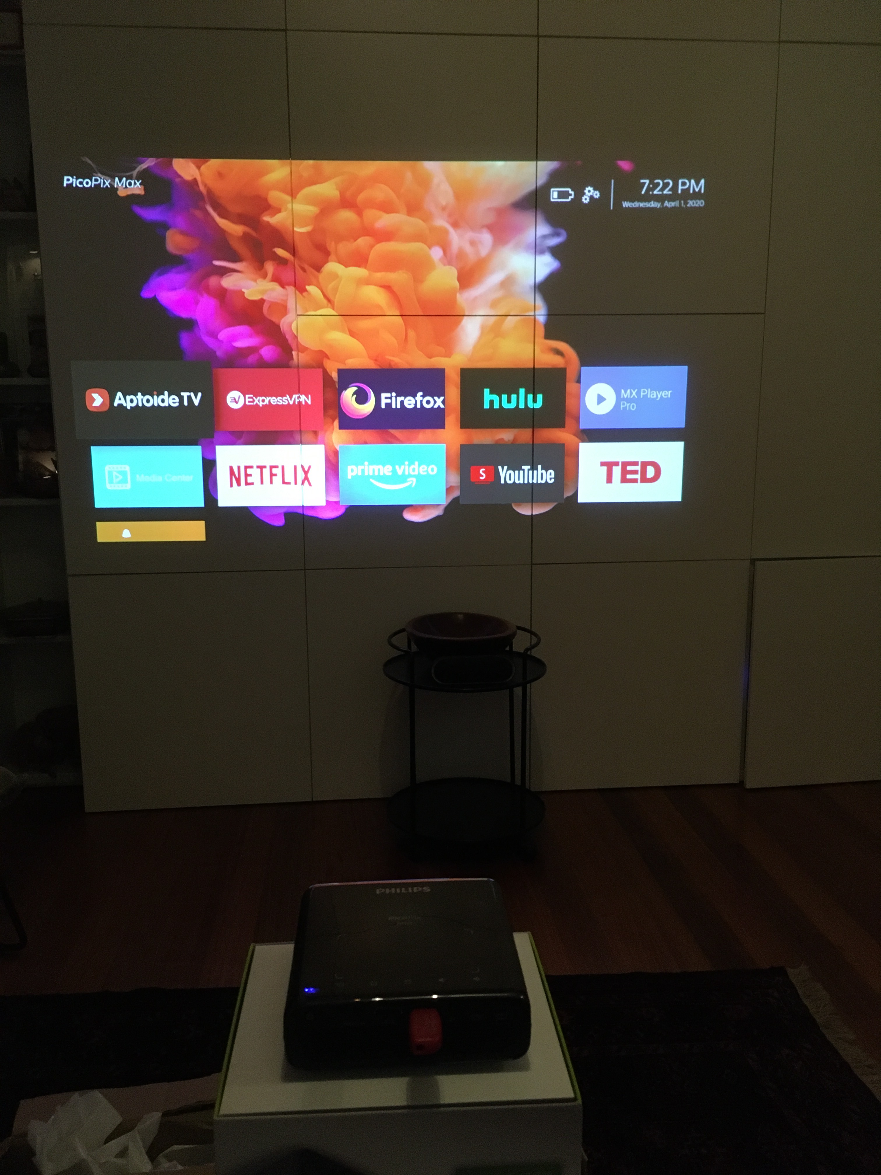

It is normal to have the “grid” when you look at it very close. The “grid” is the individual pixels that make up the 1920x1080 resolution. If you look closely at the screen of LED TVs or monitors, you will also see the “grid”.

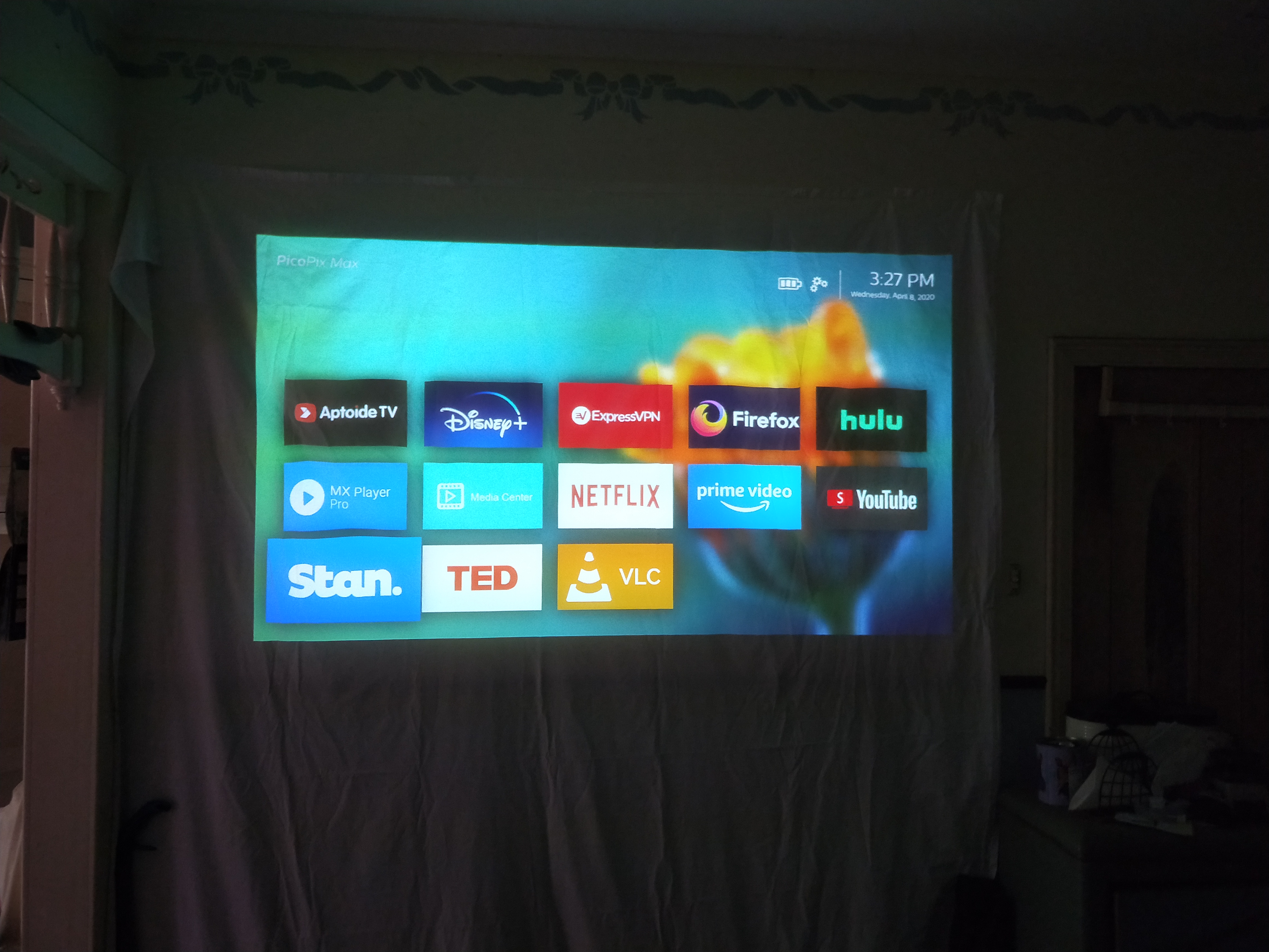

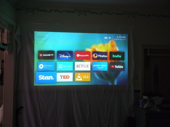

Which screen is that?
Works for me - updated to v27 and connected a Sony BT speaker. Playing Netflix - sound through the BT speaker
160x90cmIt didn’t work for me after two attempts, with all the other bugs I just threw it in that basket. But to be fair, I haven’t tried it again.

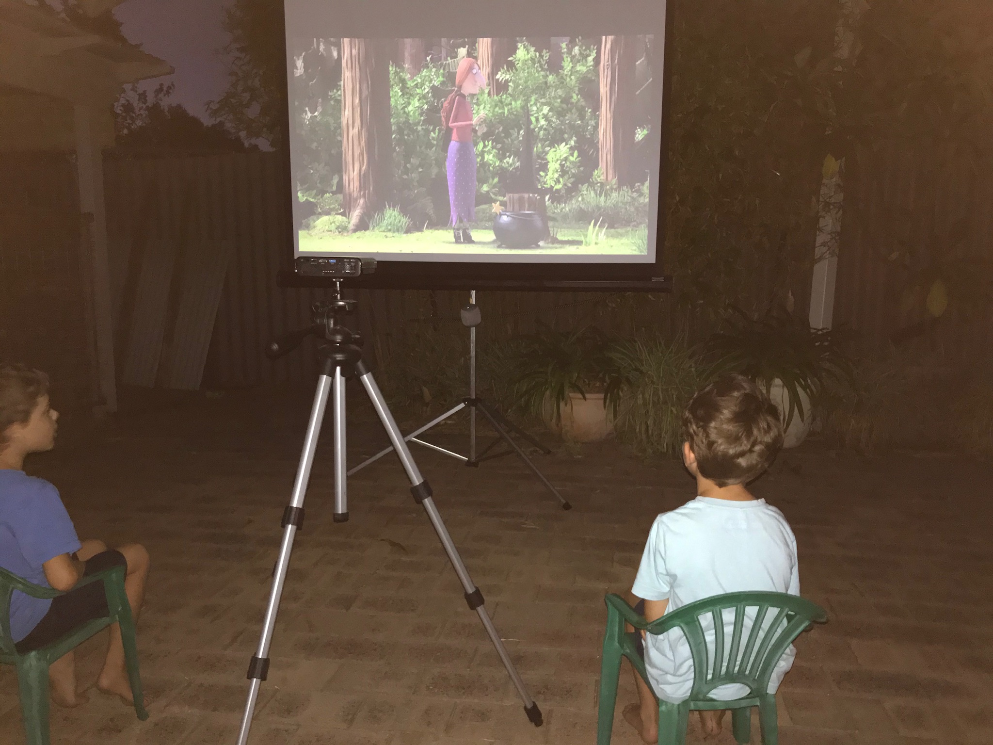

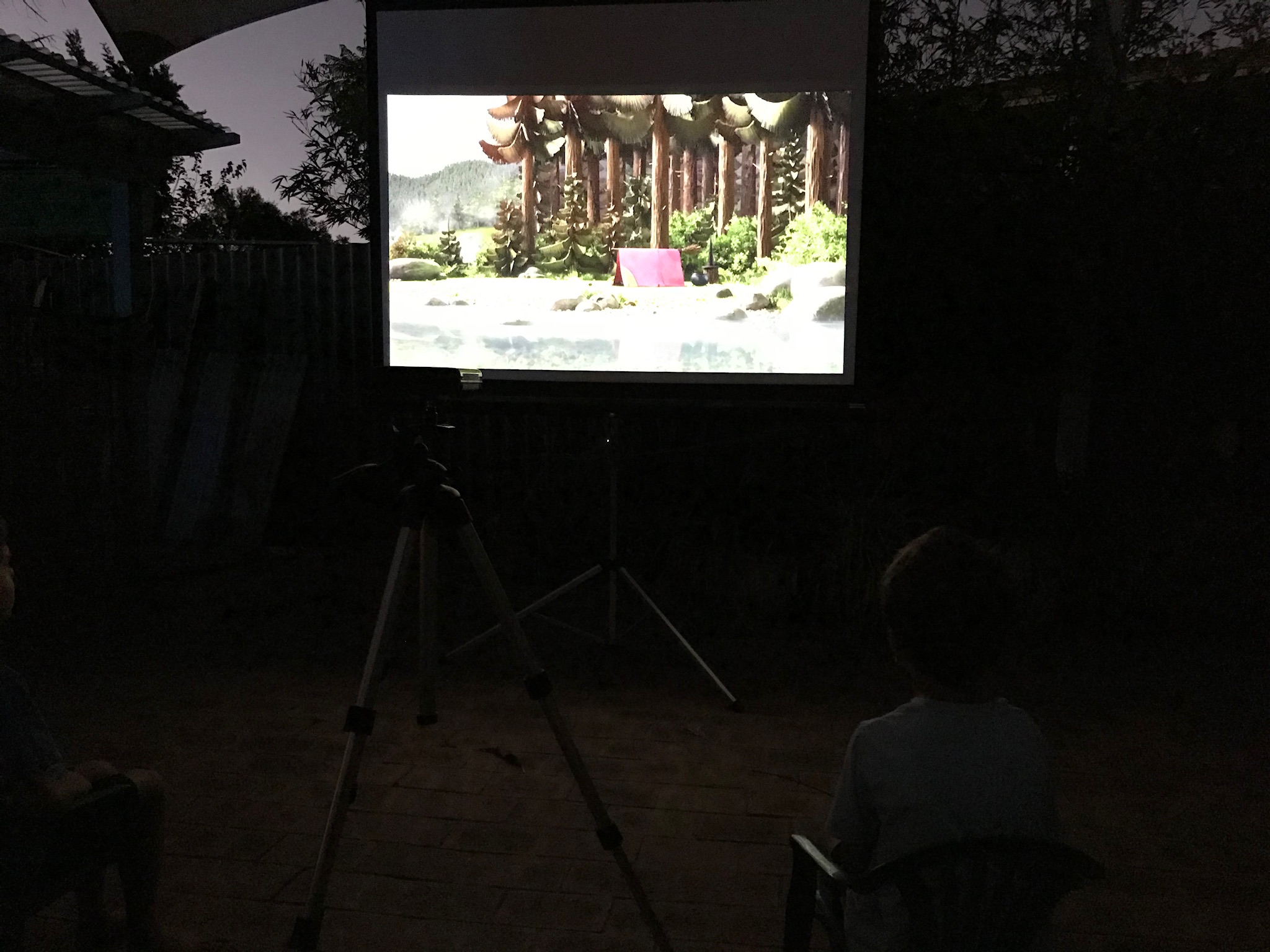

PPM arrived yesterday. Movie night tonight with my boys.
I think there’s a slight delay in the sound to my Bluetooth speaker, but hard to tell with the simple animation of “Room on the broom”

@Injidup, yeah there is a little audio lag problem when paired with some Bluetooth speakers.
Some suggested using only 5GHz band for the Wi-Fi because the 2.4Ghz Wi-Fi can interfere with Bluetooth.
Another interim solution I am using is to dislodge one battery from the AirMote. The audio will sync up soon after that. If I need to pause the movie or whatever, I will put back the battery for that task.
So yeah, the battery cover of my AirMote is permanently opened.
Hope this works for you.
Good tips, thanks.
I have another speaker I can connect by cable, I’ll try that (and the remote trick). I think I have 5GHz WiFi selected.
At times, it may be the movie file itself. Because most of the movies played just nicely with my Bluetooth speaker but some movies audio lags behind.
If it’s an internal app playing the file, you can use the feature in the app to adjust the audio delay to match the video. Like in VLC video player.

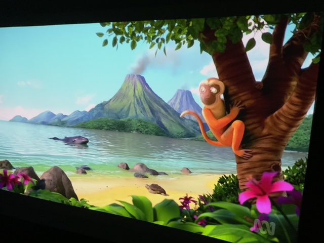

Watching Zog on ABC iView was fine, Audio was in sync over Bluetooth.

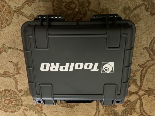

I got a case for my PicoPix today from a super cheap
car parts store. Fits all the bits in quite neatly, in two layers. This is the small safe case. $32.95
Bottom layer: tripod, charger and cable.
Top layer: PicoPix and remote
Unfortunately there isn’t room for the big tripod, Bluetooth speaker and screen
