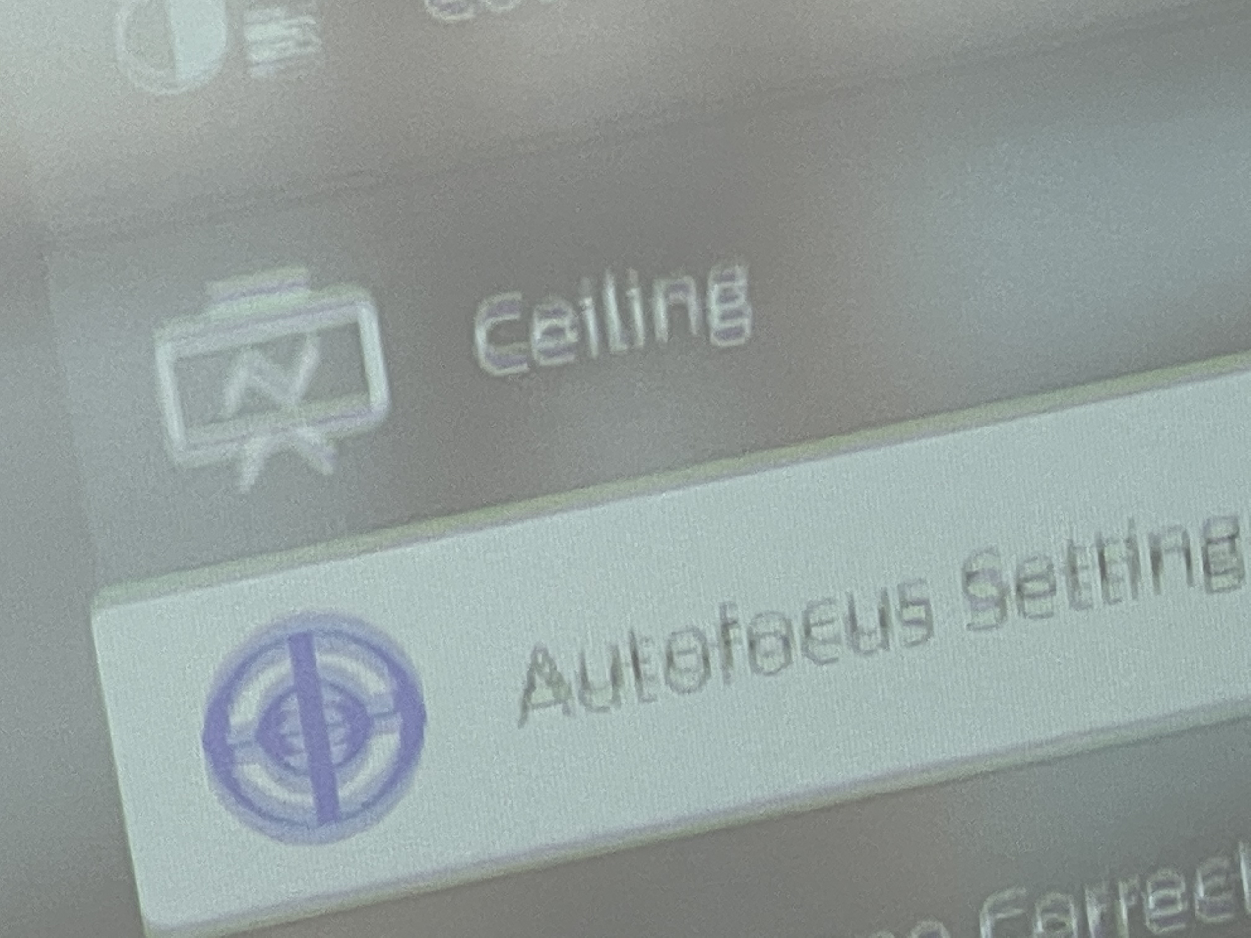

The problem still⦠You can see in the letters of this pictures (Zoom in)
Please, do you have any idea or you have to replace the projector⦠

@toniface could you please try to do a factory reset also, after updating? It seems to be a different issue than what the others are experiencing in this thread. From the picture it looks like the actuator which transforms the DLP from 540p to 1080p is malfunctioning.

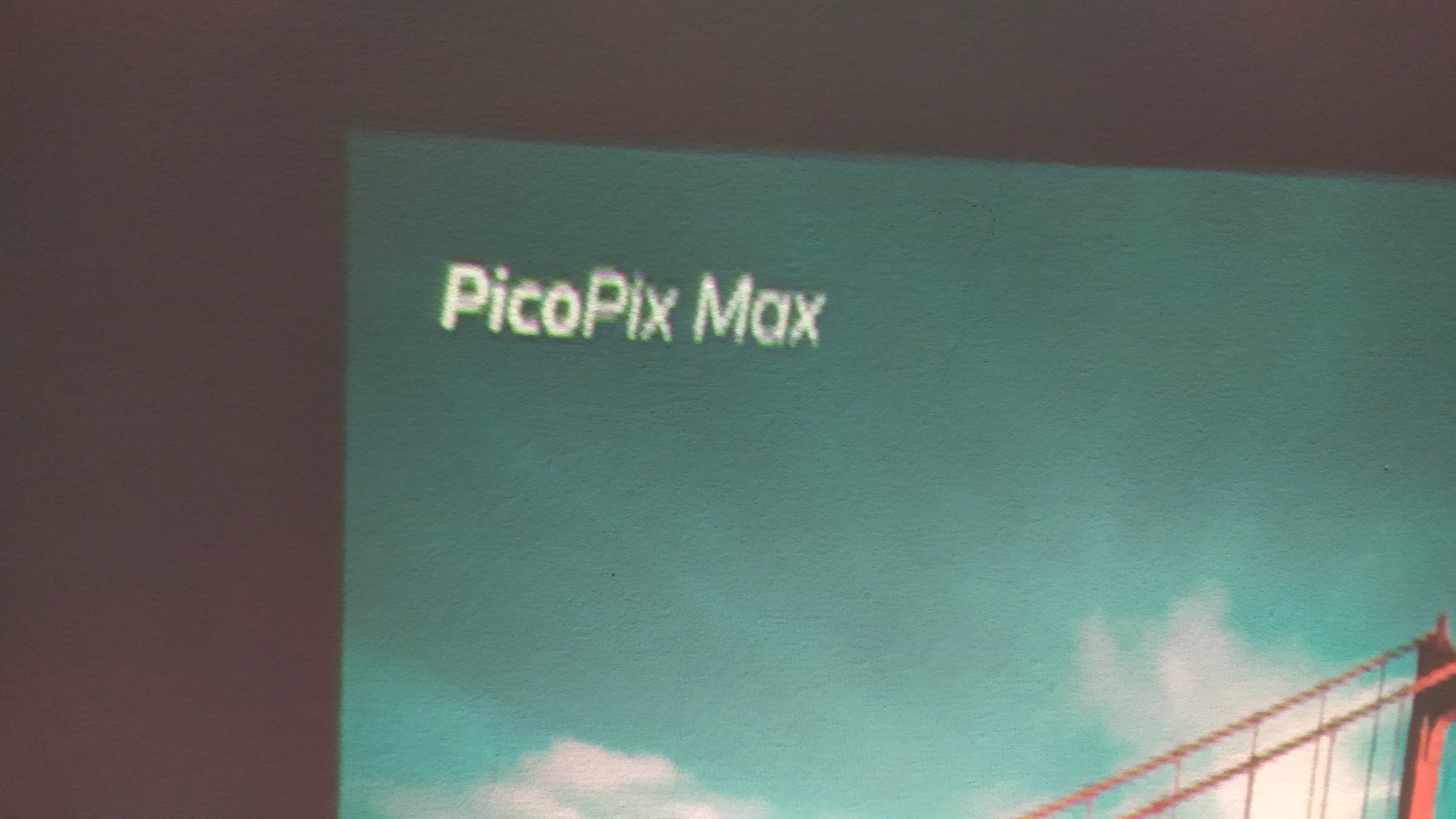

Same problem here!
Image gets blurry and kind of doubleā¦
Just thought the projector was dying for me. Did appear after watching Ć Netflix movieā¦
Then when I did turn off auto keystone, picture got back ok again for a whileā¦
Now itās back again! Didnāt do a Factory reset, byt guess That will be the next stepā¦
(However I think I did a factory reset after last update and this problem appeared after some movie watching, USB power connected to the projector.)
Ok reset had it working for 5 minuters, then the behaviour returns!
Removed the poweradapter and then it returned to normal directlyā¦
Did insert the poweradapter again and image is still normal! But I expect it to fail againā¦
(Didn“t experience this before the update)
So is charging now causing this issue, while using it?

The other day my projector had the doubled image problem suddently, but when I did restart this wasa fixed. But my problem as you said is not exactly the doubled image (You can see in pictures I sent to you). Now Iāve experienced the issue of double image and my problem is other.
You said different issue than what the others are experiencing in this thread. From the picture it looks like the actuator which transforms the DLP from 540p to 1080p is malfunctioning.
So, please, we need an answer about my proble. How can I get a replacement of tghe projector?
