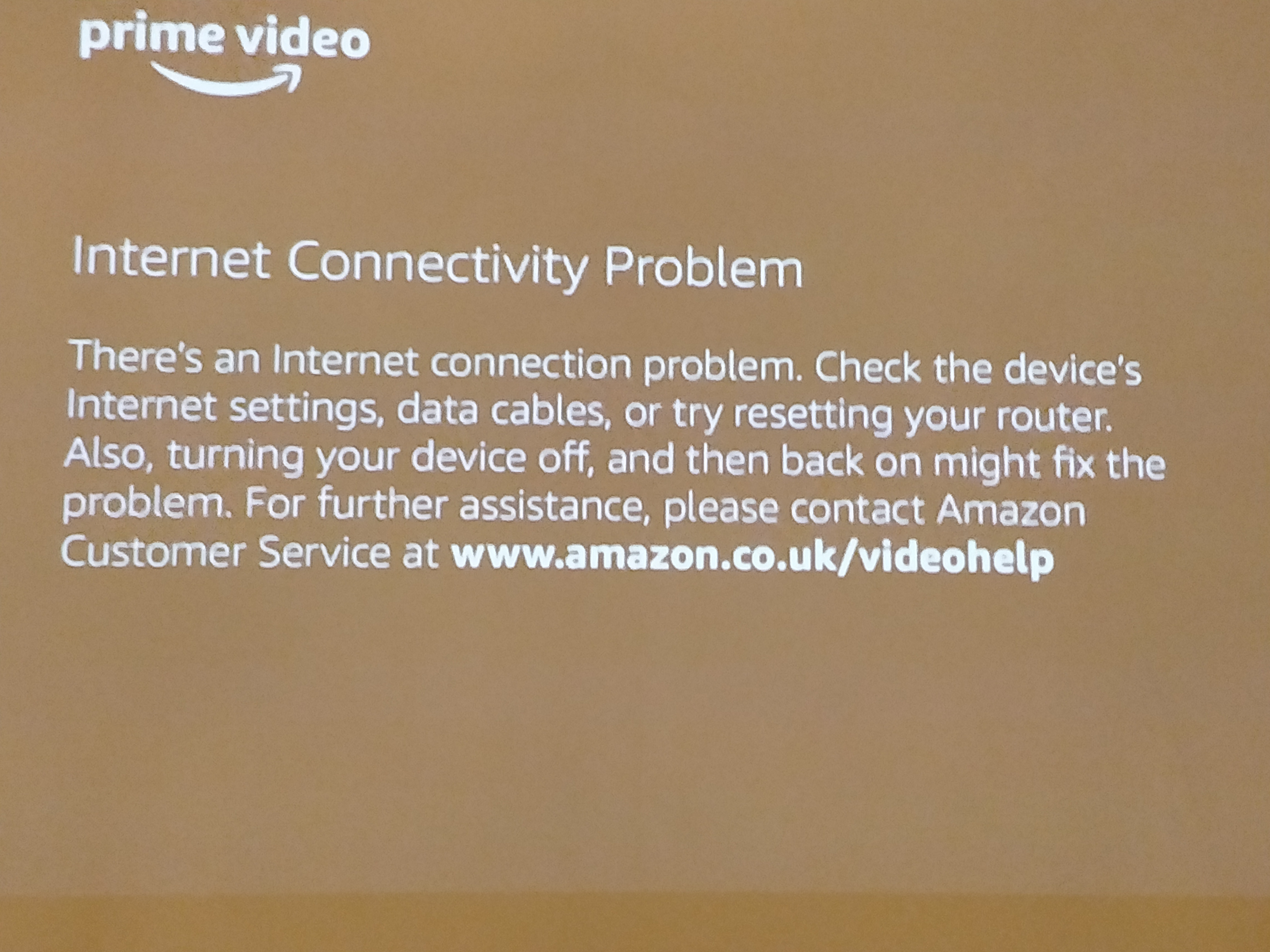

Amazon prime video not working…
Other apps like Netflix is working.
And as always even with this new update the casting issues are unresolved…
