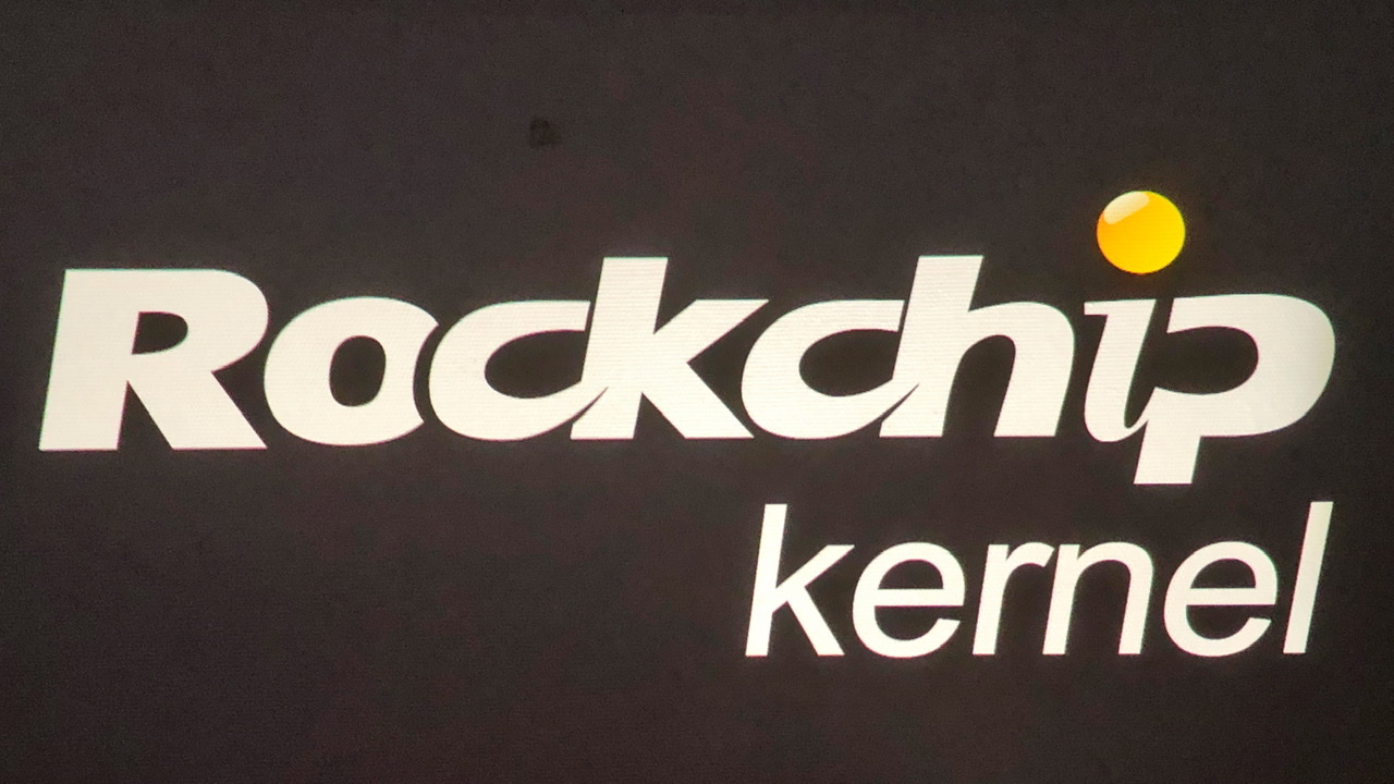

Why doesn’t the PPX use all the available resolution available on the light engine? When the Rockchip logo displays you can see there’s more pixels available, and this picture also shows this (see the edge of light versus the edge of the image):

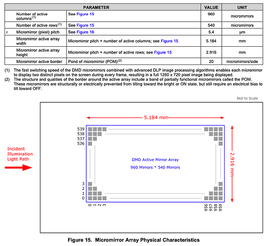

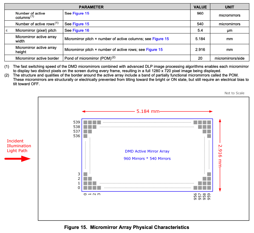

Also, I found this in the DMD’s tech specs on the Texas Instruments site:

I’ve been curious about this myself for the longest time but haven’t been able to find a definitive answer. Perhaps those pixels are inactive to create sharper, darker, borders for the projected image or to create a more focused, central beam of light that can be shaped by the optical array/lenses. But then, that does not explain how the whole area is used when the projector boots up with the Philips logo displayed. Perhaps @Philips_Support_P or @wernerj can shed some ‘light’ on this.
This image is wider, as wide as the white border in my previous picture, indicating that the unit is capable of projecting past the image border:
But this is also wider than the Philips logo at startup. This image only appears in the event of a cold boot or crash.
I’ve gotten the RK kernel boot splash (most likely early boot stage splash) even from cold boot once (brief sub-second flash), that’s what made me realize that the built-in splash of the dlpc itself isn’t used for the philips white splash. All of that is HDMI output from the RK SoC into the V56 chip, then parallel video to the fpga/dlpc. That means that if you’ve got 960x2 pixels width while booting but it’s reduced after android has booted then some underscan is configured within Android. No keystone correction active at all? If you run HDMI or usb-c video you’re getting an image the same size as the boot splash? What about that nasty no signal image (internally generated in the V56), how large is that in comparison?
