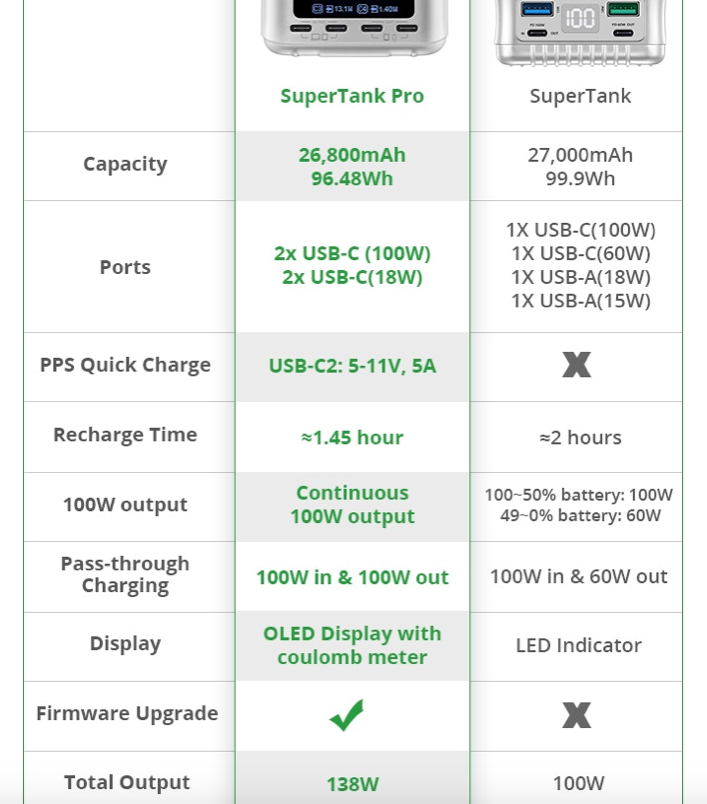

What is the difference between this supertank pro and the original supertank which they are still selling?
And I see they now have a sale for the supertank and charger bundle on their site.
To be honest, ive no idea
In the UK the pro works out about £115 for the super earlybird, and that was cheaper than the current s’tank.
What I like in the pro, is the upgradeable firmware to support future devices, which im hoping means 15v4a as the max is still 15v3a (which is fine 99% of the time)
Ill have a look at them side by side maybe tonight, unless someone beats me to it
Thanks fella, didnt even notice there were no USB A ports, may need to get another cable for some of my older devices.
It actually comes with one USB C to USB a
