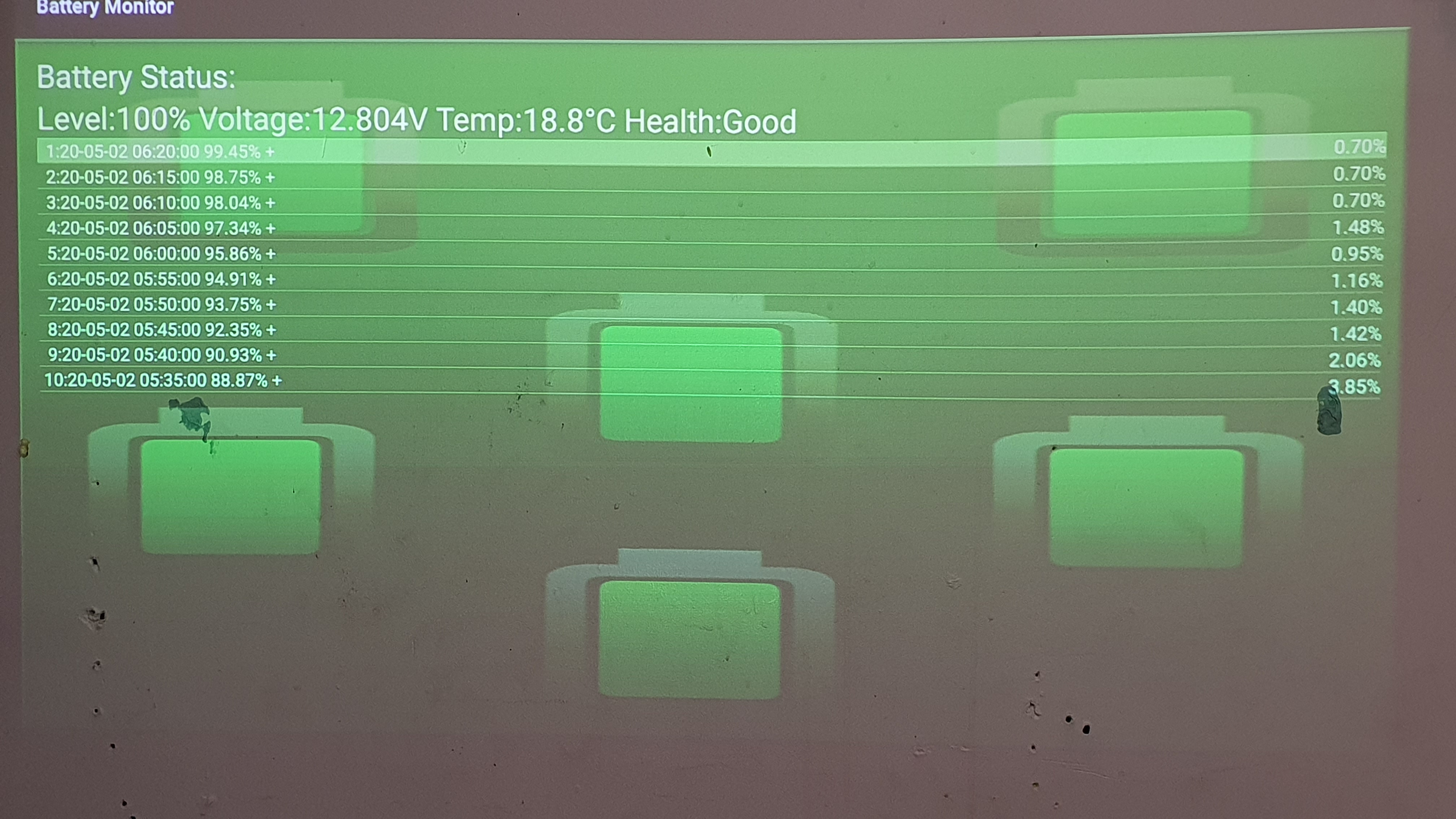

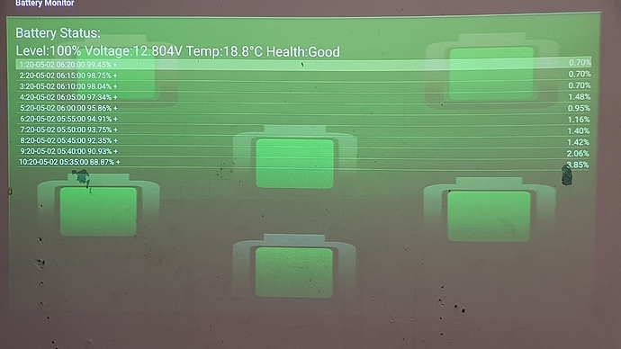

Cinema in bedroom:) I am testing right now my new Xiaomi mi powerbank pro 3 45W.
The PPM runs on it and chagres at the same time. 5% in about 20min. At first the battery was on 67%.
