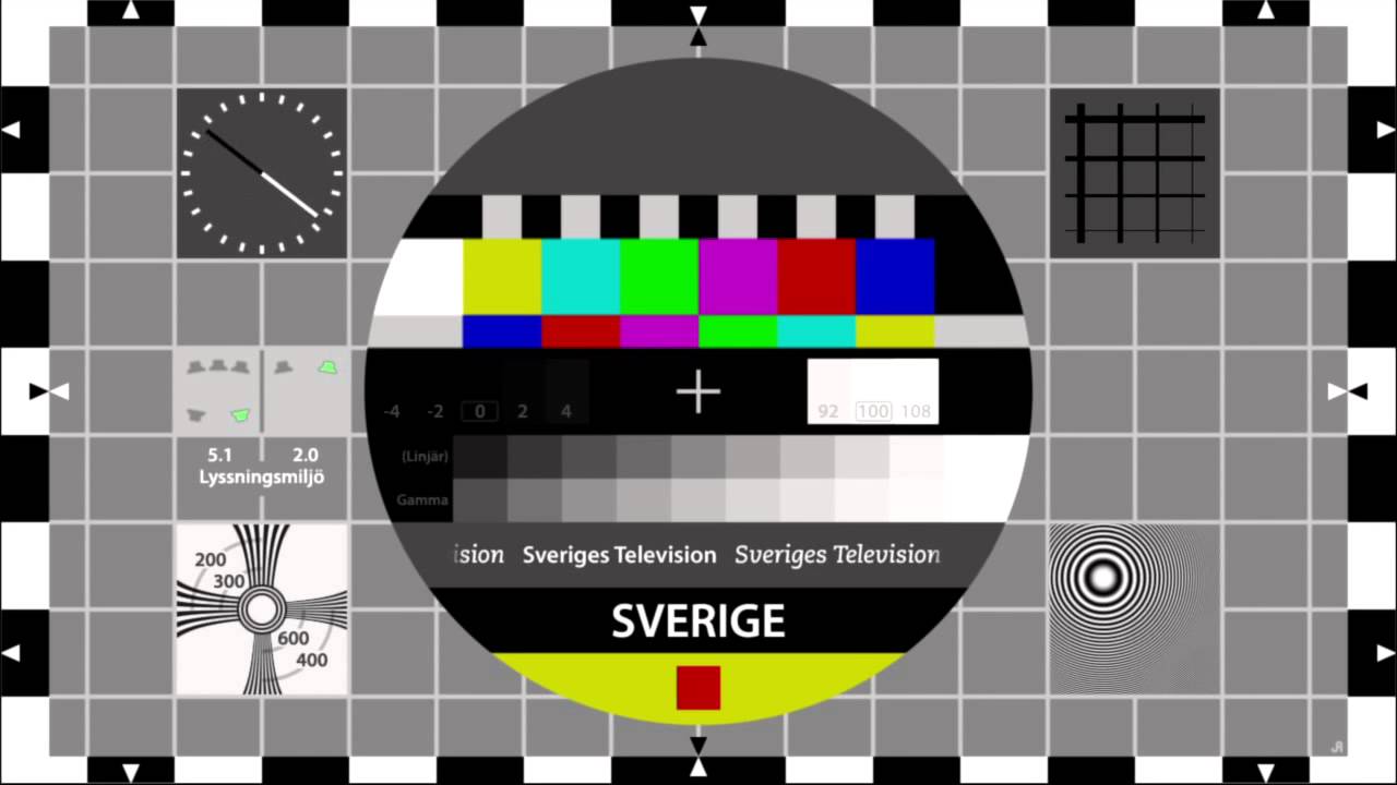

To debug/setup 4 corner (and maybe other correction) better, can we get a grid of squares texture similar to UV mapping textures but 16:9? Providing one and allowing the user to select their own would be fantastic.
This will give you orientation and stretching/compression of areas.
example, a 1080p version of:
or
This may be even better:
@izaaner thanks for the suggestions, we will try to implement it.
Interestingly, the 2nd-last pattern you’ve suggested is the Philips PM5644 test pattern. It is one of the test patterns included with the beta-only color adjustment app.
