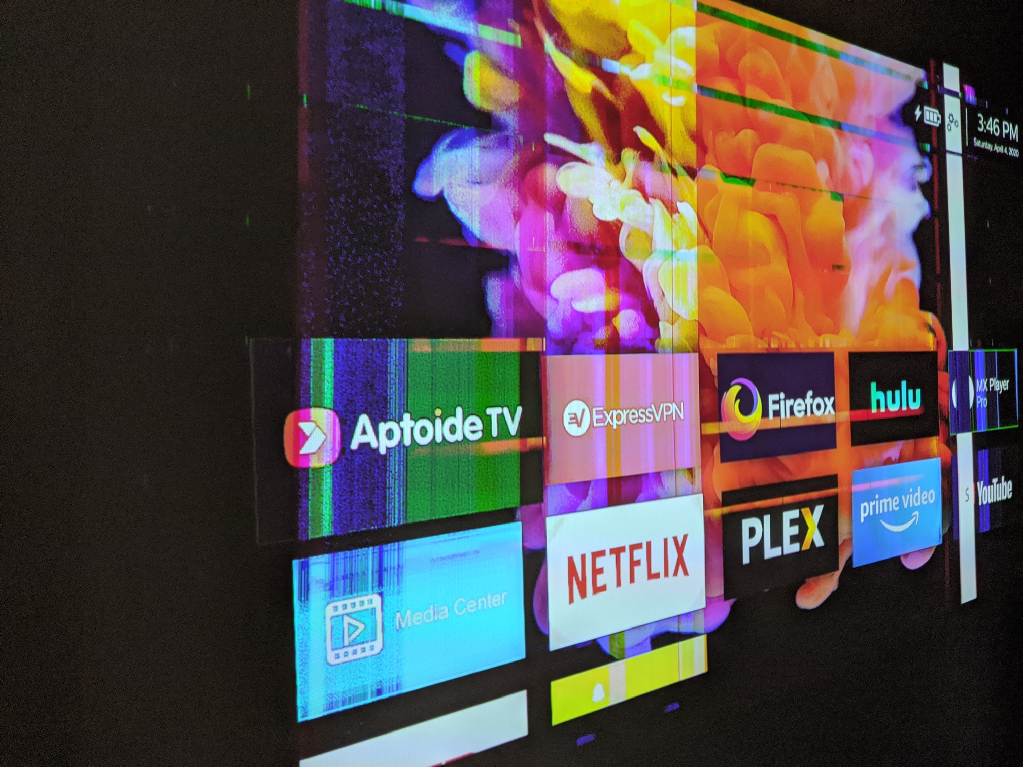

Hello. My PPM arrived on Monday, unboxed on Tuesday, updated updated firmware. I compared presentation, normal and energy saver modes. Energy saver mode seemed bright enough for me and much quieter. I figured it would run cooler as well, right? I tried using it, but got frustrated with the internal software so I ran a long HDMI cable to my NVIDIA Shield and I’ve been using it in short bursts that way since, everything was great. Now this morning (Saturday) was my first chance to really sit down and enjoy it with the kids, watch a movie, play some games. All good. Left the room to eat lunch. Came back to find the keystone correction no longer applied. Went to adjust the projector angle so the auto-correct would kick in and it was RED HOT. It wouldn’t respond to the remote either so I pulled the plug and held in the power button until it powered off. I left it to cool down for 30 minutes and when I powered it back on, the image was scrambled as shown in these images. Any idea what happened, can it be fixed from my end or do I need to send it back?

Turning it back on now, everything seems to be working apart from the scrambled image.

Oh, the image is permanently scrambled. I’ll have to request a replacement. Damn.
