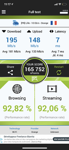

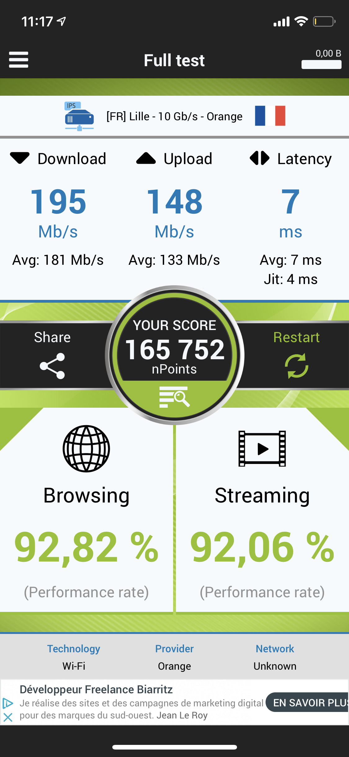

Also I am streaming over WiFi on a fiber optic network with around 200 mbps rate so I believe the network can’t be incriminated. Live streaming is very slow on the PPM also. I wondering if there couldn’t be an issue with the PPM’s WiFi receptor.

If video plays smoothly → there is no network problem.

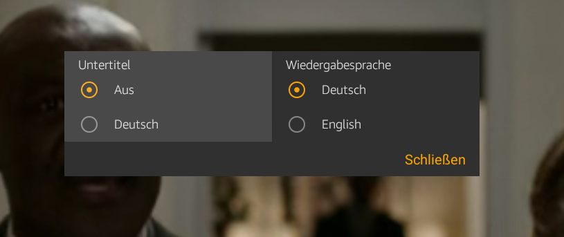

Q: Are you playing the default audio track (i.e. English audio for English show / French audio for French show etc.), or a dubbed audio track? This can be changed from the top-right corner Subtitles icon:
Does changing to another audio track make the problem worse or better?

I only watch default audio tracks. Dubbed audio tracks obviously can’t be perfectly synced. In the present case when I watch per exemple Vikings on Amazon Prime in English it feels like the audio is dubbed in English (as I said before it is really light it just gives you the impression that something is wrong)
