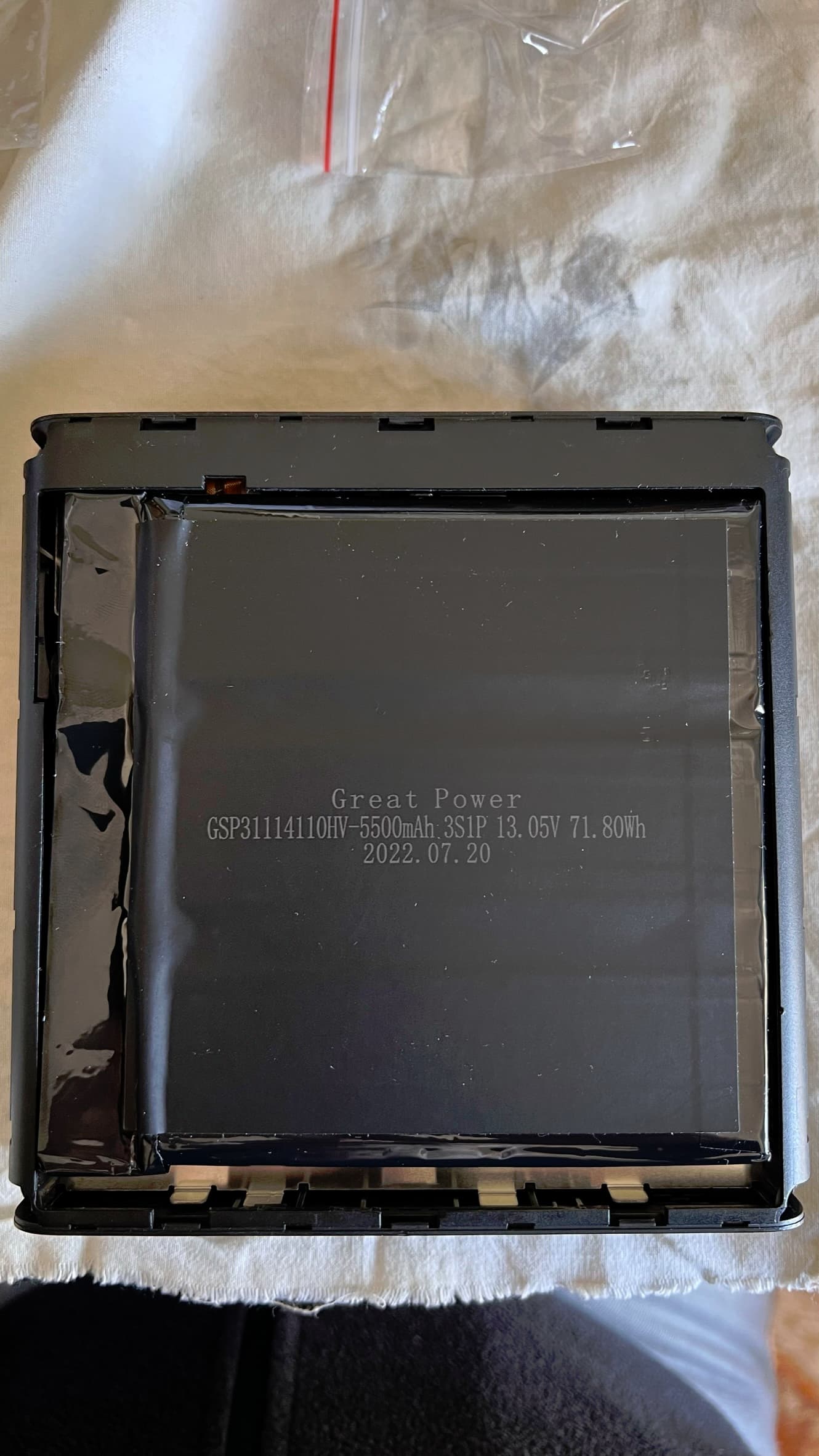

Since last August I have asked/write for the replace of dangerous battery contained in your video projector but, as of today, nothing yet!
Finally, after only few months just arrived a new battery…
Battery placed in my PPX and works again!

Interesting. The battery is from GP.

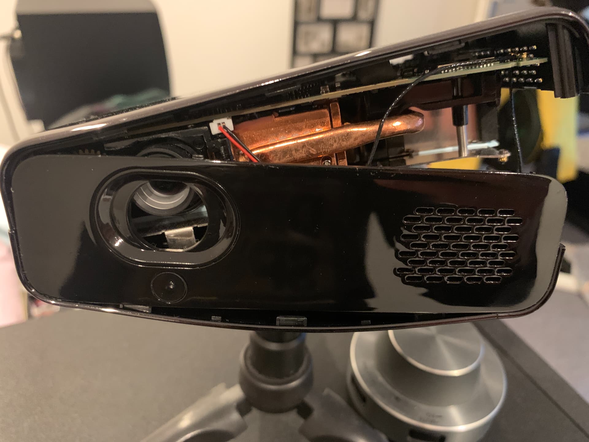

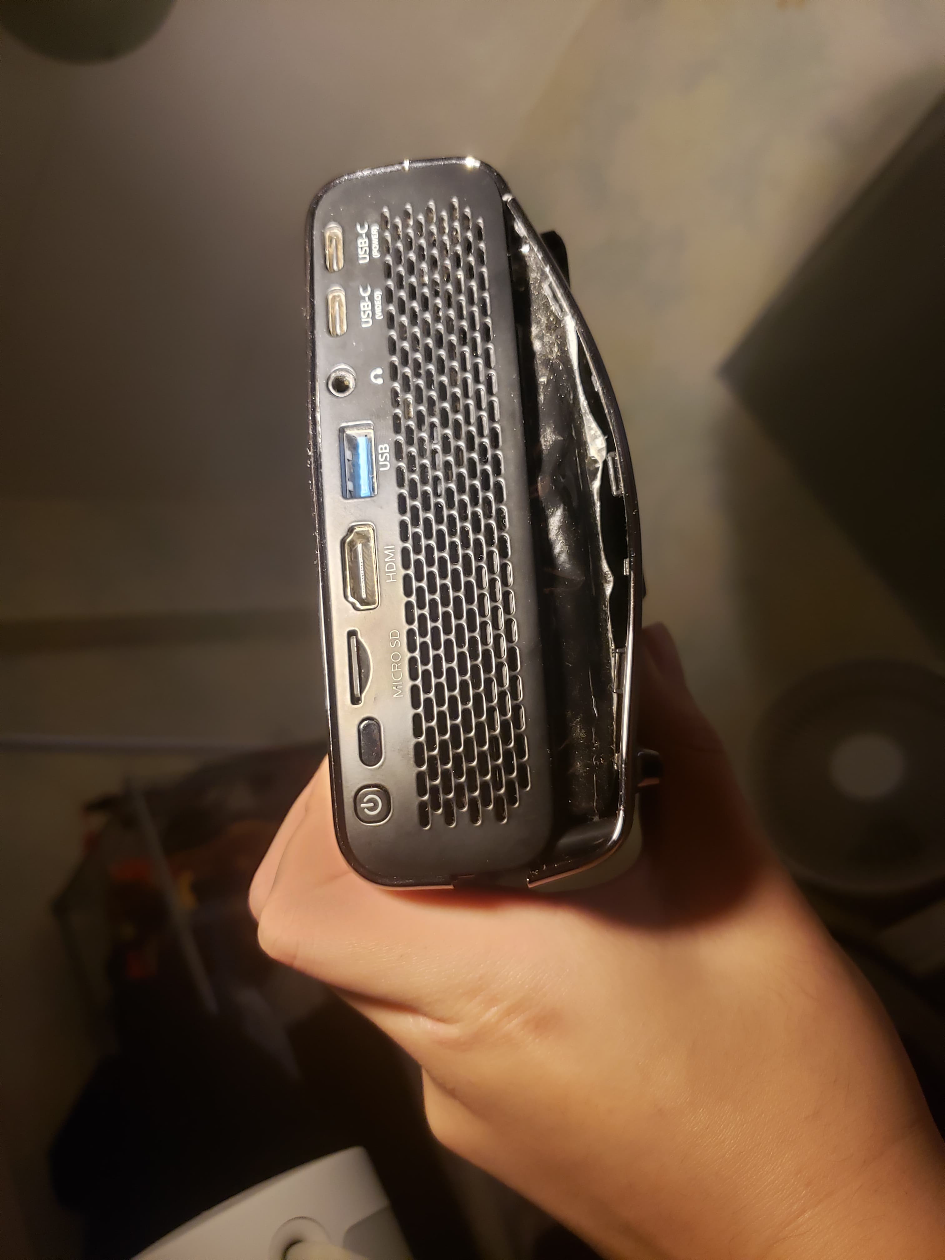

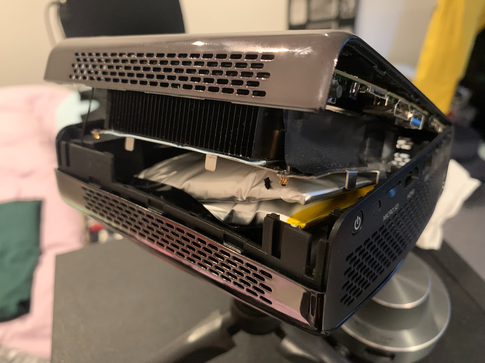

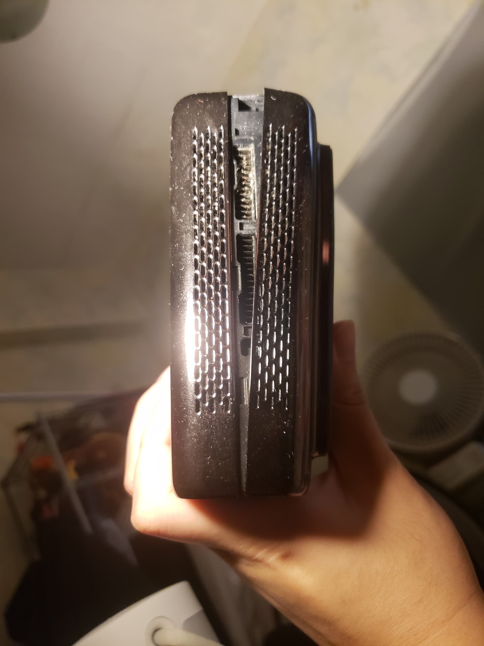

Why do you wait so long… Pcb can have damages or cable tear… A LiPo battery need to be removed when bloated…
Just remove the bloated battery asap, if you still want to use the projector. Otherwise there could be damago to the motherboard.

this battery only 5500mah ?
