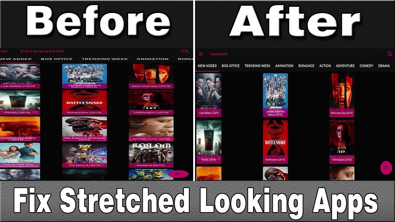

Yes, changing the dpi from 160 to 320 misleads apps into believing they’re running on a phone with a high-res display rather than a tablet or a TV. This is a problem within the apps. We’re looking into a workaround, but I don’t have a timeline for it yet.

Try this:
