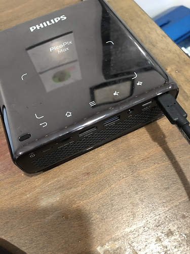

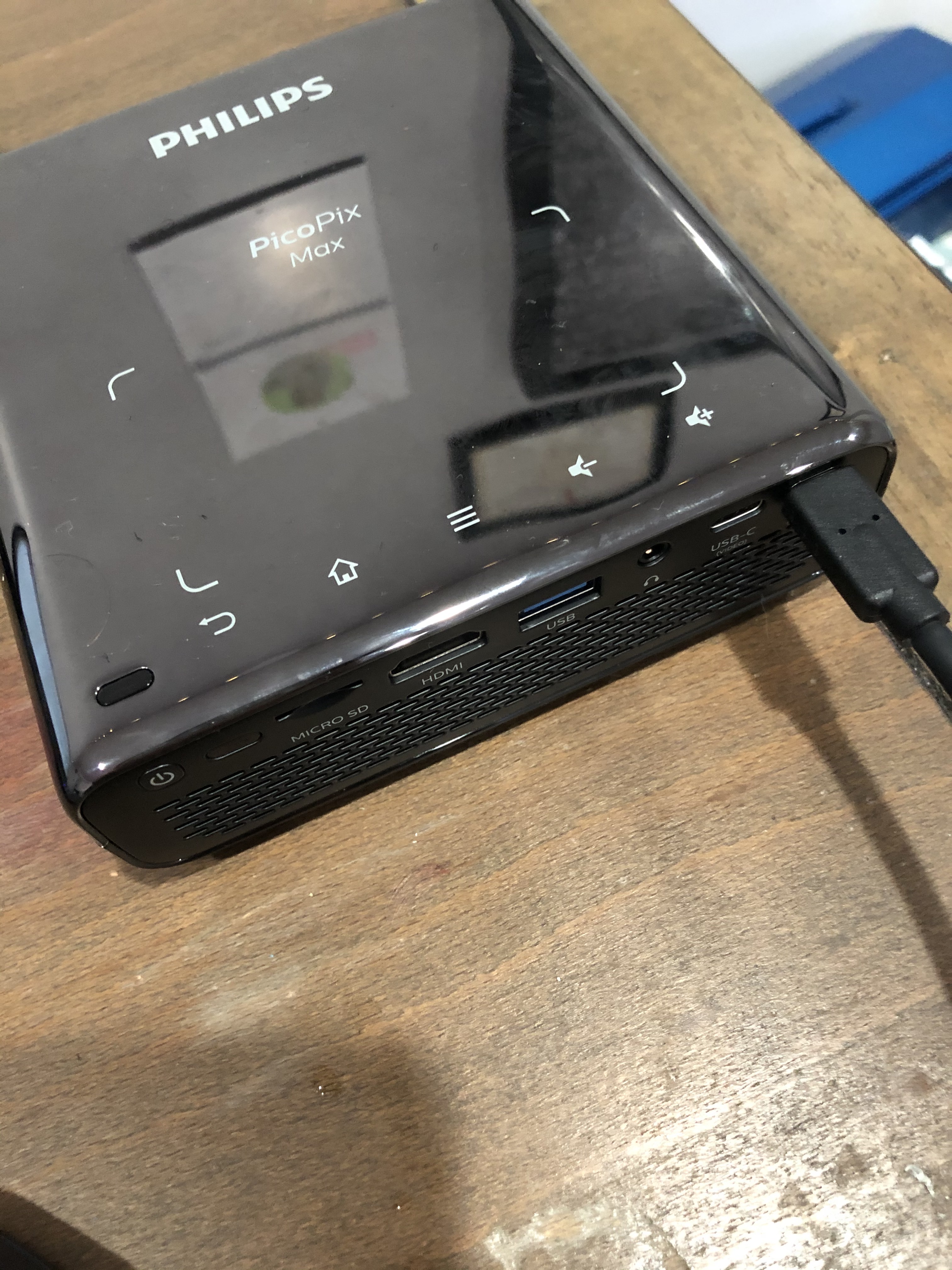

M PicoPix was working great until it ran out of batteries. After I tried to charge it but the charging light won’t even go on. I tried a different USB-C cable and different wall sockets but it still wouldn’t charge.
Can you test the charger with some other device to see if it’s the charger or the projector that’s at fault?
Hi, I test the charger and it works with another usb c device

I have exactly the same symptoms. Does your USB-C lead push in with a click? Mine doesn’t.
Mine does make a “click” sound when the USB-C goes inside
