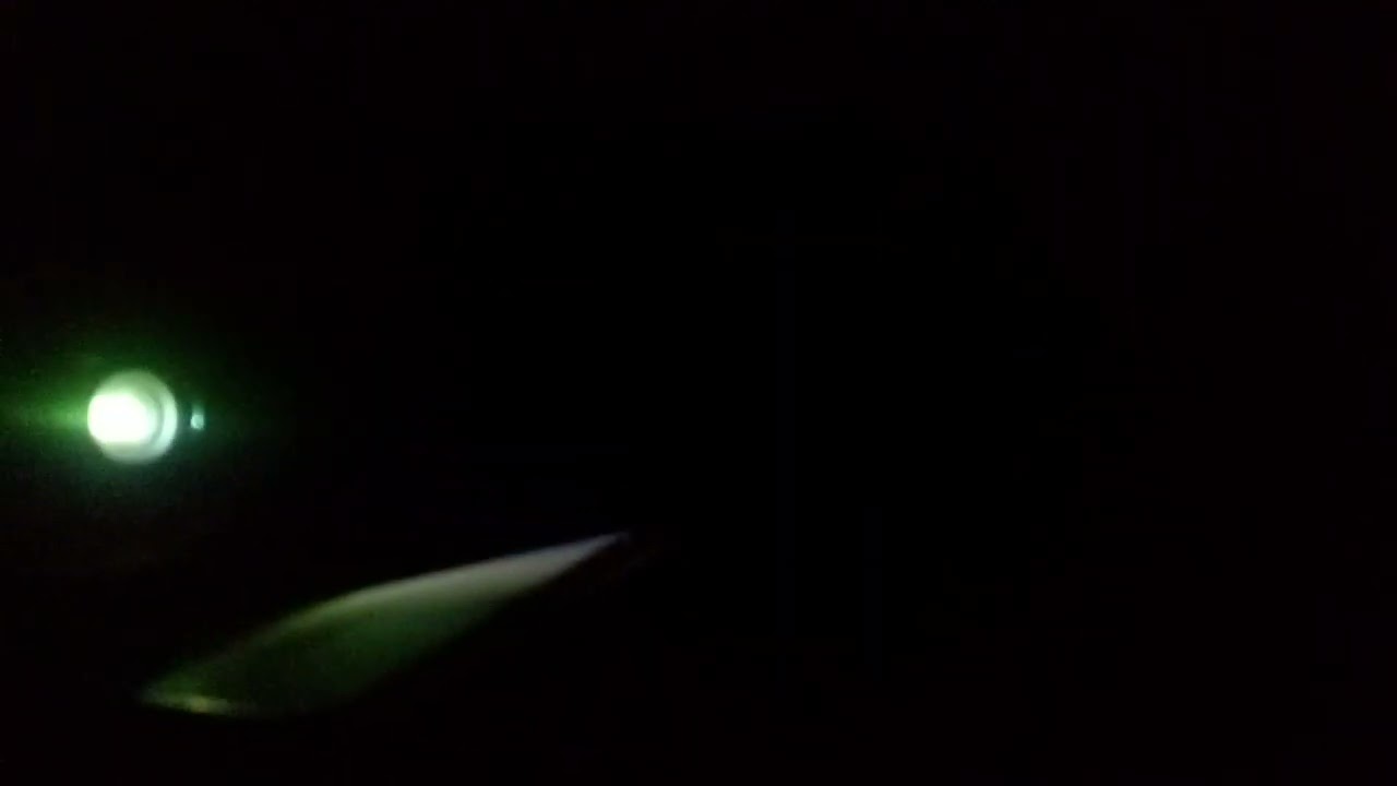

So today I tested the ppm one for 6+ hours again and sadly the flickering started again.
I have uploaded the video to YouTube and the video is captured using Google Pixel 2 phone camera.
I want to mention that the flickering is much more visible to the naked eye than in the video as my phone’s camera was autocorrecting the image and therefore the flickering was not captured very well except towards the edges.

It is really strange. The only assumption that I can find is overheating. Do you have a small usb fan (like I put a sample photo just below) to test and understand if it is a heat related problem? If you have, plug it to a powerbank and turn it to the picopix one. If the flickering stops, then it is clear for overheating. Then maybe philips moderators can support you about this problem.

Hi readers,
I noticed this strange noise coming from inside the Philips Picopix Max One everytime the image starts flickering.
Does anyone have any idea what this is. I’ve made a video and here’s the link.
Philips please respond and help me fix this issue.
I think it is a switching powersupply problem on the projector print. Think such small projectors are not made for long continue use so maybe an overheating problem with excessive current consumption ( gets the psu adapter really hot when the problem starting?) And as it gives excessive rf noise injecing into the dmd driver chip wich can cause the strange behaviour of the dmd chip. It is a mems so if there is excessive current, switching inductors can have generating more rf noise and disrupting the working of the dmd circuit…
