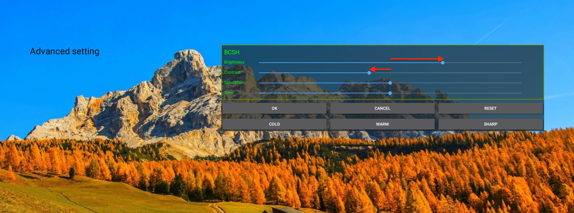

Hi @ThunderStrk, first of all the settings described in this thread will compensate for the gamma curve of the internal Android video vs. the other external inputs. So these adjustments make it linear, they should not be further adjusted. This is why we burnt it as default since SW v1.0.27 onwards.
If you’d like to adjust the picture, you should use the Brightness/Contrast/Saturation/Sharpness settings within the normal Settings app. These will be applied on top of the ‘corrected’ values from this tweak.
We do have 3 brightness modes Energy Saver (Eco), Normal and Presentation, but they’re not exactly colour modes as you’re looking for. However a “looks” feature is coming out soon (it has been a beta feature for a while), that should help you achieve the look you want.
@Philips_Support_P, regarding the above statement, are you saying that with v1.0.27, the recommended settings (as in this picture below) has already been preset?
https://community.projection.philips/uploads/default/cf1c306158f1cf466c10b158c458870d3583b11c
Yes

I applied 1.1.02 after I received the machine (from 1.0.26), but these settings are not baked in for me. Is the advanced settings screen supposed to look like in your pictures, with brightness and contrast off center? Or are the baked-in settings the new center positions? Because they’re centered on mine, and the picture is off as described here (and confirmed on the lagom.nl test image).
I tried manually setting to the positions displayed here, and while shadow detail returns, so does banding. It’s a washed-out look that looks just as off as the first one, only in a different way. Which one is correct?
This is the correct setting:
Set it while using energy saver or normal Brightness please.
