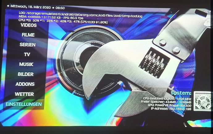

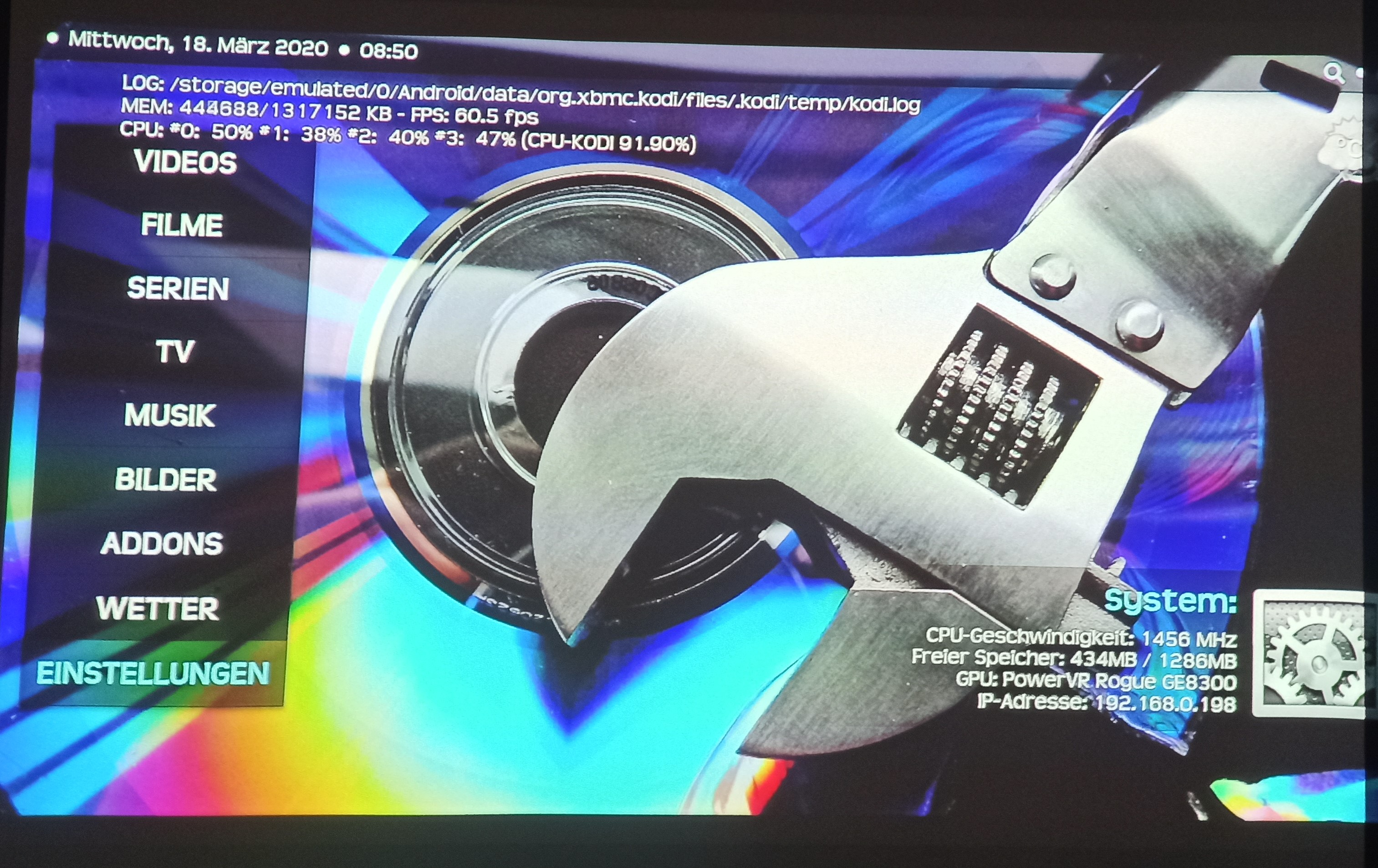

Enabling debug logging in KODI I can also see a huge FPS difference even in the UI without b playing a move between PPM and FireTV4K
PPM:
FireTV4K:
PPPM shows CPU0 at 100% …. FireTV4K Max Value is 50% per CPU

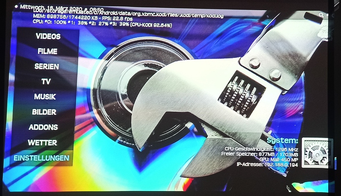

PPM:
But that is a different GPU on the FireTV4K (is that the Stick version??)
Does anyone have the non-Stick FireTV 4k (the rectangular model)? It has Mali-450.
True, FireTV4K has a different GPU: PowerVR Rogue GE8300.

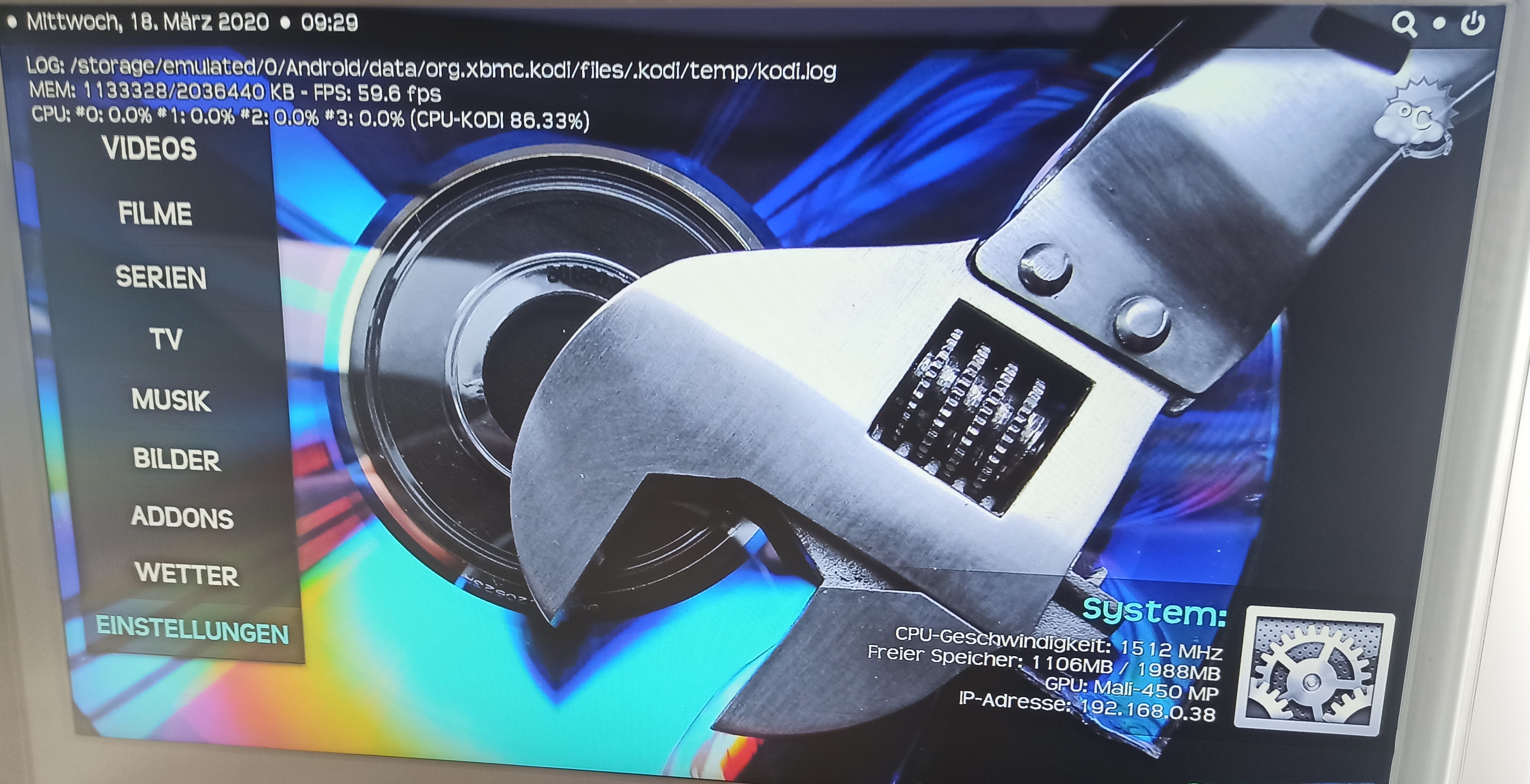

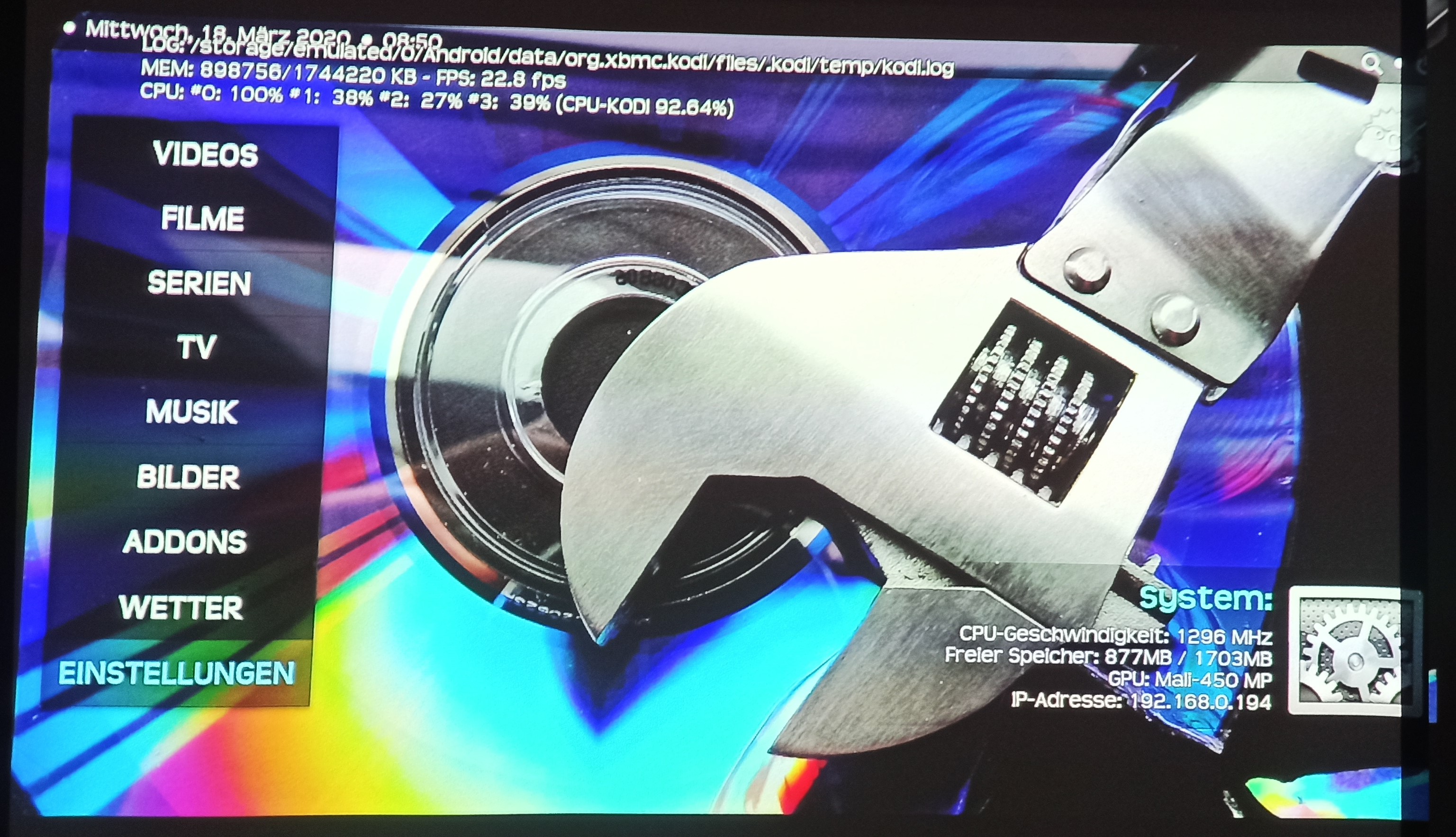

I just did the same test with my MiBoxS witch has a Mali450 (see under System). Picture taken from connected TV though…
FPS for Mi Box S UI are around 60 vs PPM around 23

The overlay strangely does not show any dropped or skipped frames (Ctr.-Shift-O). Both on my MiBoxS and on my PPM. The overlay is there, shows 0 dropped skipped frames. but playback on PPM is choppy.
Interesting, so decoding is fine but rendering the ui and video on top of decoding is choppy
Yes, that brought me to the idea if it might be a judder issue at 50 or 60 hz and not the native refresh rate.

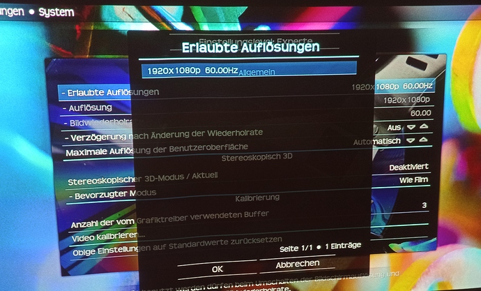

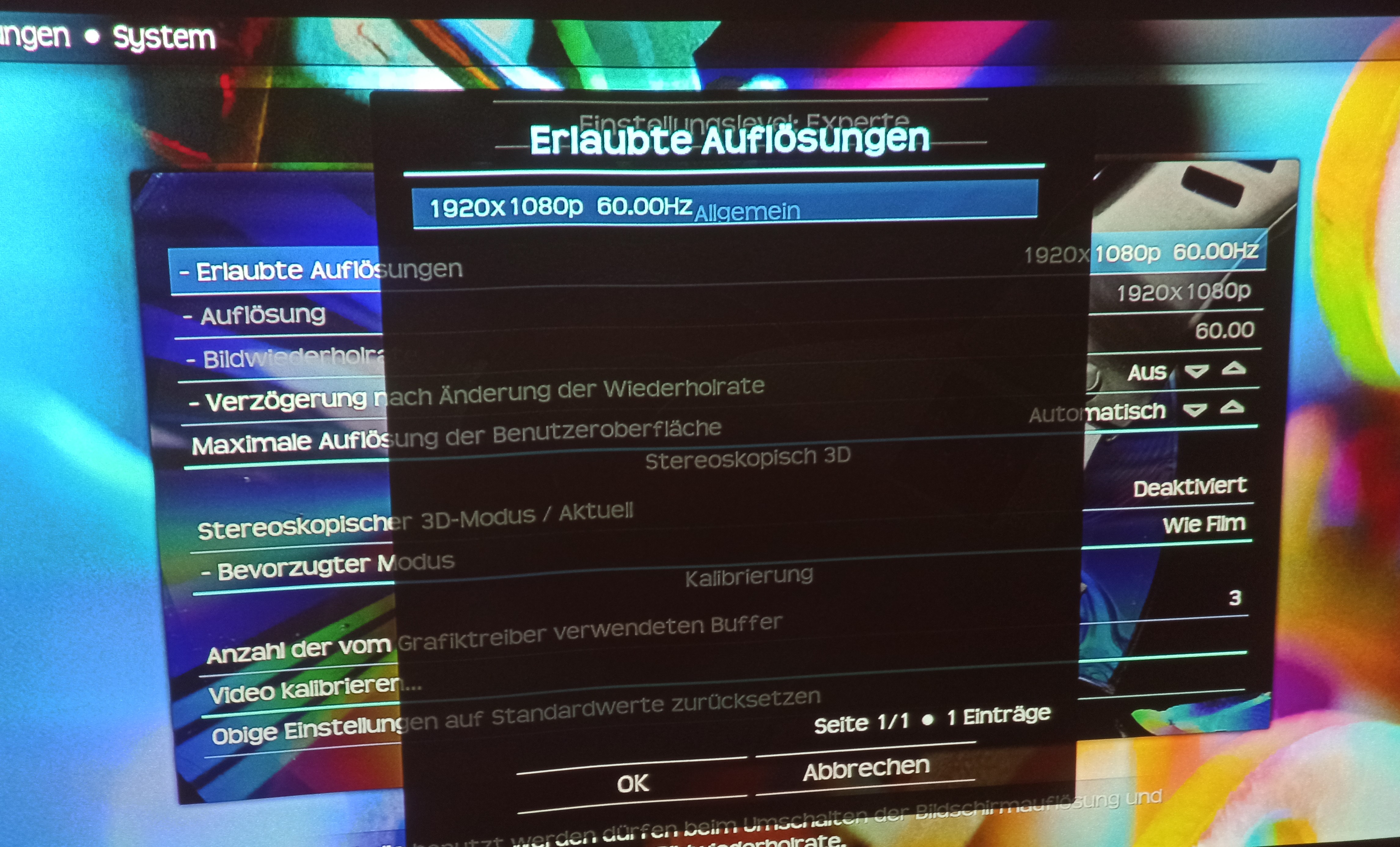

Could it be, that the Kodi UI is now running with a different refresh ratethan the movie playback ? The whitelist within Kodi’s settings only shows 60Hz/1080p. I could not extend it to other formats…

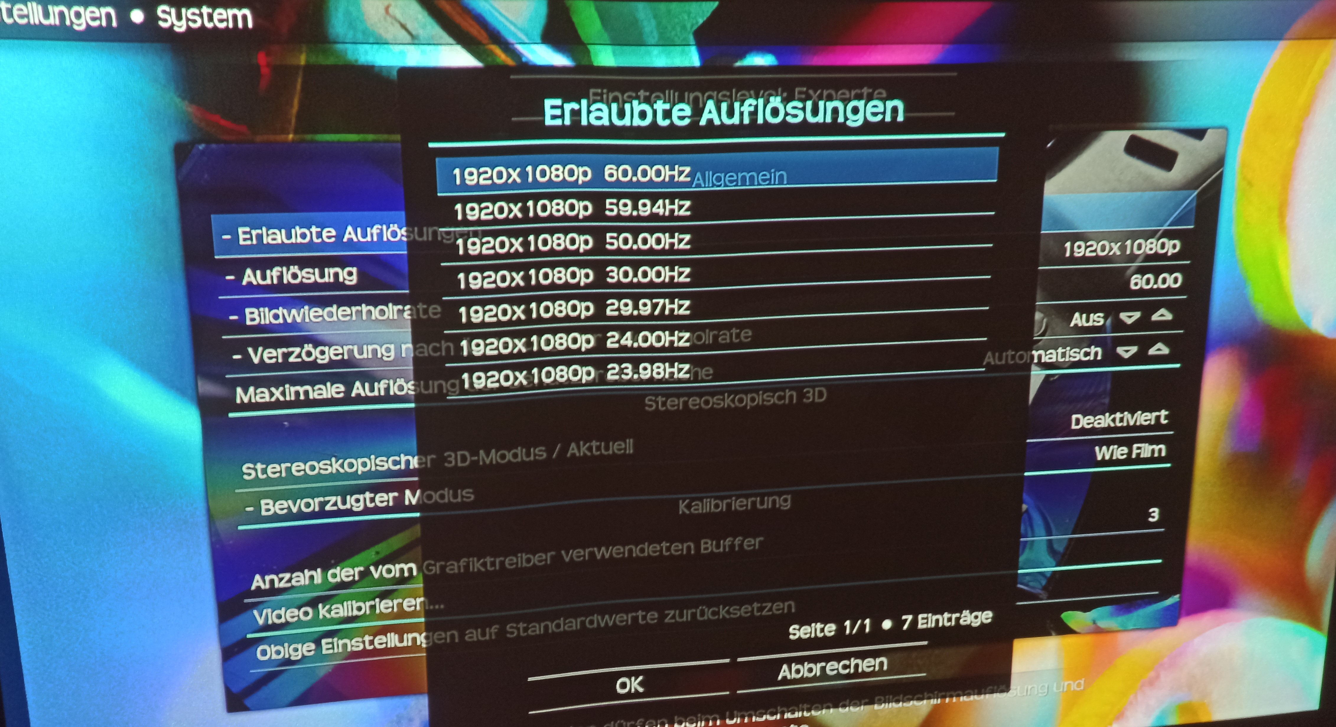

The link you have posted is related to buffering which I don’t think is the cause here.I believe it must be somehow related to the refresh rates. I already enabled expert settings mode within KODI. Compared with my MiBoxS I can see the following differences to PPM:
Allowed video refresh rates are much more than with PPM
MI Box S:
Could this be some Android build Limitation ?

Sure, that seems something worth to be tested. - But at the end, I hope that Kodi is working fine out of the box without any of those tweaks. - I guess a lot of users will not patch that advencedsettings.xml manually. Hope that rockchip could do some tests here, too. If they got the PPM it should be easy for them to test and see the same problems. - Like low FPS during logging of the UI… Strange is also Kodis screen refresh rate white list only showing one entry (60Hz 1080p). Not sure what is the culprid here, but for me that looks like strong evidence for something beeing wrong. This list should have at least 7-8 entries. Hope that Prashant can get some support here from the android or rockchip specialists…I strongly believe this is not a HW limitation issue, but more something that could be solved in software though…
