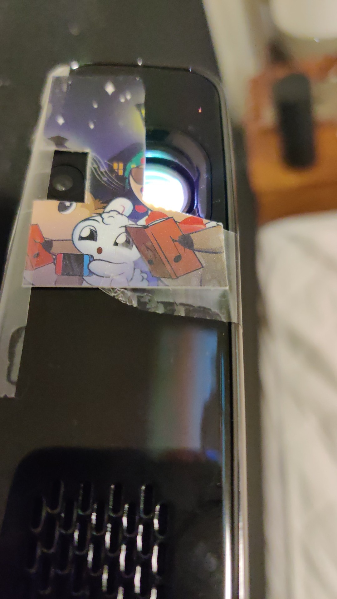

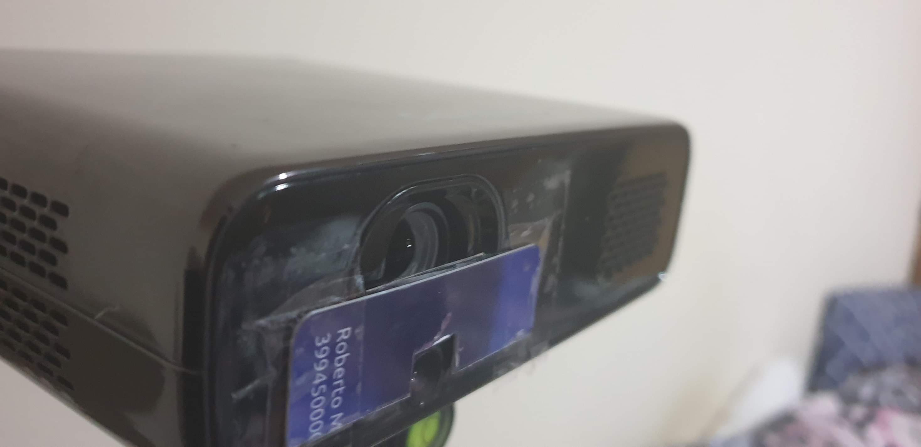

I’ve come across a light halo being cast downwards, due to the general circular cast, it turns out that the projector doesn’t have a bottom horizontal limiter to block downwards cast. You’re likely to only notice it if you’ve the projector casting in close proximity to yourself, as in right next to you, on your left/right side.
Hopefully in a second revision of the device, it can be addressed.
How did I “fix” it for me, by taking good inspiration from the great MacGyver.
I had initially blocked the left side casting, but it wasn’t as prominent on mine, so I reverted it to just to the bottom limiter. I may do new limiter with the right measurements for both bottom and left sides.
The device works well, I’m very pleased with it, I don’t even need to use the chromecast anymore. They managed to accommodate a lot of requests and improvements for us during the campaign. A small distraction can happen, this one doesn’t impair the device. Most users may not realize its there or even be bothered by it, for those that do get annoyed by it, easy fix. And with all of us in quarantine, it’s something to do too.
@Philips_Support_P, sorry for mentioning you here, but I’m unsure of how to submit physical product enhancements.
Additionally to the reported here, adding a lower horizontal light blocker and likely left side too. Can the tiny bevel, around 1.5mm around the screw hole for the tripod mount be removed, so that the whole screw base is properly flat.
I’m using a black surface as my blocker to absorb the light, reducing the reflection chance. Additionally its not blocking the main beam of light, but instead the side light leftovers only, the excess if you will, the light that spills over, which is much weaker in both brightness and heat, and carries no projection data either. The main beam continues uninterrupted to the wall or casting surface.
The light cast downwards is something that does need to be addressed, since its a typical design feature of projectors to ensure the cast projection retains the rectangle shape and there’s no light leaking. Could this be passed to the product team so that its resolved in a future revision of the device.

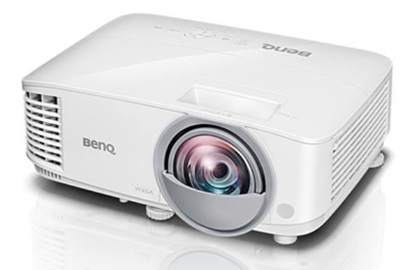

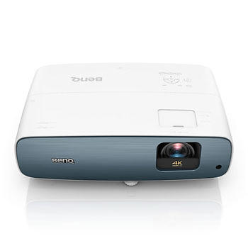

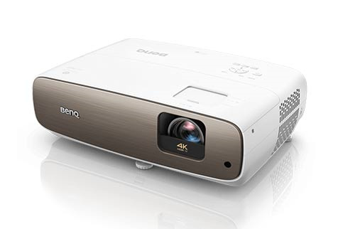

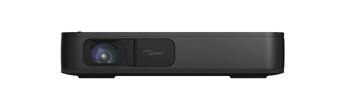

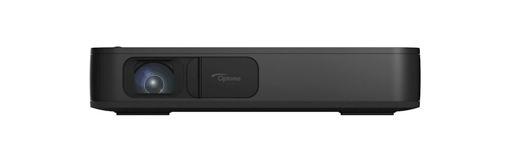

some projectors using this and i have tested this and it feels like the image gets better whit because there is less ambient light lighting up under the projector
here some examples of projectors using this
not many using it but then there lens maybe in a position not need or pointing streight forward?
the same thing works if use it on a shelf whitout tripod and so that the light leaks hit the shelf infront f the projector
whitout this its little bit annoying if you have the projector on your bedside over your head then the projectors light leak will light up the bed
I was about to state the same, taking advantage of the cover and fix it there. Releasing a cover that doesn’t fix the issue, it’s a missed opportunity. @Philips_Support_3@PhilipsNono@IvoGrijt
