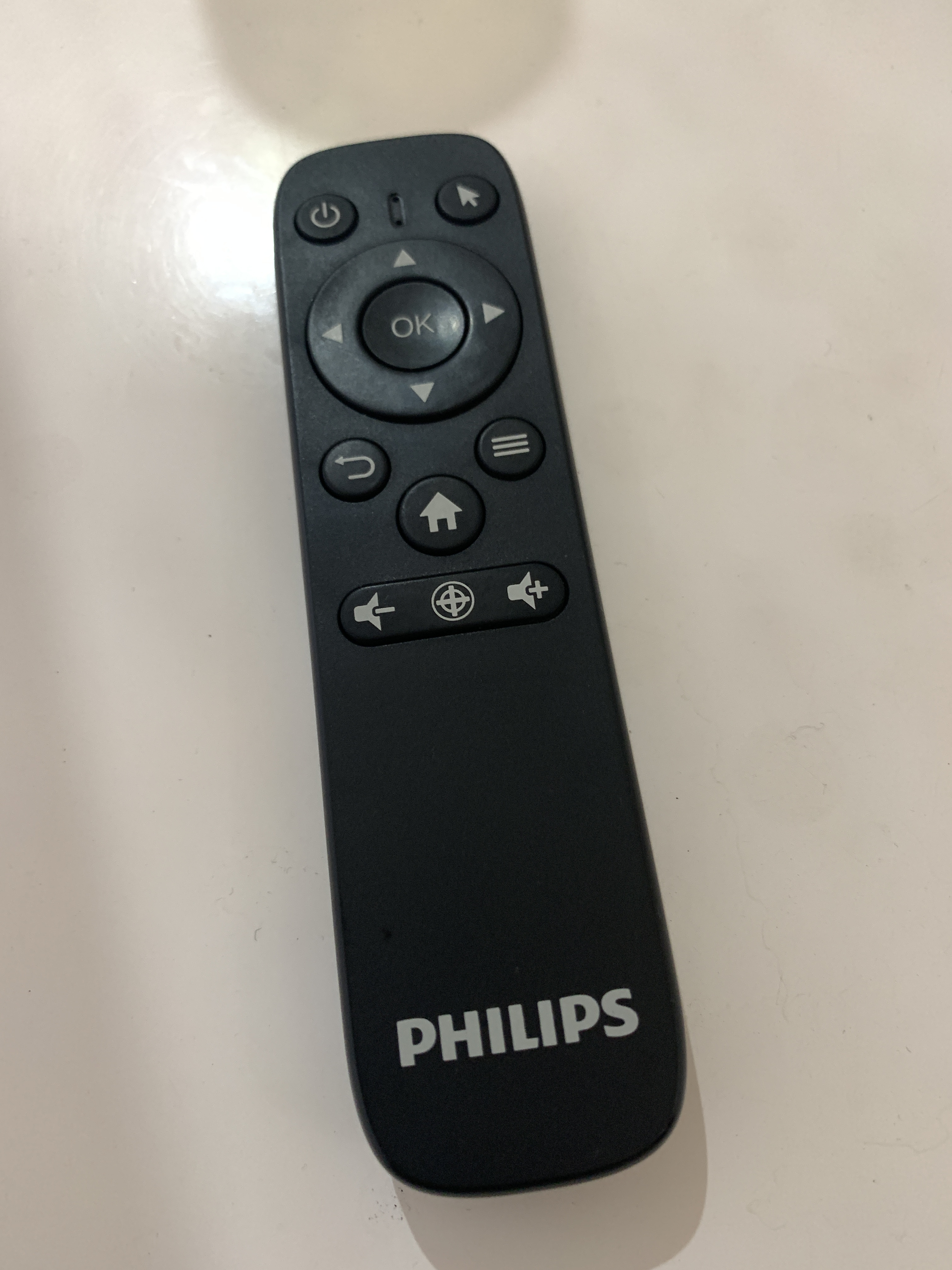

Okay, first time I have encountered a fault so far and hopefully the last, and one that a search through the forums hasn’t helped
Anyway the mouse cursor/pointer for some reason stopped working last night, tried it again today and it’s still the same, rebooted the ppm unpaired the airmote and re paired it, all made no difference, all other functions works well the same as usual, bluetooth is also active so I don’t need to point at IR, it’s only the pointer that don’t respond, it will appear on screen but waving it around hardly makes it move slowly across the top of the screen at it’s own will, even though I try and avoid using the mouse function like the plague but sometimes it is still needed, so I don’t want to lose this function , anyone had this issue before?

Perhaps one of the buttons is catching on the housing, causing it to be pressed all the time? Can you post a pic of the front of the remote please?
The remote is fine no buttons are catching or stuck, if it did I think the lights should be constantly flashing and I should see it, and I haven’t noticed that.

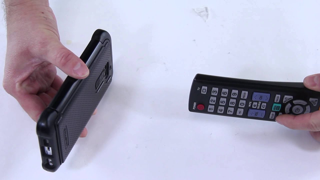

Can you check with your cellphone camera if the remote isn’t sending an infrared signal.
If a button is stuck (internal) the red led on the front will only blink a few times and stops blinking, but the infrared led will keep transmitting.
Yes you’re right the red led on the front does stop blinking, I just tried this with the phone camera but I can only see the infrared flashes when I push on a button , so no buttons are stuck and it’s not sending out any signal unless I press on a button
