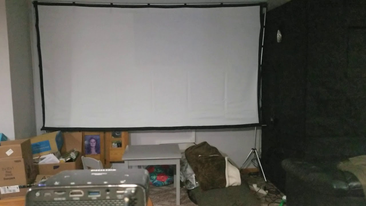

Nothing out of the ordinary happened. One day I powered the unit on and it started booting to a screen with no visibility. The projection seems to be clearly working still. I want to say this happened closely following a firmware update but not directly afterwards.
