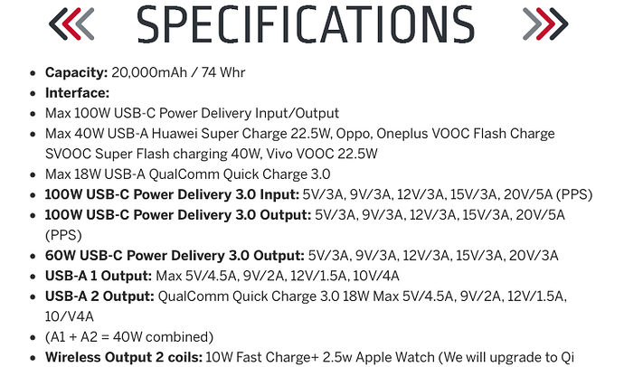

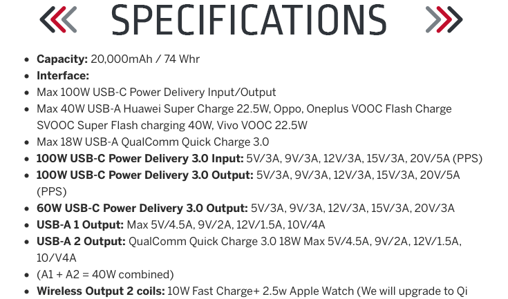

I recently supported a crowdfunding for the new 210W power bank of chargeasap (https://www.indiegogo.com/projects/flash-world-s-most-powerful-210w-usb-c-powerbank/x/22645099#/). I have now got the flash 2.0.

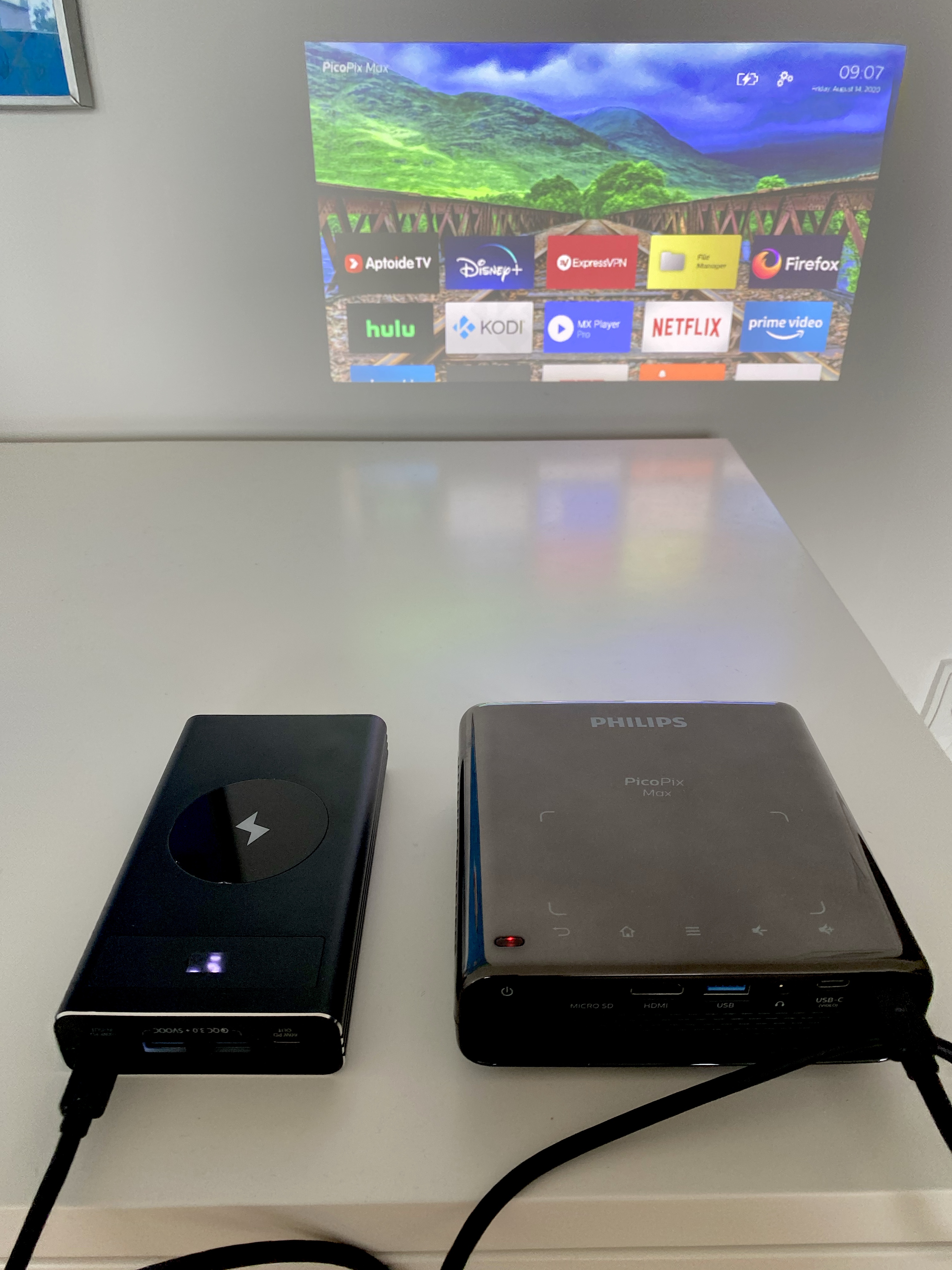

It happens to have one output which is 15V 4A like the charger of the PPM! That allows not only to charge the battery of the PPM out of the powerbank, but also to use the PPM as if it was plugged in! (see the power-icon in the picture below) From now on, very long open air cinema nights seem possible, as well as longer presentations using the power consuming presentation-mode.
Now it’s time to test how many extra-hours of PPM-fun the 20.000 mAh deliver…

See the picture below of the powerbank.
I can only say, it works with the PPM as we hoped it would. And we are happy with it, having all the functionalities we expected and need in our setup.

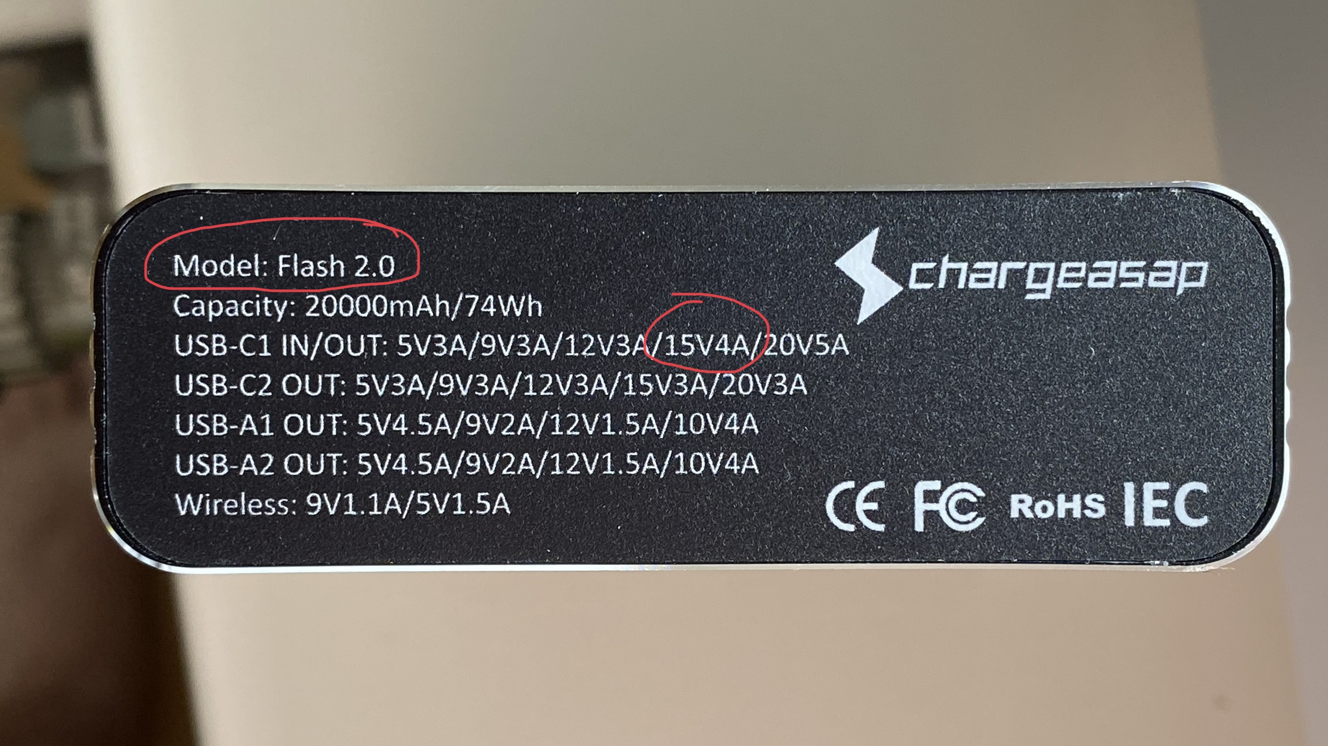

That was the least bit I was worried about, but more worried of the bit you said it has 15w 4a, which is totally misleading, so tell us where are you based and when did you back this and did you have to pay extra to get it shipped? you seemed to have either not read or ignored those questions, so if you can answer them I would appreciate it,

As shown in the picture uploaded, the USB-C1 ist marked with 15V 4A. And using it, the PPM works like being plugged in.
That’s the experience we made. It works as we expected. I’m sorry if you maybe had bad experiences. We, for one, are happy with the powerbank, especially in combination with the PPM.

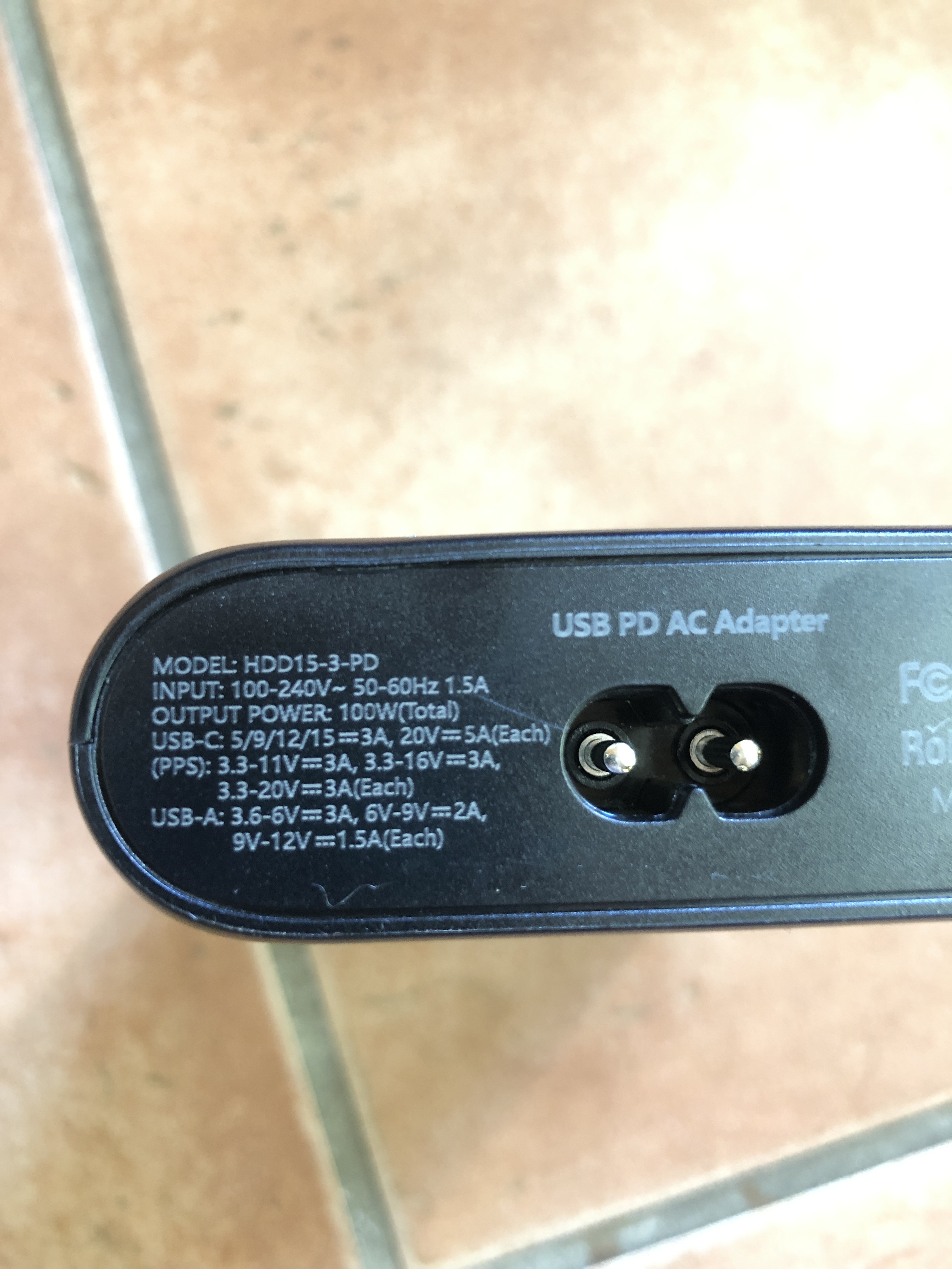

I also backed this, and the extra 100W charger which they offered also. The charger however, despite indicating being able to provide 15V 3A doesn’t make the PPX’ led light up, so no charging or anything is happening. I have another charger that only specifies 15V 3A but that’s one does charge the unit.
But since the Flash 2.0 offers pass though charging, meaning I can charge it while it is providing power, I can take 15V 4A from it while its charging itself with 20V 5A for the other ChargeAsap charger.
