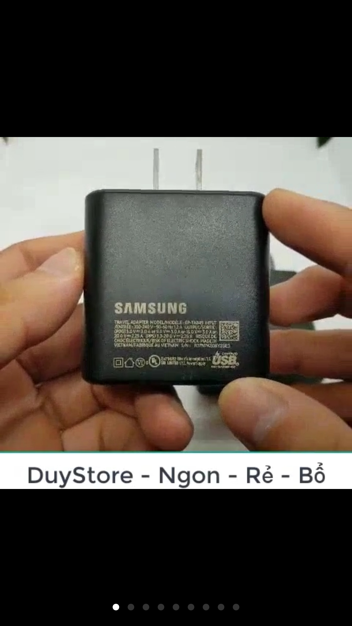

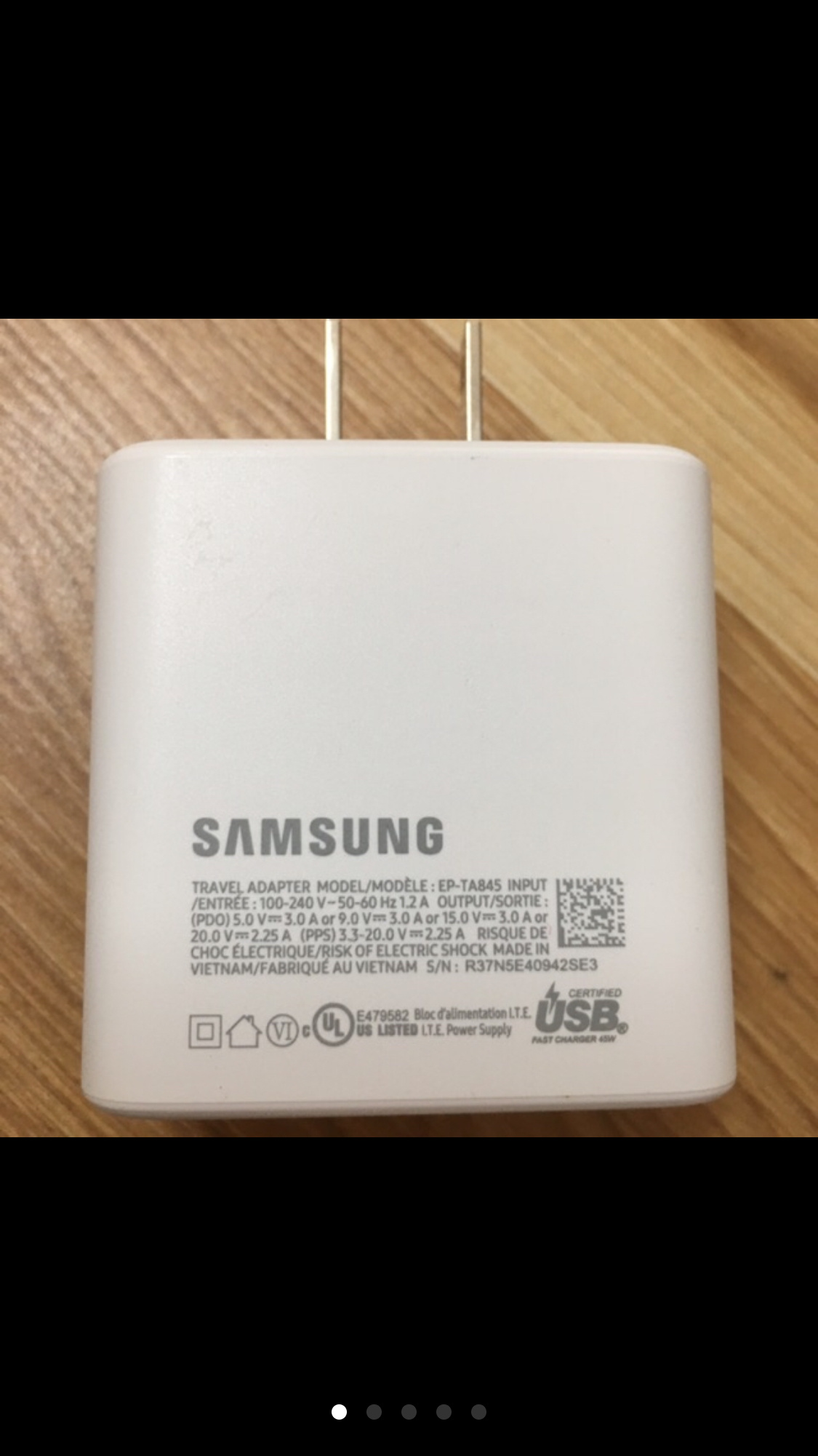

Power adapter SAMSUNG PD 45w was good working for PPM ( tested on normal mode and presentation mode)
