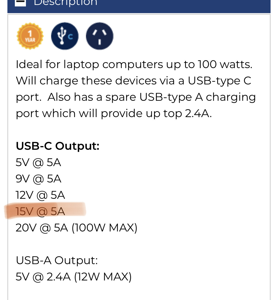

20V, 3.25A is the recommended specs though I can see in your picture that it does support that as well. Sadly, compatibility has been a hit and miss on the PPM.
Thats unfortunate then. How about this spec? It can supply 15v at 5amps? Would this work with ppm? @Philips_Support_P @IvoGrijt @kugiigi

I found a replacement charger that works for ppm here in Australia. This one is capable of supplying upto 5amps at 15v. I see the red led coming up on the ppm now and also I can see the charging indicator on the screen once I turn on the ppm.
https://www.jaycar.com.au/112w-usb-type-c-laptop-charger/p/MP3344?pos=2&queryId=a6608bd331d7f3b7440989b1bec155b3&sort=relevance#
