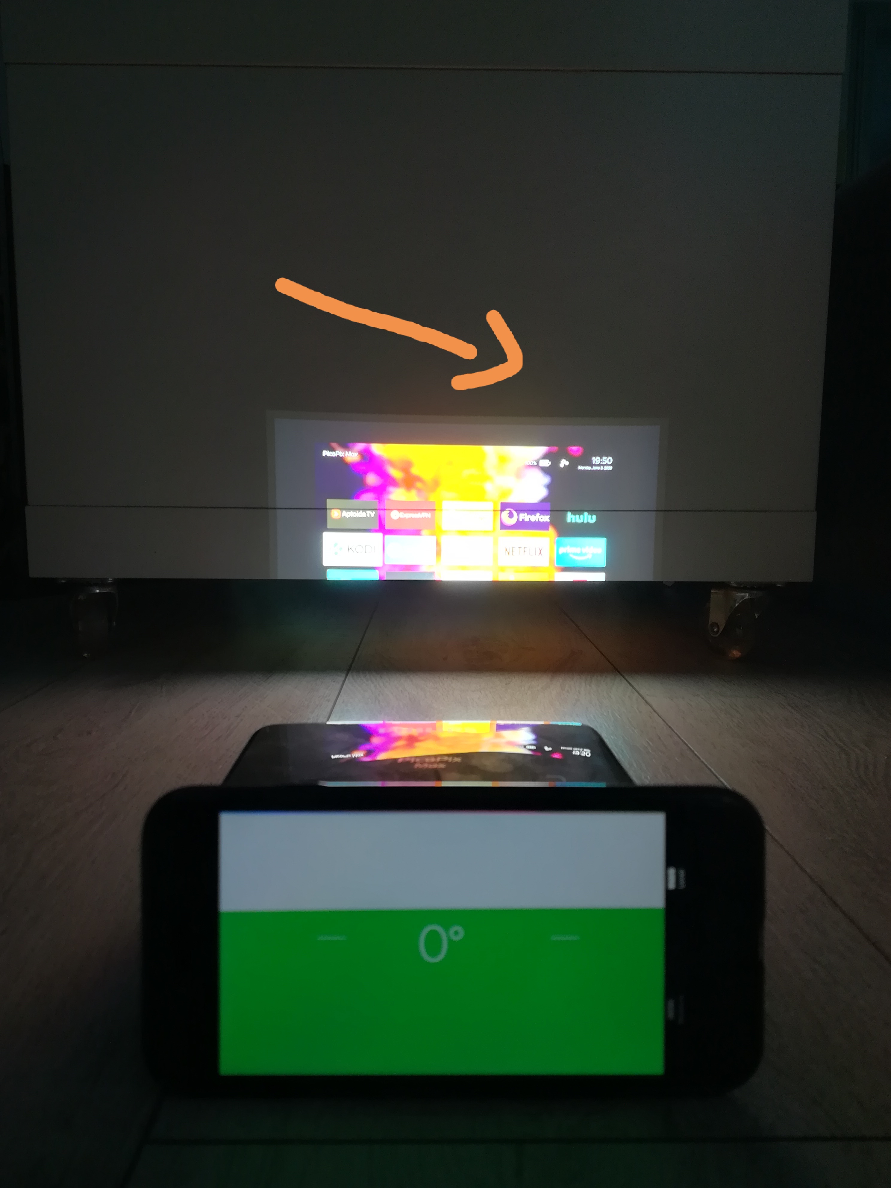

I tested this on the floor and used calibration
And it always set the right corner of the image little bit higher why is that ?

Are you projecting on to a screen or wall?

Can u post an image of the projector and the projected screen?

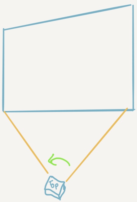

Is it actually bending (ie. curved) or is the projection just not 100% straight? The reason I’m asking is that having it rest completely flat on a surface isn’t necessarily enough to achieve a straight picture. The projector is very sensitive when it comes to positioning and having it positioned at even a slight angle in relation to the surface that is being projected on can result in a picture that is not 100% straight. On the other hand, if the side of the picture is bent or warped, it might be something else.
I think is really the straight the problem. Managed to took a picture projecting on a very close surface so when far the effet is more pronounced
The fact that the PPX is on a level surface and itself level also, doesn’t guarantee a good projection, it also has to be perfectly perpendicular to the screen.
Also if you’re projecting on to a wall, check how flat the wall is, on 1 of my walls I get a lower right hand corner always at the exact spot, after checking with a straight edge I noticed there is a kink in that section of the wall not noticeable normally to the eye but enough to distort the straight line of the bottom of the projected image.
