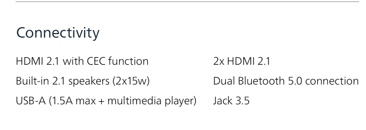

Unfortunately not we have only ARC.
You can get DOlby Digital 5.1 but not ATMOS.

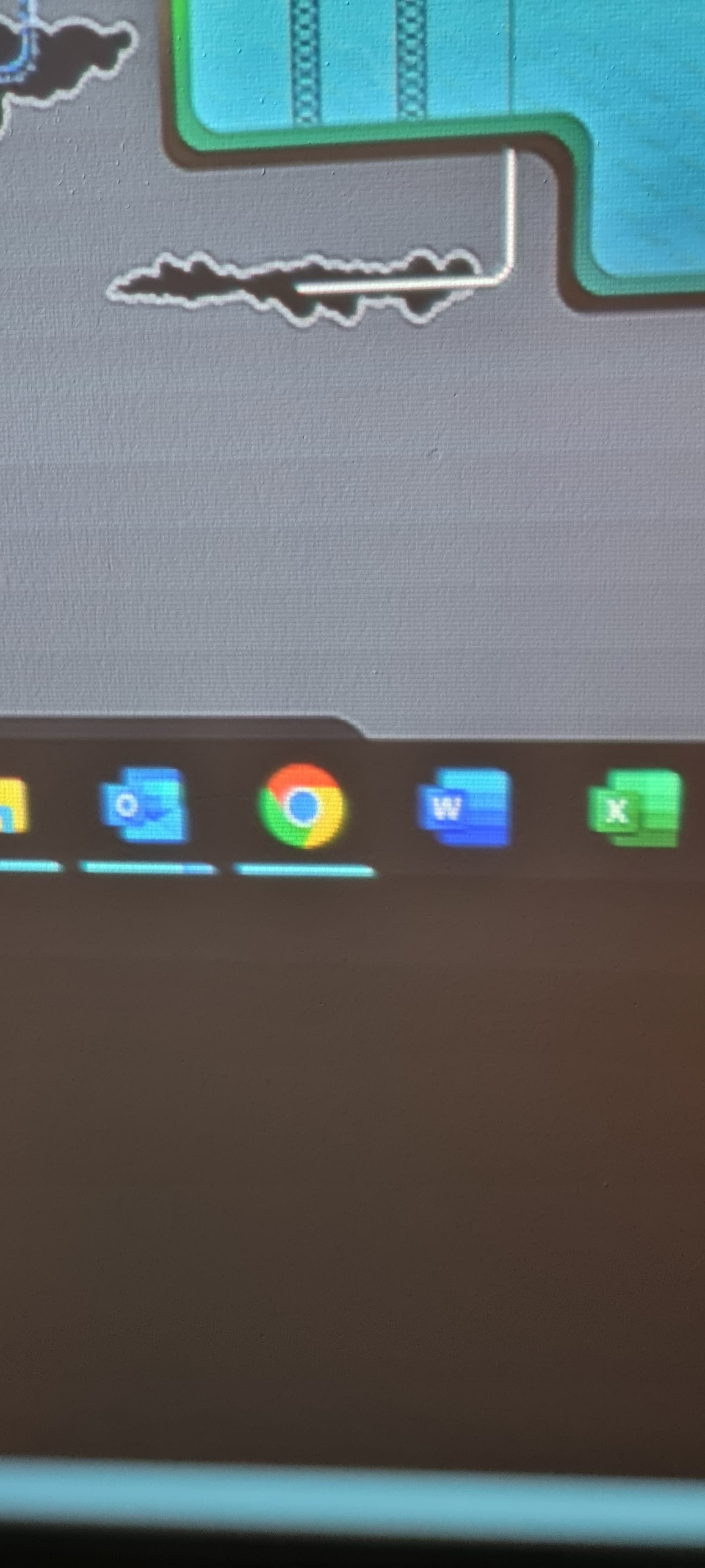

I just received my U4 projector yesterday and was quite unimpressed vs. my PicoPix Max and it is just now laying on my table unplugged after spending 4 hrs last night trying to find a good use for it in multiple settings around my apartment.

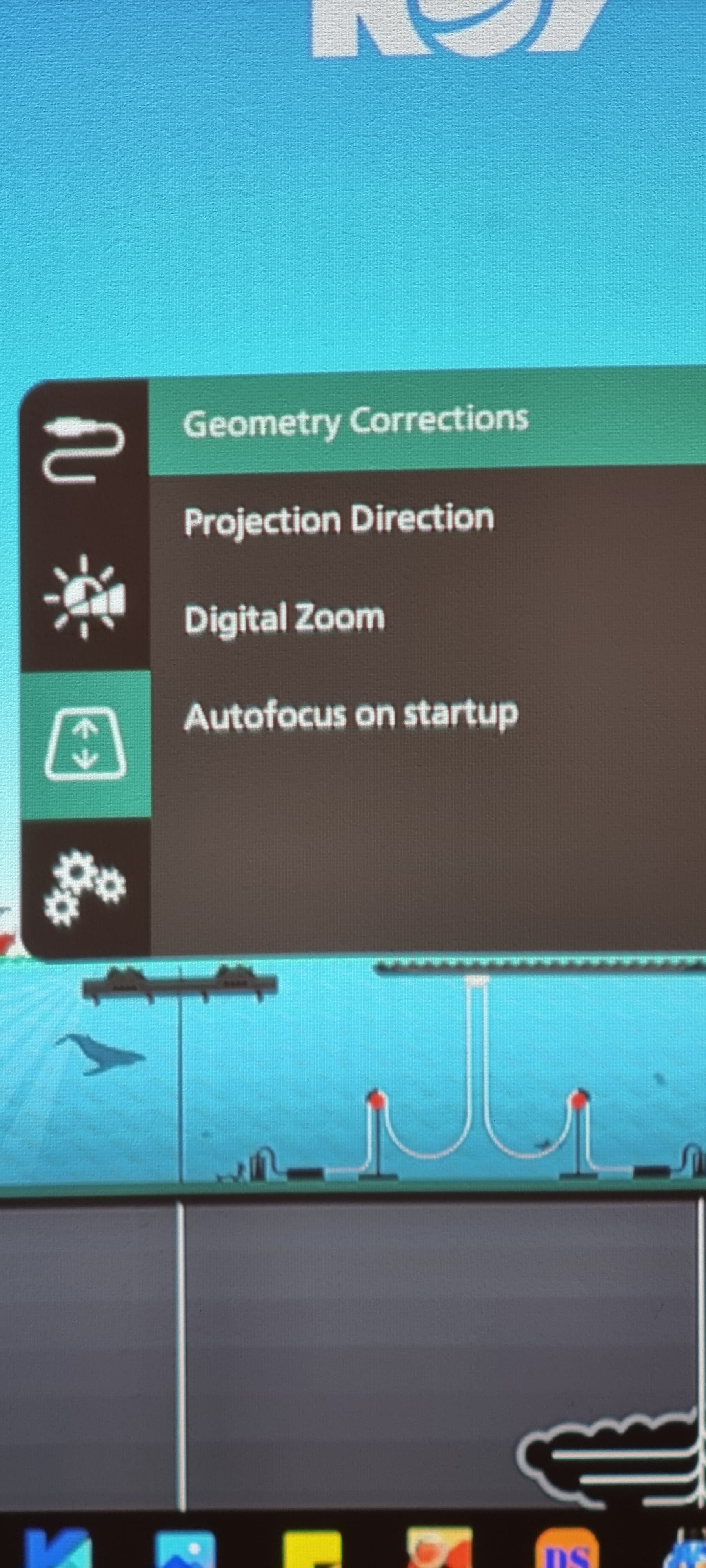

The screen clarity was fuzzy even after auto focus, and auto keystone always resulted in a trapezoidal image or an error message that keystone is out of range even with a small angle from straight. Even when adjusting keystone manually I couldn’t seem to get a good image.

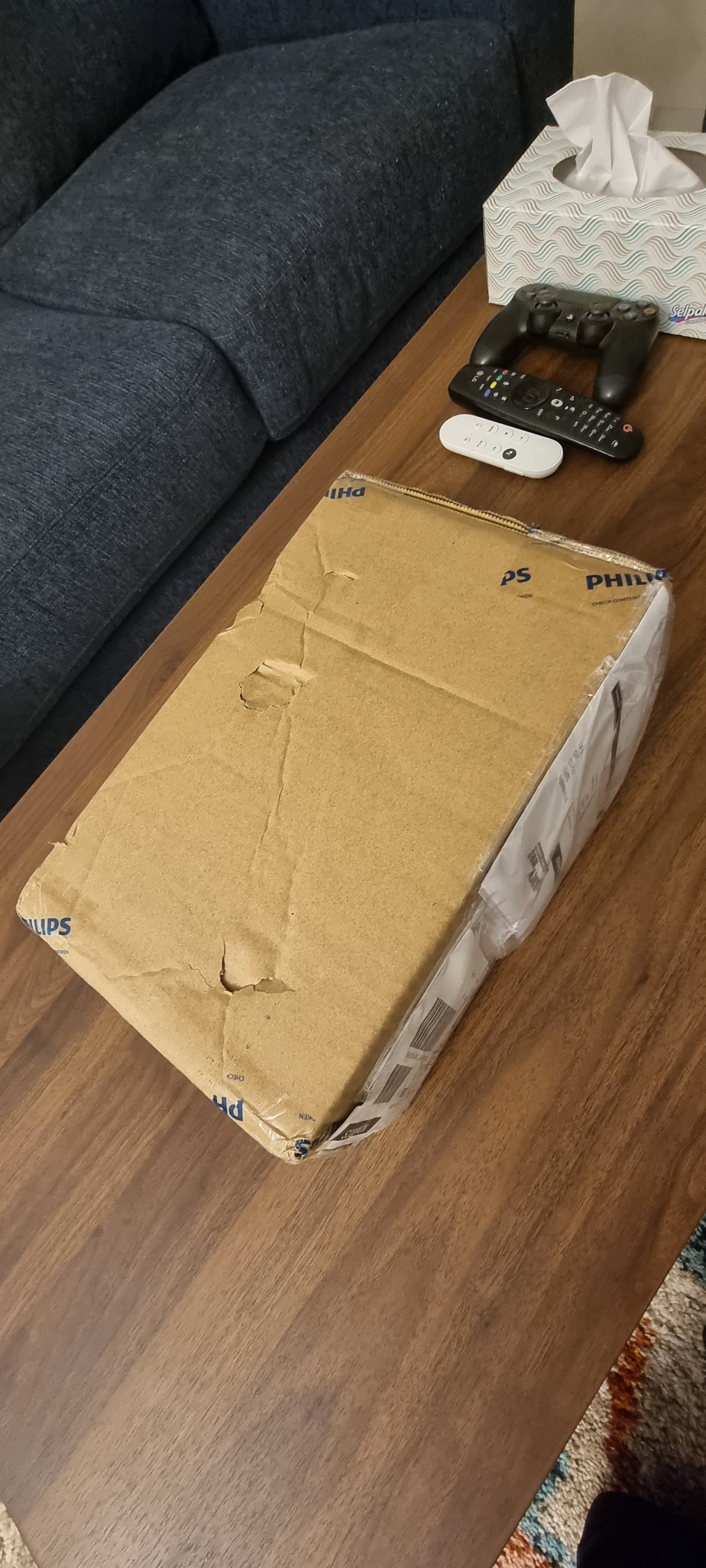

I also saw the carton having some dents on it when delivered, I dont know if this has damaged my device internally somehow and that is the cause of the poor image produced or if that’s how it’s supposed to be (no signs of damage on the device itself, only on the external carton). I felt I am not getting the same clarity I saw in review videos you have posted on YouTube.

Hi Support, I don’t get this regarding U4: in IDGG, you stated it’s HDMI 2.1, so it should be eARC and then support Atmos?

Concerning the image, a projection from the bottom of the wall is different from the front. If your wall as the smallest imperfection, the light will reflect on it and unfortunately you will get a fuzzy image
Hello, there is just ARC, not eARC as stated in our page.

Regarding the image, it is definitely not clear on the edges and only somewhat sharp in the center of the image. I spent hours trying multiple things with no luck - also the image is warped and I cant get it straight without manually adjust keystone (and even then the image edges are a bit rounded).
