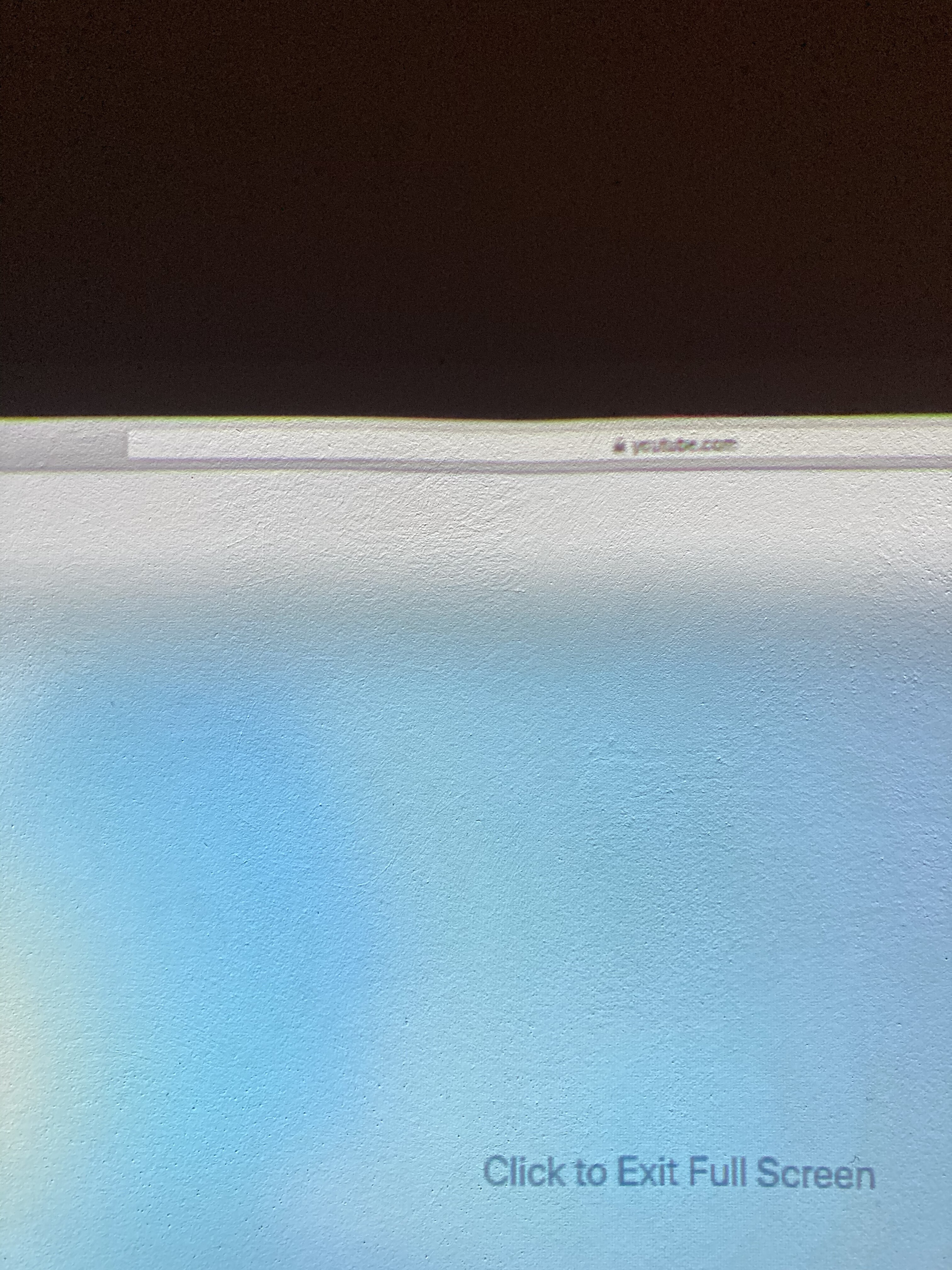

The top middle of the projection has recently become distorted with an upward bulge in it. Does anyone else have this? Any solutions?

I am also have the same issues. Top of my screen warping.
Yep, I have this problem as well. Thanks to @TomaszG advice on how to use manual focus I was able to get the image to be quite watchable but the top of the image is warped in the middle, which is far from ideal.
Same here, the frame is not only warped, but also distorted and segmented in many points.

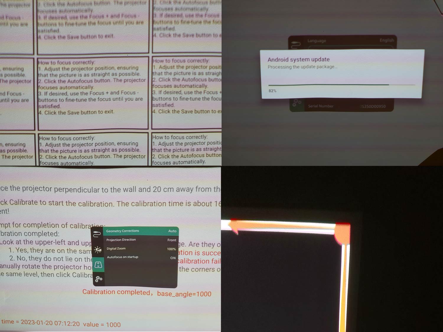

I’ve carreid out the following:
  • automatic calibration, geometry adjustment and focus adjustment
  • manual calibration, geometry adjustment and focus adjustment
  • followed the instruction on both the manual and the projected ones (inc. manually rotating the projector box, as suggested)
  • I’ve updated the firware to the latest vers. 1.7.0
None of the above worked, so I wonder if it is about a hardvare or lens problem.

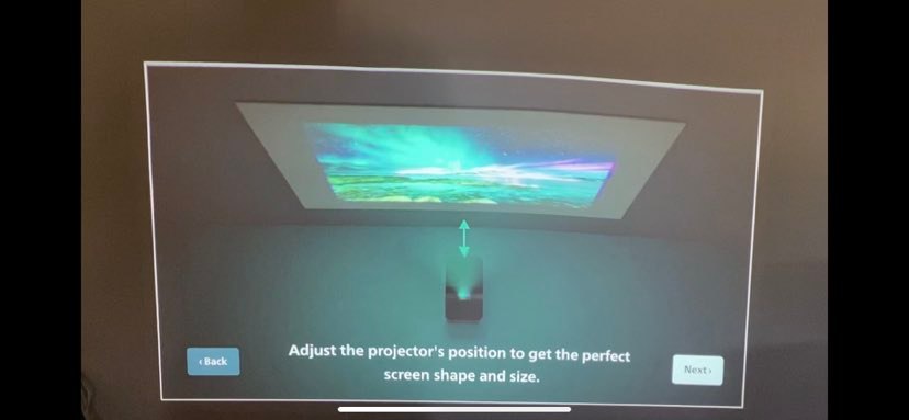

The customer support was very quick to reply per email:
Could we please ask you to send us a video of the following:
  • To determine if the warped image is a result of the projector itself or the wall on which it is being projected to
  • Please remove all HDMI devices from the projector
  • Go into the calibration settings (9 Text Boxes)
  • Move the projector laterally (perpendicular to the wall) from the left to the right
  • If the warped part stays fixated, the wall is warped, in this case, could we please ask you to try another surface
  • If the warped part follows the projector, the projector is malfunctioning
