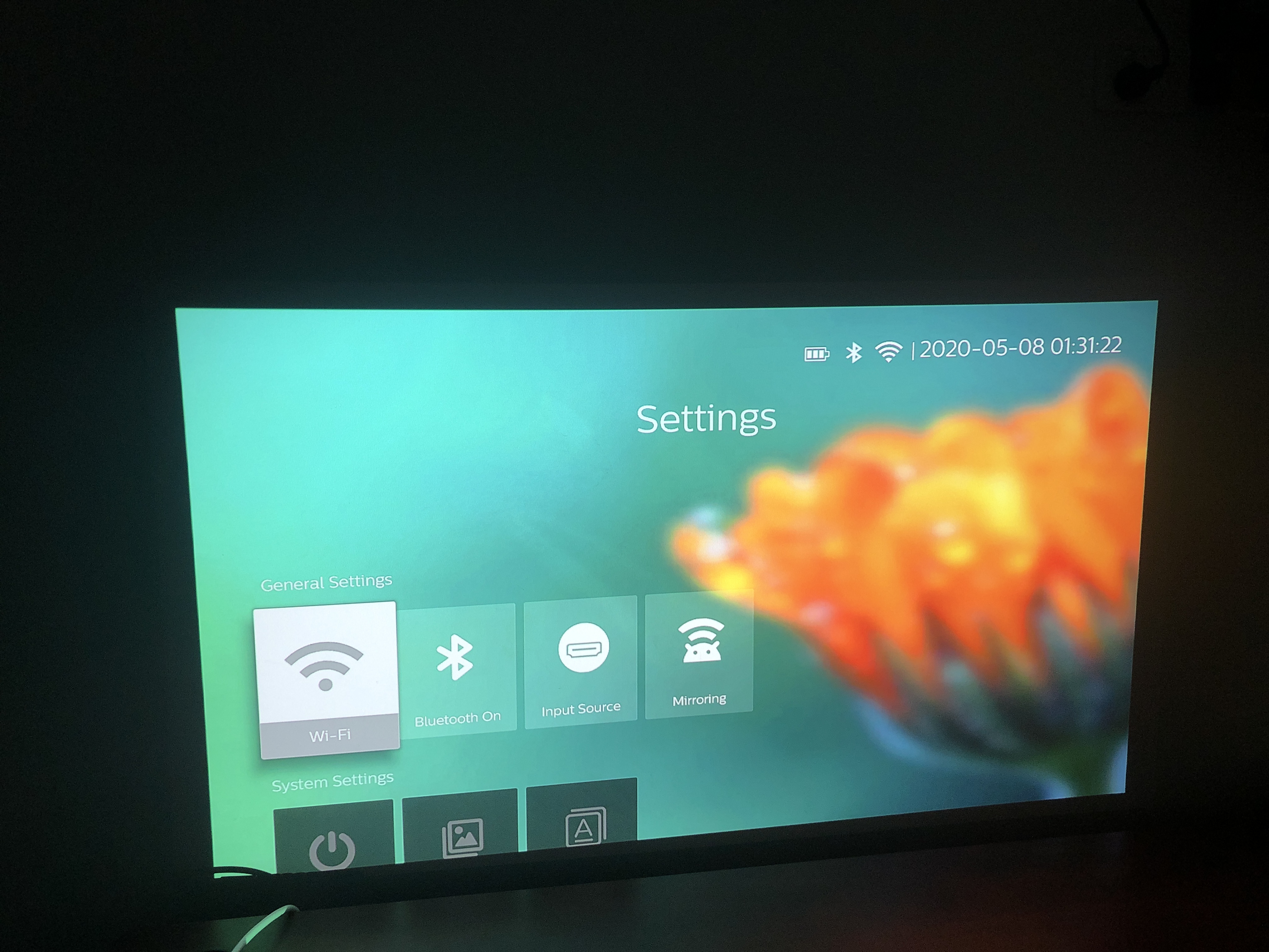

It seems like the extended settings menu has a bug in the date and time format @IvoGrijt @Philips_Support_P
Just to mention i also have selected 24HR timing format which is not working
I have updated to latest FW version

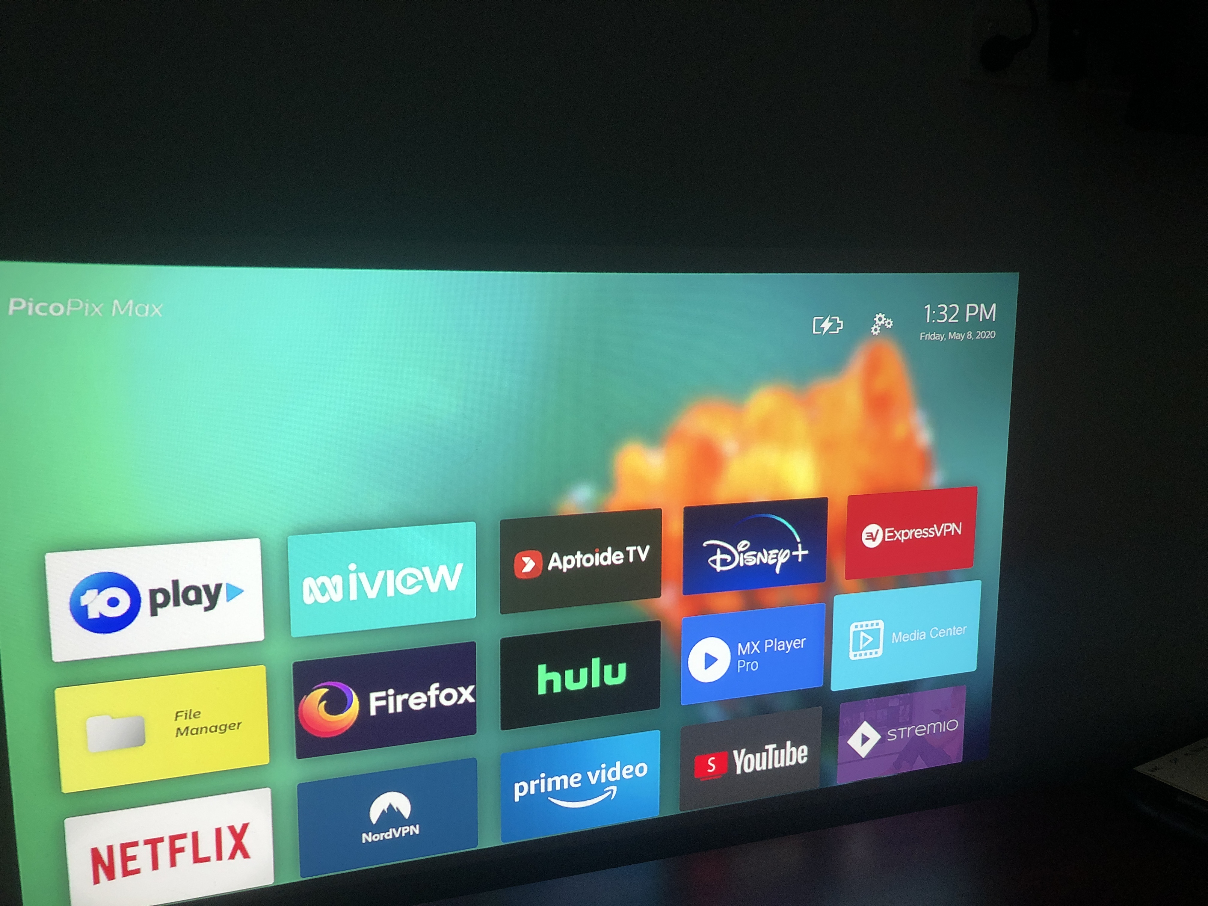

I uninstalled Netflix and now have a little box in the icon, but when I click it, nothing happens. If I hit options, all I have is open, but that does nothing.
I also uninstalled MX Player but there was no placeholder, so I got a copy from Aptoide.

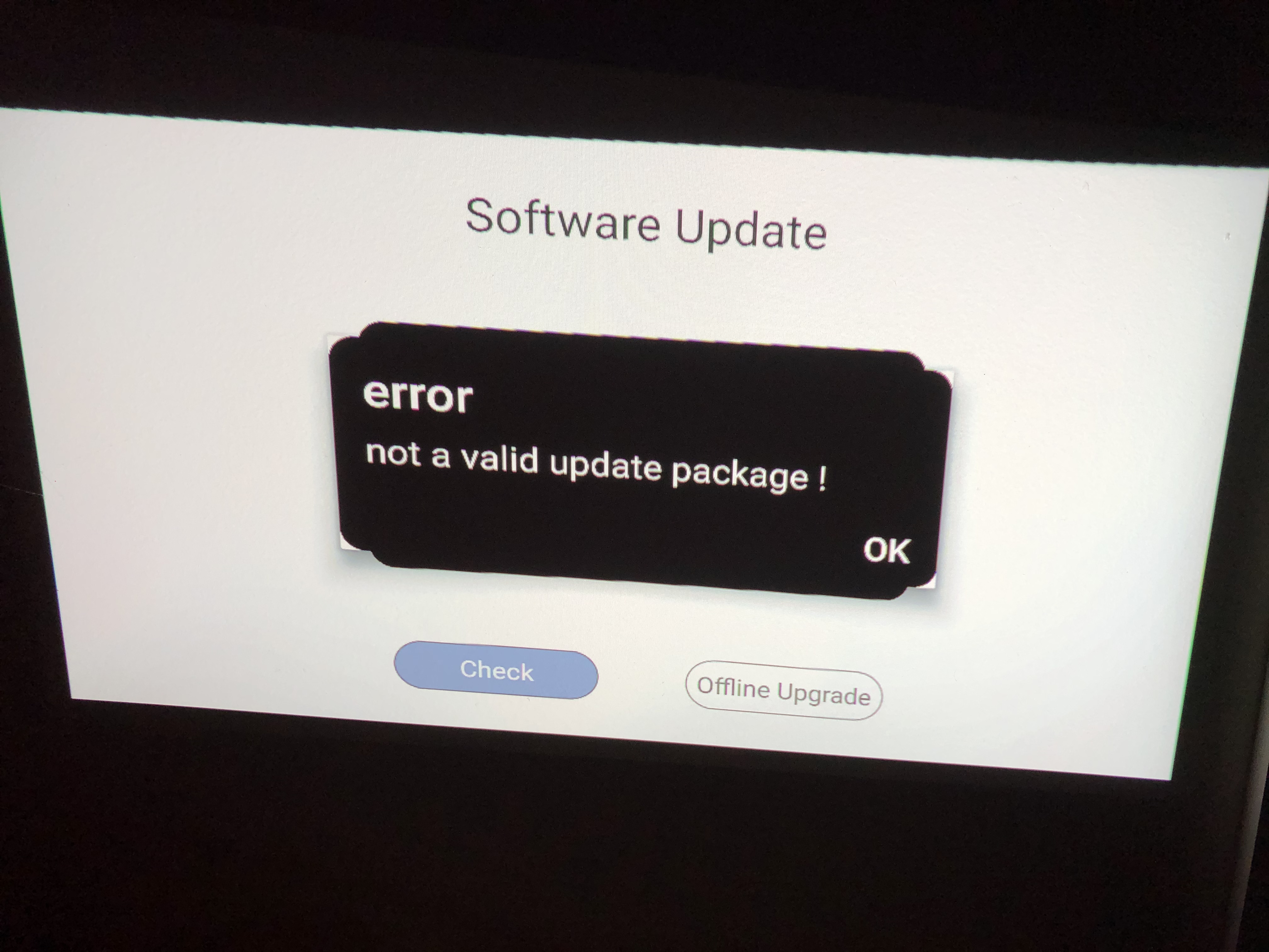

Update not working for me. I am currently on version 1.0.27. When trying to download the update, I get ā€œerror - not a valid update packageā€.
Anyone else having this issue?
I got same messages, but I restarted projector couple of times and tried again. Finally it worked. Problem might be that too many people are upgrading same time. Just try again it will work eventually.
Hello @Dedohamdy sorry to hear that. I am talking with my team to find a solution for you. I will get back to you later today with instructions.
Thanks @Hmk69… did a restart, tried again and waited a while… then noticed it wasn’t even starting to download, so clicked retry and it’s now downloading. :slight_smile:

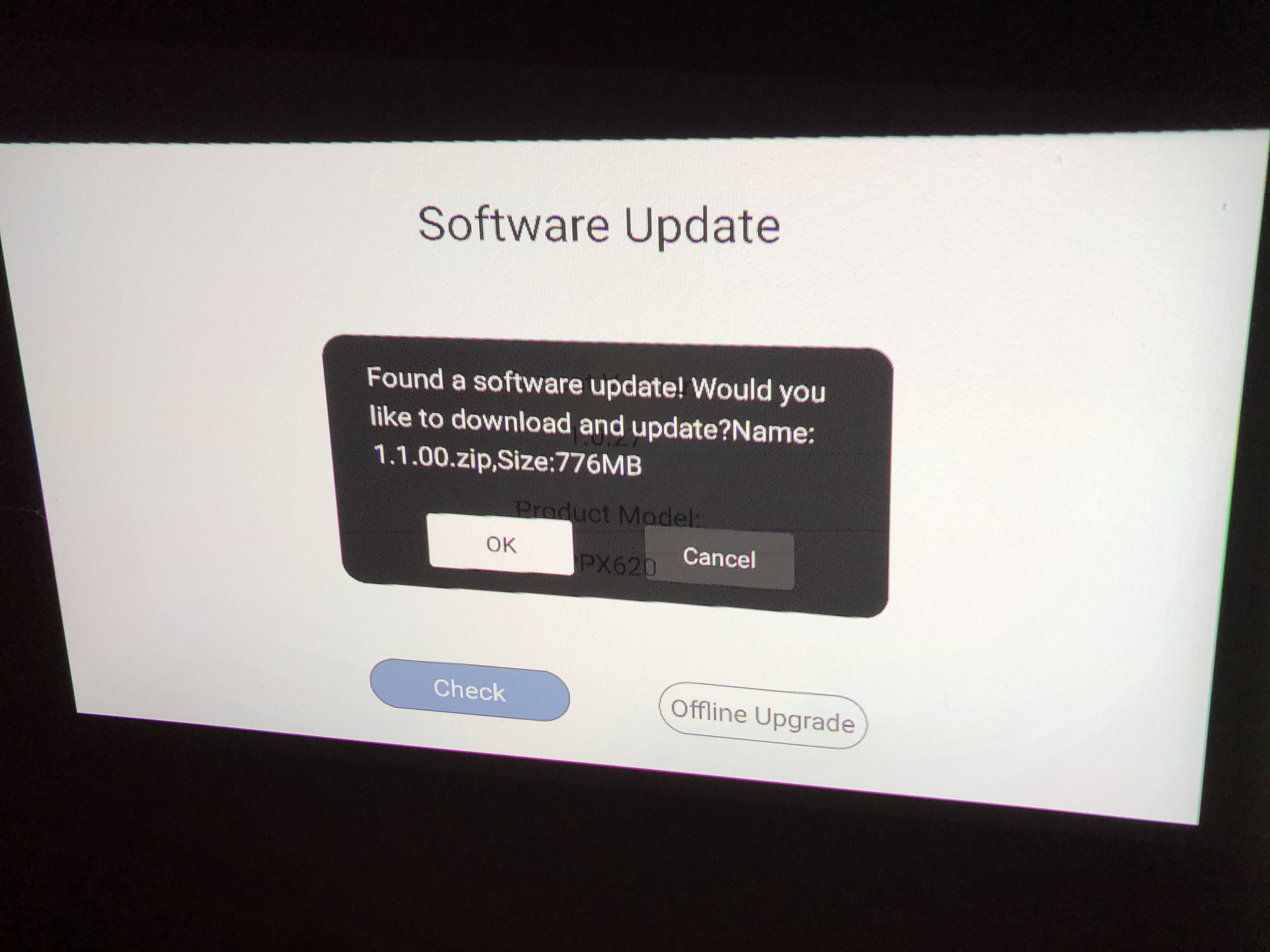

Yes, this is a high priority project in our team. The existing update infrastructure was designed for a lower volume product, it’s not able to handle the unexpected load of 15k simultaneous downloads. Luckily there is no technical roadblock in solving it, and it will be improved hopefully from n+2 update onwards.

Settings app is another team than @Philips_Support_P but the Date/time format behavior will be fixed soon.
