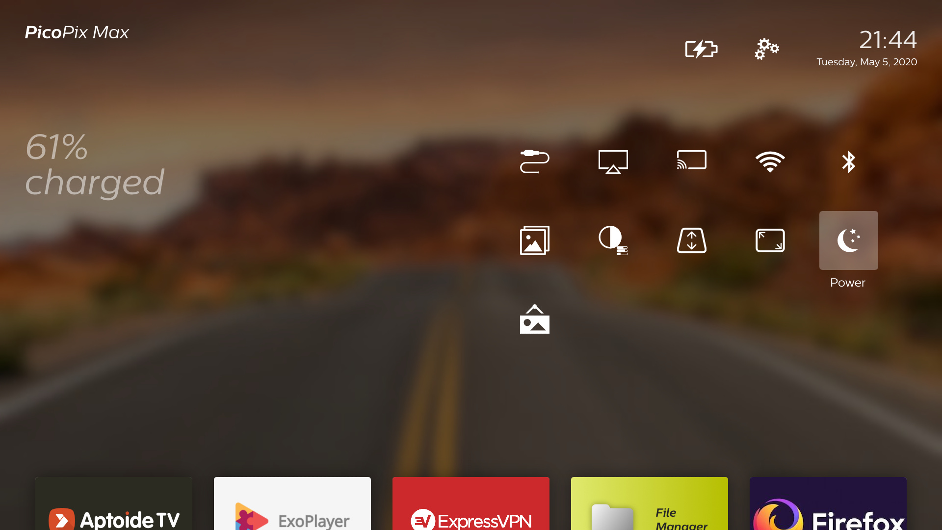

Improved launcher
The launcher has received a facelift and some often-requested features and bugfixes:
Improvements
  • Shortcuts for common settings (go up from the apps list)
  • Battery percentage display when charging
  • Battery time remaining display when discharging
  • You can now switch to 24-hour time format (click the clock)
  • File Manager is now a full app shown in the apps list

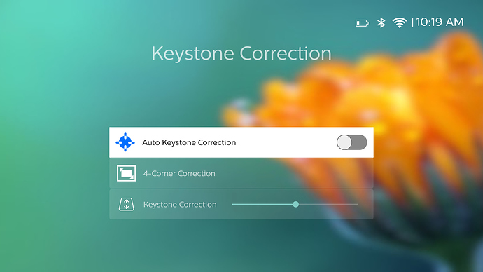

Manual keystone correction
This was an often-requested feature for some specific setups like projecting on a tilted rooftop. We have added manual keystone correction to this update. Just turn off the automatic one and then set it manually yourself.

The main reason for bad graphics performance is the 4-corner correction feature which is very GPU intensive. Although most apps still work OK, Kodi is an exception because it uses 3 separate hardware overlays on top of the video. Other apps use perhaps 1.
After months of negotiation and technical discussion, we can present only one solution to run Kodi at 1080p with great performance: disable 4-corner correction if you need to extract the last level of performance out of the GPU. Together with an update to the HW compositor policy, this ā€˜solves’ the problem.
In our testing there is a massive visible improvement in GPU performance. The UI becomes completely fluid and animations run at close to 60 fps. It must be mentioned that other similar devices which run Kodi perfectly do not have a GPU-intensive geometry processing applied on top! But the silver lining is that all apps will benefit from this performance boost.
How to activate
Please go to the Keystone Correction settings and turn Automatic Keystone Correction ON. If it was already on, first turn it OFF, then back ON. You only need to do this once. Afterwards you’ll immediately notice better performance.
This will disable 4-corner-correction, if you need to use this feature, the graphics performance will be back to what it was on 1.0.x versions.

One more question, can I turn off automatic keystone correction and still disable 4 corner correction and does having a better performance?
Thanks for all the work by the way! :smiley:
Wish for it with all your heart, it will appear.
One or the other will always be active right now. Later we’ll make it so you can disable all corrections entirely.
