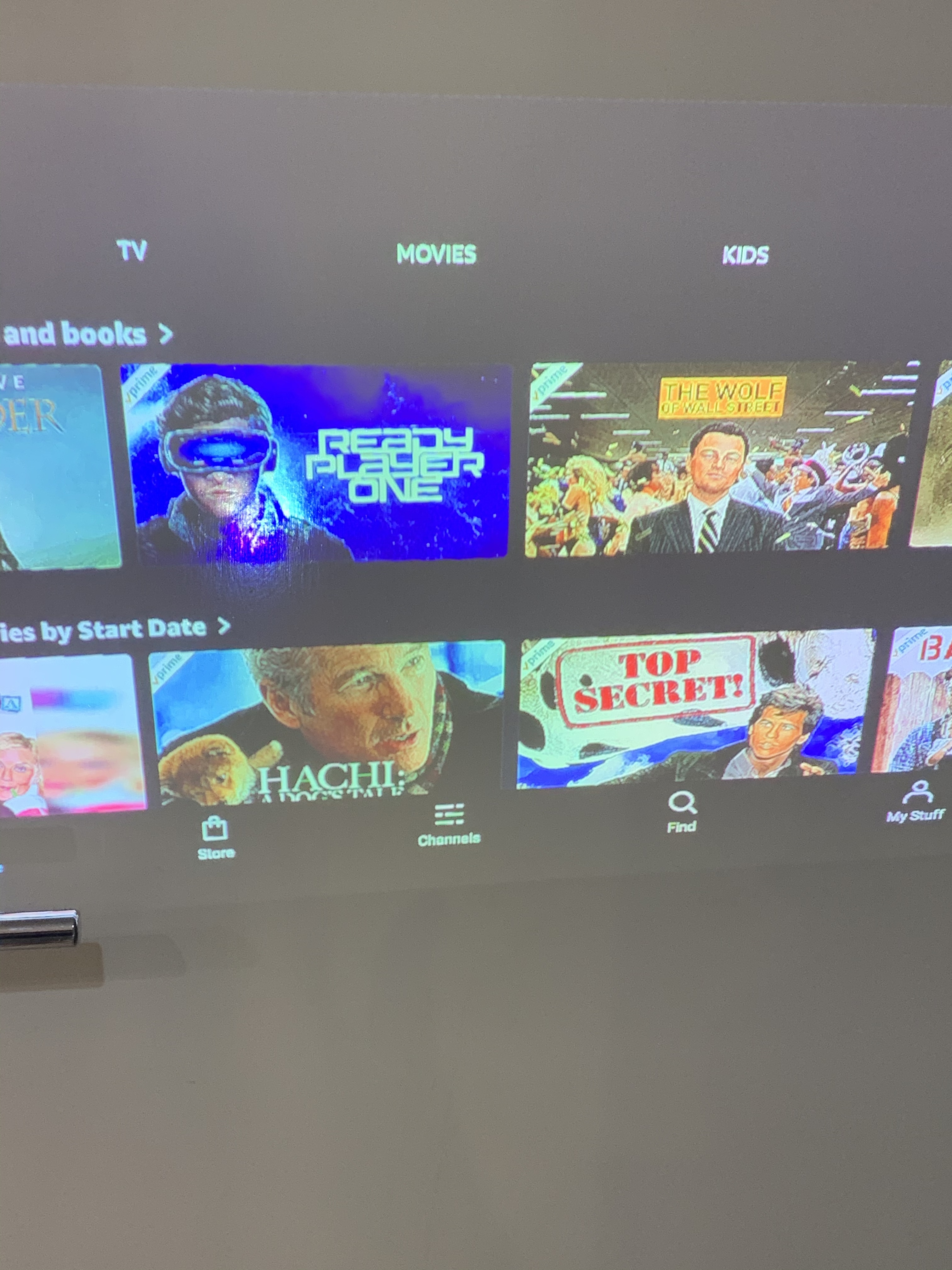

Hey is there a problem with Amazon Prime Video it will not load since the new update also the quality of Prime and Netflix front end is really bad image quality is very poor not vivid anymore also the automatic software update took 10 attemps to get it to work I hope they fix the issues very soon

What version of Netflix and Amazon Prime are you running exactly?

Hey version 3.0.270
As you can see the home page is very poor quality the film images not very clear Netflix is like that on the home page of app also the remote is terrible the range is shocking you have to be right next to the projector

I updated Amazon Prime to version 3.0.270 build 48947 just now, running smoothly.
The Netflix version should not be updated, at version 4.16.3 build 15172
Can you post a landscape oriented pic of the following:
  1. PPM home screen,
  2. Netflix movie selection page
  3. Netflix while playing a movie
  4. Amazon Prime movie selection page
  5. Amazon Prime while playing a movie
