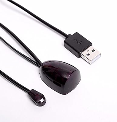

Maybe an IR-extender could be a solution for your situation.
For example:

The alternative is of course a more powerful IR blaster.
Thanks for your replies. I ordered the IR-extender but have not received it yet. In the meantime using a window to reflect it seems to work ok. Mostly I have to switch in on a couple of times.
