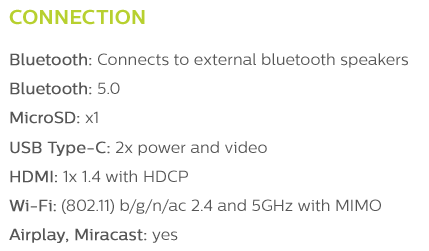

I think it should be mentioned here, in the connection specifications:
Somehting like “2x power and video (HDMI alt-mode)”
