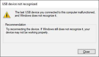

Now, I’ve just tested with an iPad Pro, and it works on it. So there is an known issue on MBP16, and a new issue on Dell Latitude 7390. The 2 only laptops I use :frowning:
Here is the error I get on the Latitude 7390 on W10E 1809:
PPM_USBC_Error
I know it’s a half-solution, but while waiting for a lasting solution you can use as a workaround an adapter USB-C/HDMI, as said by @trappm in the same thread :
