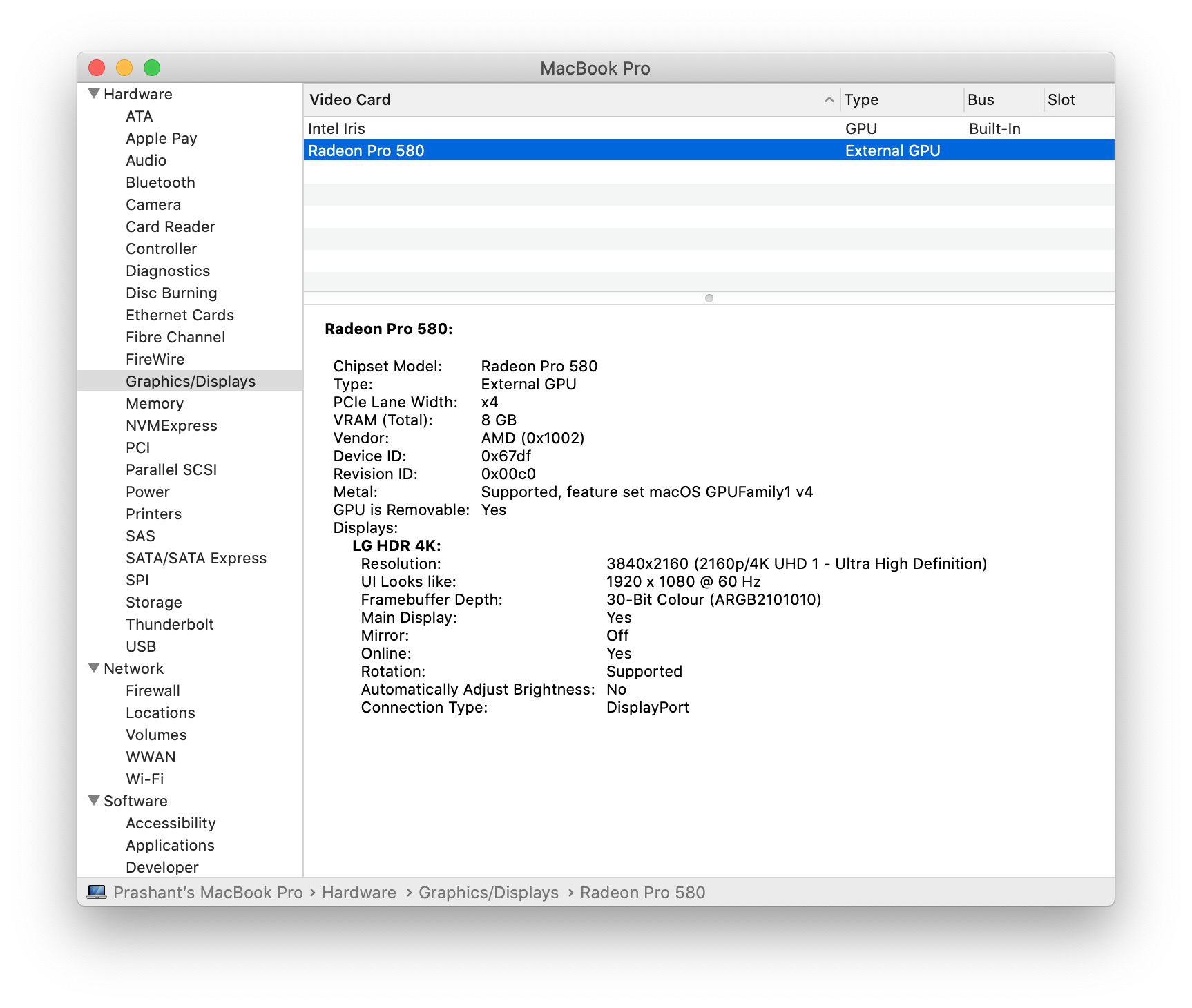

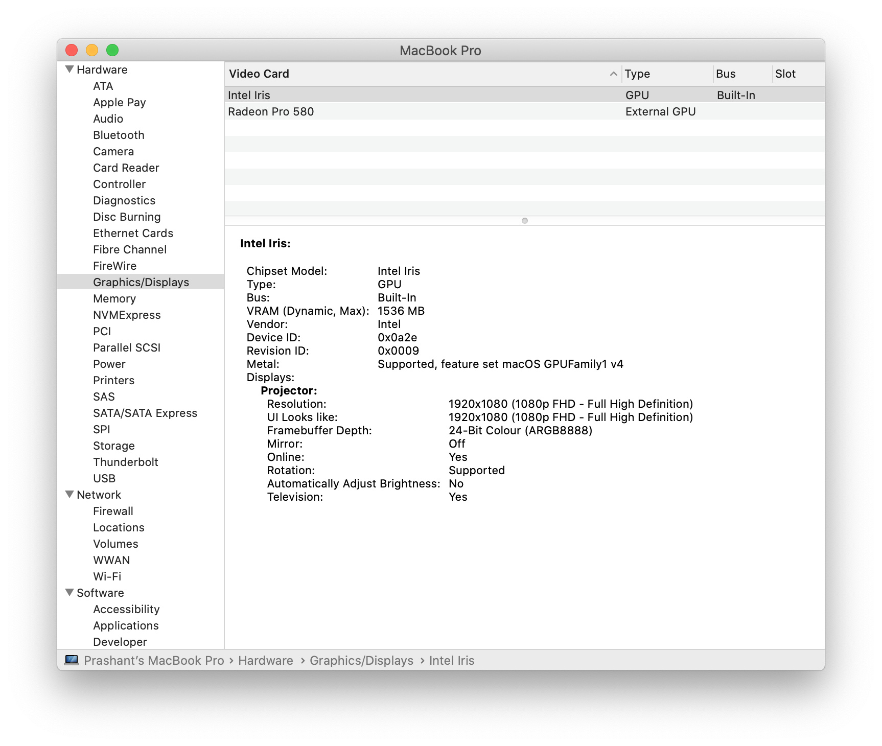

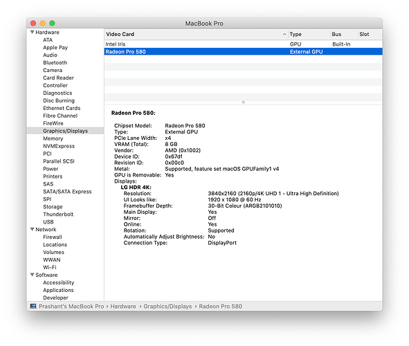

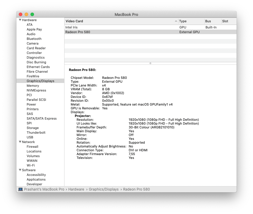

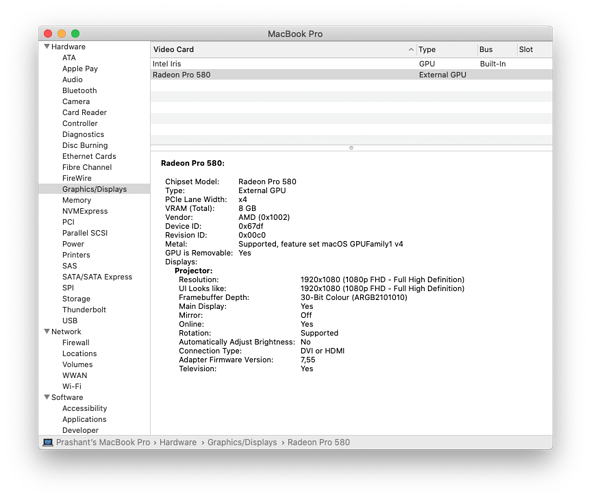

Correct, it should show DVI or HDMI for connection type.
PicoPix Max connected via USB-C:

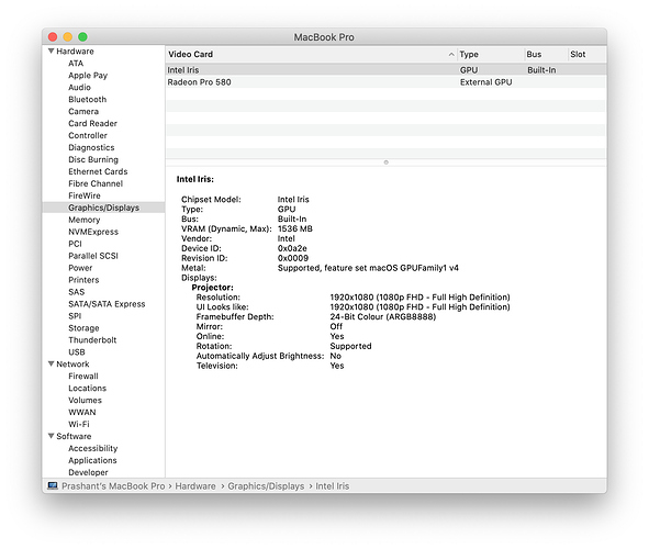

For comparison, PicoPix Max connected via HDMI cable:
And a regular 4K monitor connected via USB-C in DP mode:
That makes sense, youāre not getting any āConnection Typeā listed for the HDMI ports.
Did someone run out of imagination naming the device āProjectorā in the EDID?

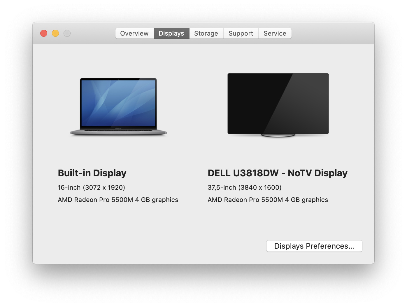

It does not list the Projector. It only refers to the internal LCD display.
OK, that means that it hasnāt successfully negotiated any video alt-mode, Iām curious how macOS was able to detect a display but not showing it in the systems reportā¦

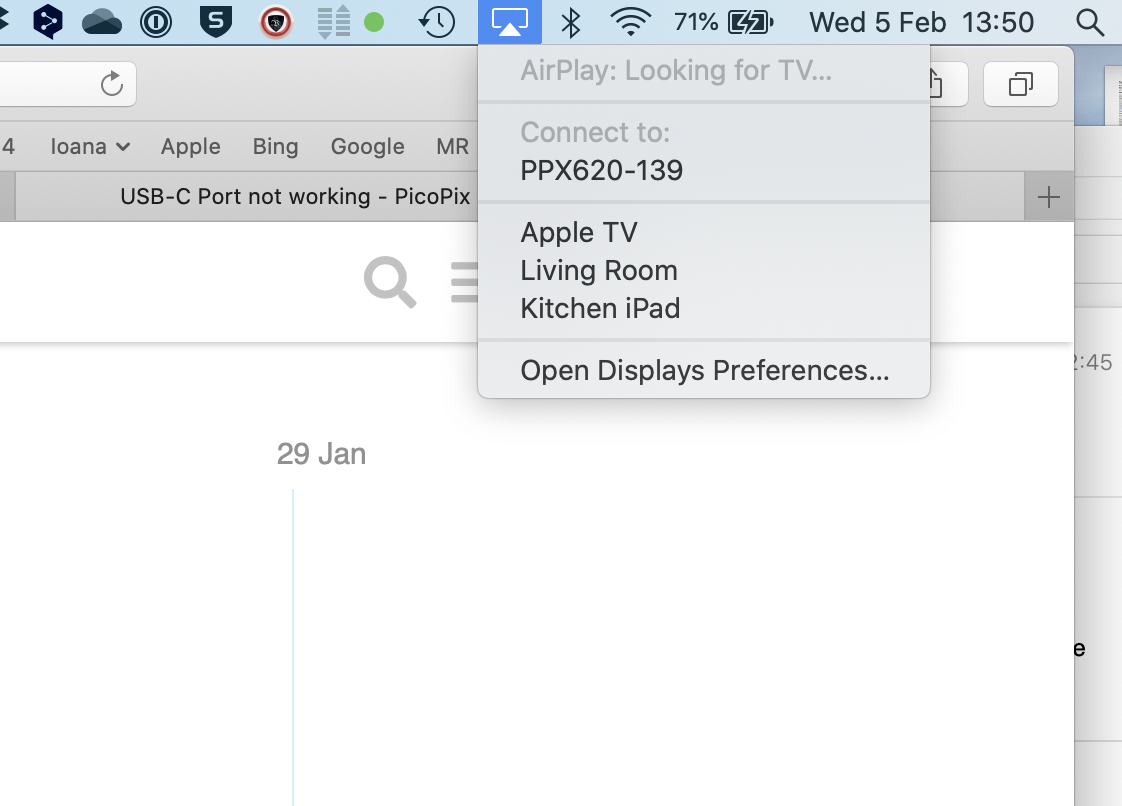

Well, perhaps I have misunderstood. I see the projector listed as a connection option under the AirPlay icon in the menubar. But I guess it is seeing the projector over the wifi, not the cable.

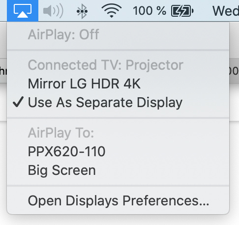

Yes it should just work on plugging it in. It should show up as Projector in the airplay menu when connected by cable. The name over wifi is PPX620-nnn with some 3 digit number.
What do you see in that menu after plugging it in?
What do you see in System Information? (option-click the apple logo on top left, then go to Graphics section)
I see the following. Systems information only shows the built-in display - projector is not mentioned
