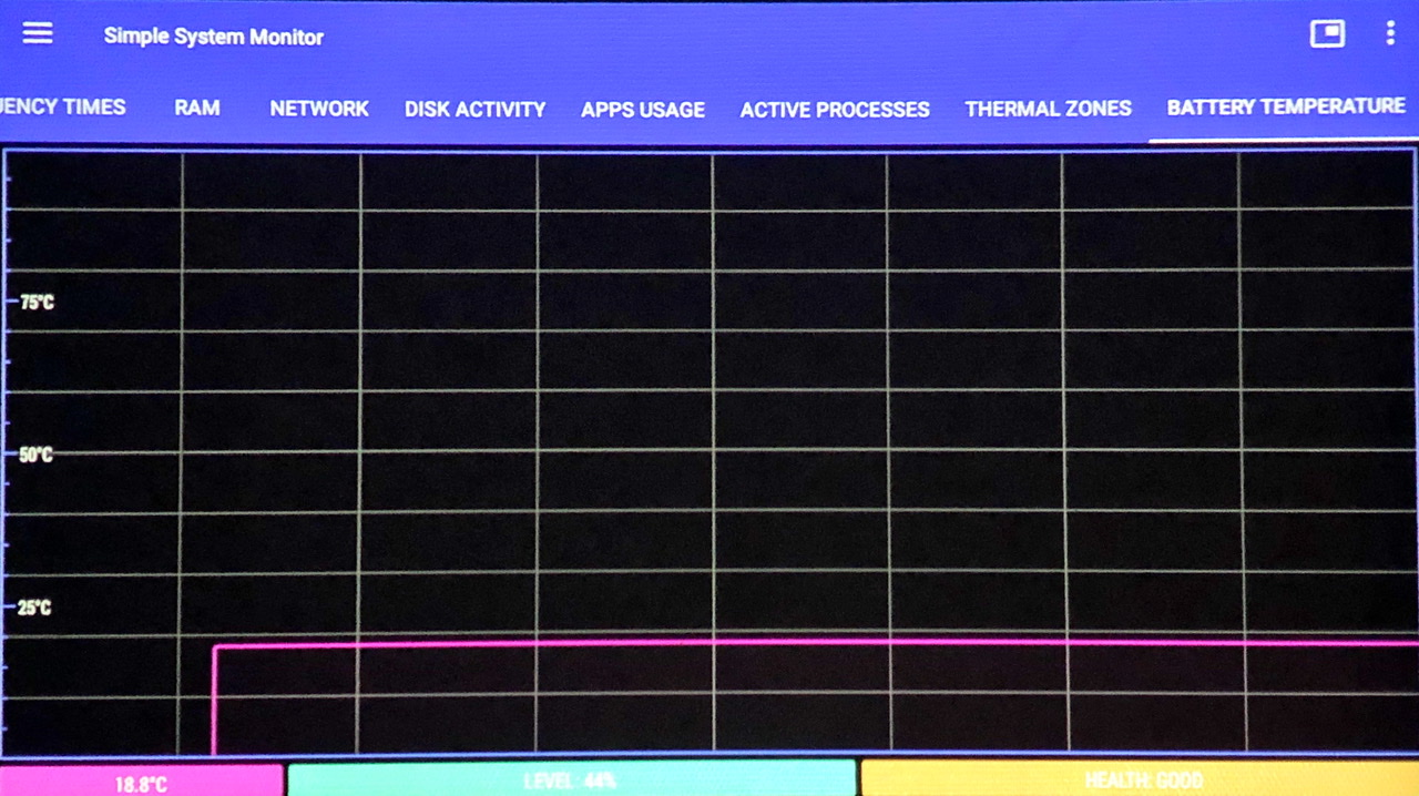

Hi, is there any way to display the temperature of the light engine ? Eco mode is indeed soo quiet, that I was doubtging that any cooling effect is applied to the light engine in eco mode :slight_smile: More tests to come…If cooling is still sufficient, that is really cool. Was not expecting such a low noise level.
I’ve only found a way to show the battery temp via an app. But it still shows 18.8°C with the new firmware.

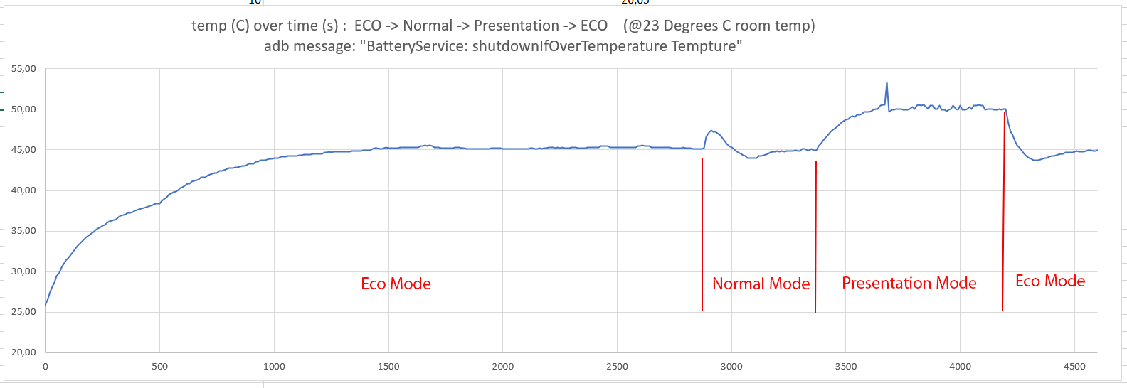

If you know how to setup adb, you can do adb logcat | grep Tempture (yes, misspelt).
Hi, Interesting stuff, I got adb to work. - Hope I catched the correct adb message. Find my measurements below :
Where is the temperature sensor that is creating this values located ? - It’s not the battery temperature sensor, right ?
I find the fan reacting quite fast to changing temperatures / modes. From presentation to eco mode it took around 1 min in order to spin completely down again.
The temperature sensor is an internal one, I don’t know whether it’s readable by any off-the-shelf programs. I’ll check.
Thanks for building this graph, and thanks @IvoGrijt for measuring the noise level. It’s exactly the kind of detail we’re looking for.
It seems it’s working as expected, the temperature targets are being maintained. More testing is always welcome!
