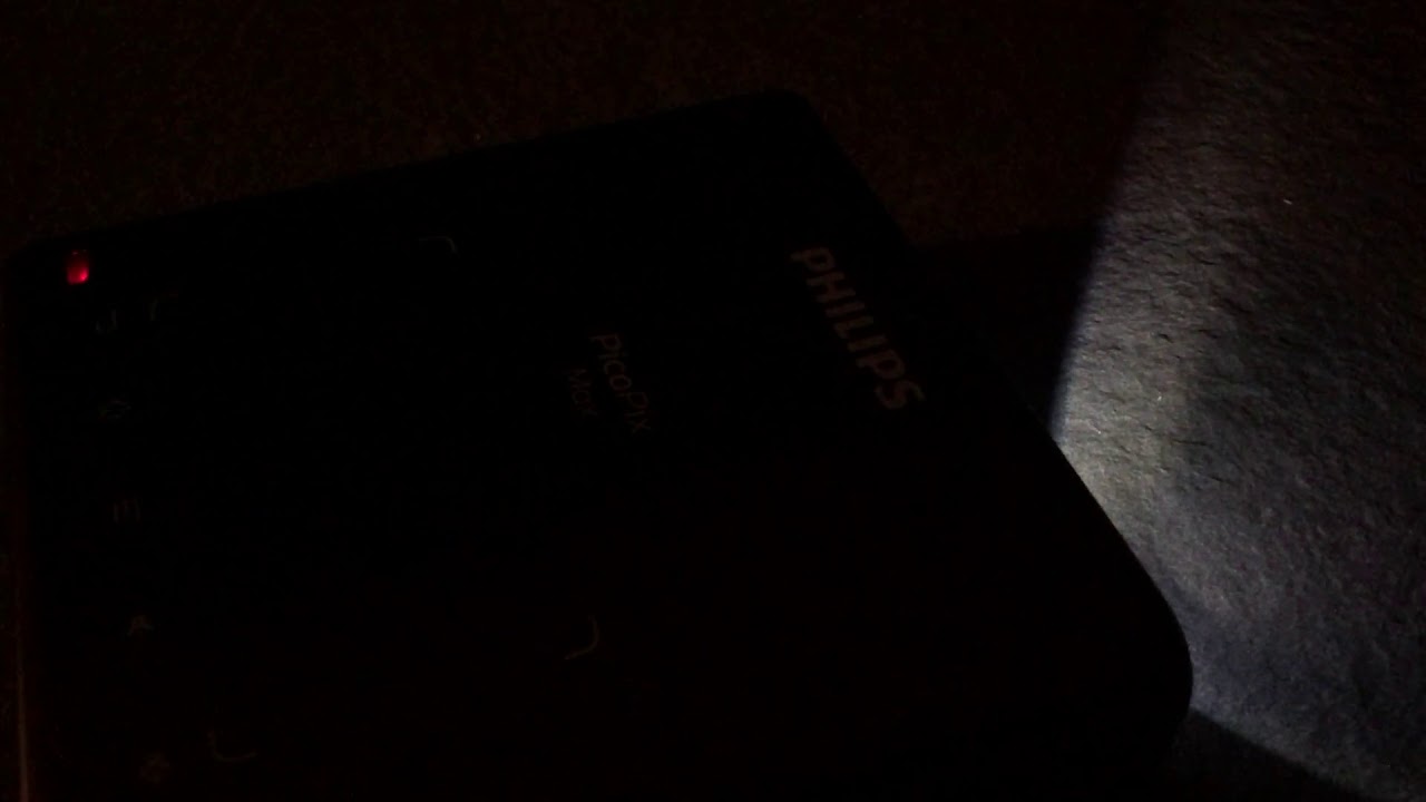

Remember when I posted this:
Turns out it wasnāt the fan, but the light engine.
Iāve tested with both chargers I have, the 15V4A capable PPM standard and another one thatās 15V3A capable, with the same results.
Edit (2:45AM): The noise is gone, unplugging and replugging the power cable no longer has an effect. Difference: the battery is now full charged.
So I now think it might be a combination of the light engine going brighter, and the battery charging. Iāll try some more settings and at a lower battery level again tomorrow to verify or repudiate these findings.
Edit (2:55AM): I was using wired headphones while watching a movie after my initial testing, and when I paused the movie to write the 2:45 edit, I noticed afterwards that there was a hum in the headphones. I unplugged the headphones, et voilĆ”! the noise was back. Plug them in, noise gone. So it seems to be a grounding or some other electrical whining that is picked up by the audio system, and being output by the speakers or the headphone jack (system volume does not affect the sound level of the noise). In the headphones as well as the speakers the sound only happens when plugged in, charge level and status do not have an effect on the noise, contrary to what I thought before.
