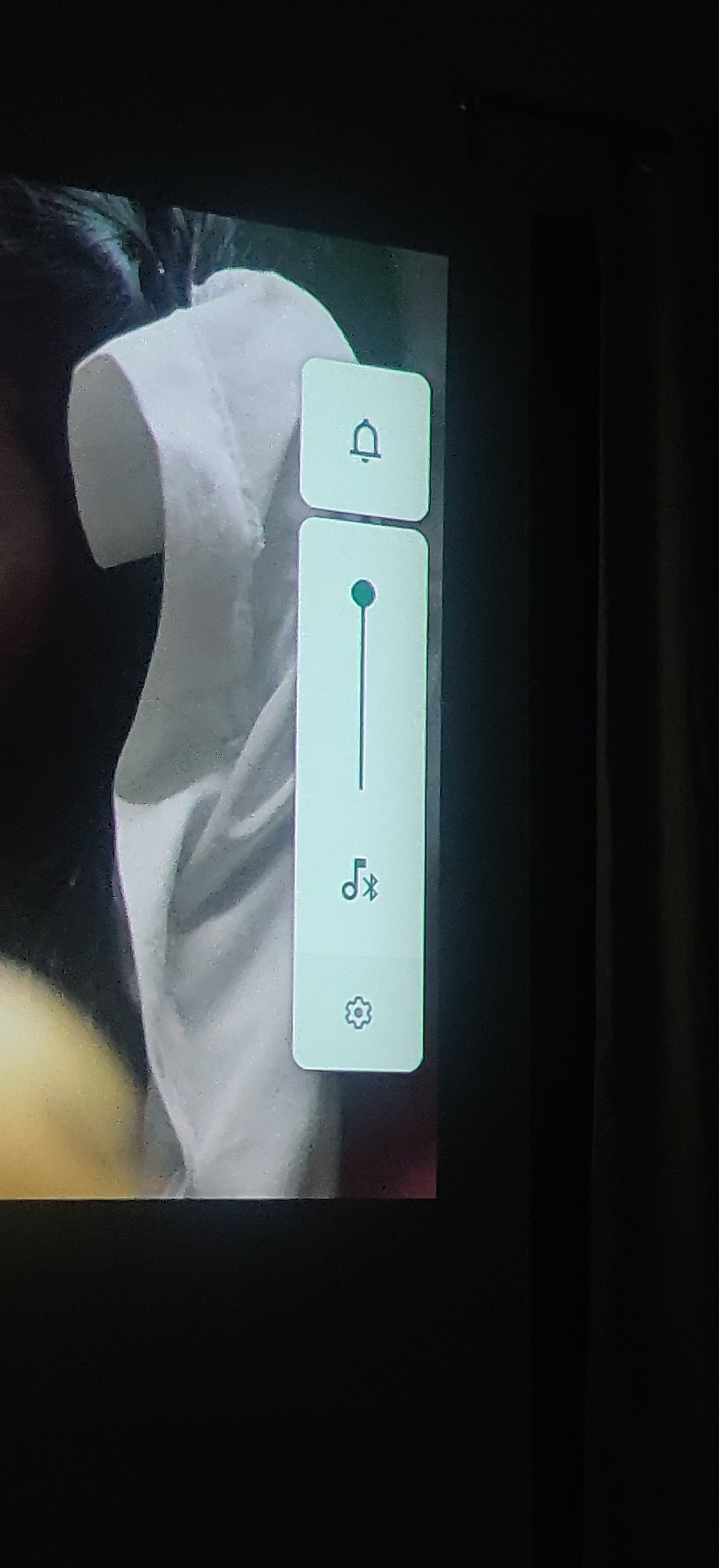

I just received my Picopix and by the third time I used it there seems to be a volume bar issue, which doesn’t disappear from the screen. It s extremely annoying. Pls help.

I would recommend you pay close attention to the remote when you see this behavior. I bet you will see the light blinking on it even though you’re not pressing it yourself. I’ve had many remotes have a stuck key which leads to all sorts of ghost issues.

I still haven’t been able to resolve this. Happens very frequently, including on the home screen before launching any apps, so not app related. As well as displaying the volume control constantly it also sets the volume to max. I’ve tried removing the batteries from the remote so it isn’t an issue with a sticky key on the remote.

Haven’t seen it again after the software update yesterday. Have to wait and watch. Otherwise has been persistent till now. Same issue(volume goes to max, does not go o away, etc I have tried disabling the remote and disconnecting bluetooth nothing worked. I even did a factory reset but nothing helped.

What happens if you use the touchpad to lower the volume, does it shoot straight back up?
Yes it used to . The thing is it is sporadic,haven’t seen the issue so far after recent update.

It could be that your touchpad is registering phantom (or actual) pressing of the volume Up button.
