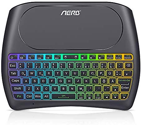

Been using mine with Aerb trackpad great match for the pix
That’s not a Bluetooth keyboard. Is it?
No there is a tiny usb dongle, but it works very well. I want the blutooth for speakers

Good to know guys, thank you, however the AERB keyboard is so sweet to use I’ll stick with it.
I do have a tiny folding blutooth keybpard with touch pad but its just not as ergonomic
