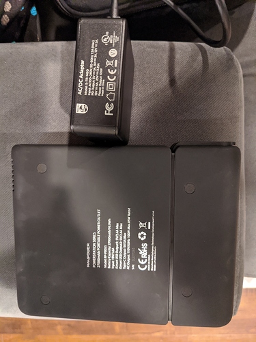

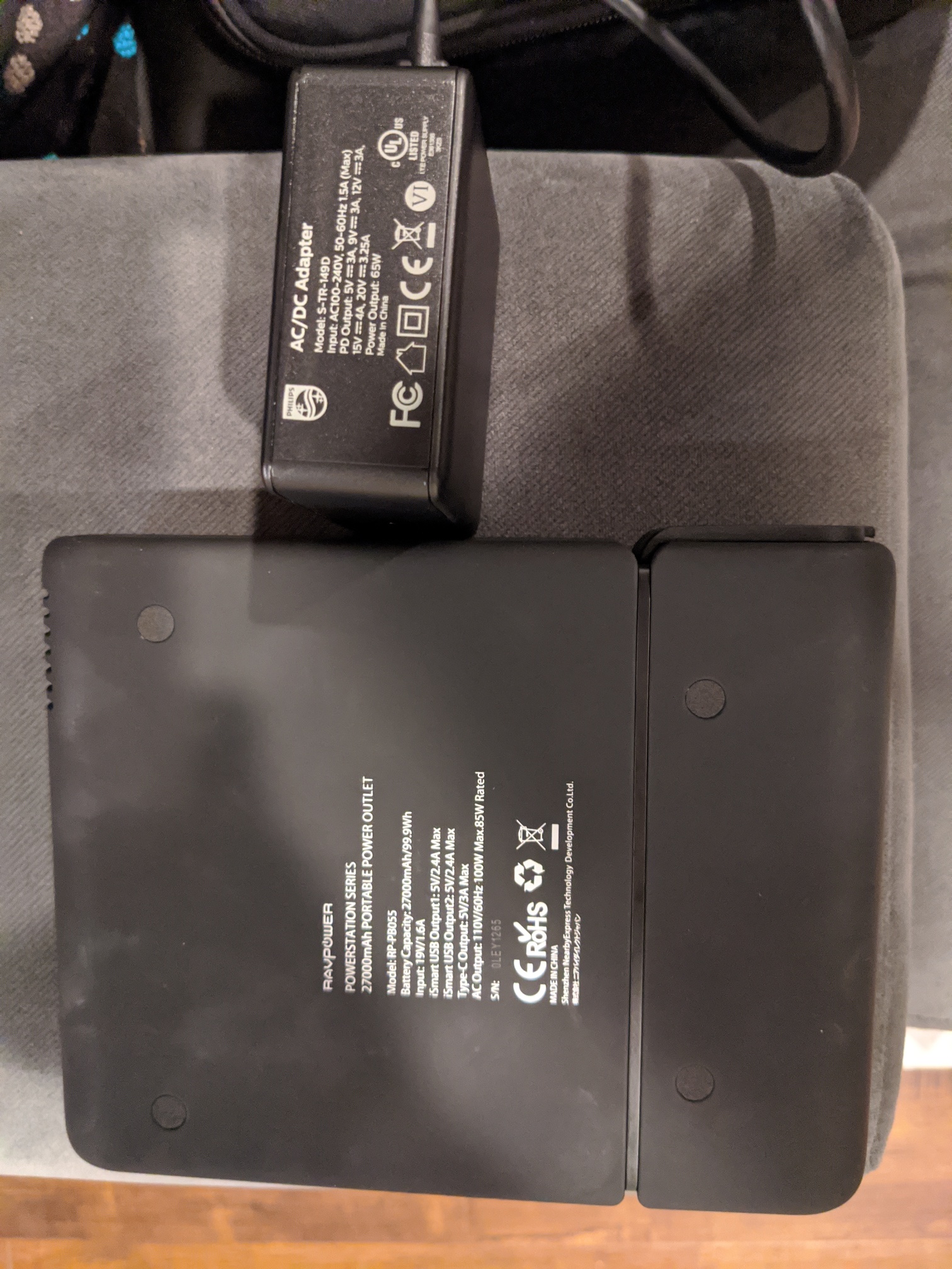

Good to know that it is working with some chargers. But here is what I am talking about. See the 2 videos and photo attached.
Video1:(PPM Charger) Video showing PPM running while connected to charger provided by Philips. You will notice the Red light on PPM indicating it is charging. You can also notice the charging icon next battery on the screen (top right)
Video2:(ExternalBattery) Video showing PPM running when connected to my RavPower through USB C. I see the light on PPM showing it is blue which means it is on. And also NO charging icon appears on top right of screen indicating it may not be charging.
Photo showing spec comparison on PPM charger and my external battery. Both indicate they support 5V/3A
It seems I will just wait for Philips to release the ‘remaining battery %’ in one of their releases soon. That will be my best measure to check that it is charging simultaneously while I am watching something on PPM.
So, I’m pretty convinced PPM only accepts 15V power. Chargers that don’t offer 15V (like the 20V Macbook chargers, 9V phone-oriented chargers, your 5V battery) all seem to be unacceptable to PPM.
Seems like that battery just won’t work at all.
And yea the LED colors are misleading. Red means “charging”, sure. Blue can mean EITHER “fully charged” OR “powered on, no charger”. It’s pretty messy.
Please give us more on-screen power info!!
