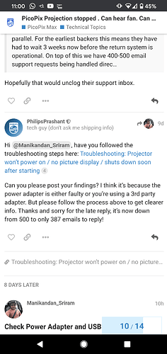

Now this is scary. Someone posted about projector not working to which PhilipsPrashant responded using faulty charger or incorrect charger.
This is the exact reason I want him to respond here regarding what spec charger and external batteries should work with Ppm so that we don’t end up breaking it. (And if possible few tested samples too)
Understandably that you might want to use Philips provided charger to be on safe side. But share some examples for external batteries at least.

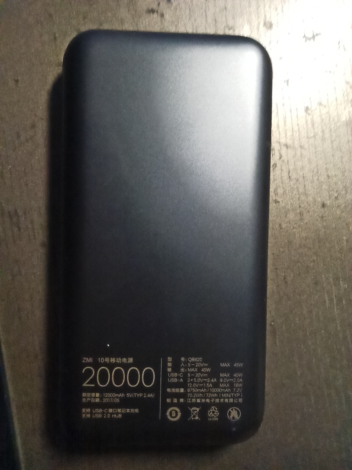

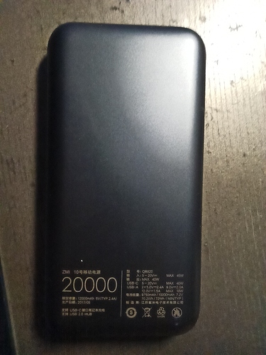

Tried an older ZMI PD power bank today with the USB-C cable that came with the PPM and the red LED goes on and the UI Show charging. - Funny thing is that I think this power bank is to weak to hande charging.
https://www.gearbest.com/power-banks/pp_662137.html?wid=1433363
Input: 5V - 20V, 45W max
Output: USB-C: 5 - 20V, 40W max; USB-A: 5V 2.4A, 9V 2A, 12V 1.5A, 18W max

This proves that the 2 year old ZMI power bank is capable of charging the PPM. - Perfect for me, since I bought 2 of them for my Mibook Air. So no more money to spend…
