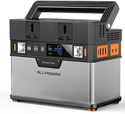

I also own this Allpowers powerbank which has about 4 times the capacity of the zendur and has high power usbc outlet
it also gives a readout of power being drawn and the ppm seems to pull about 54 watts
