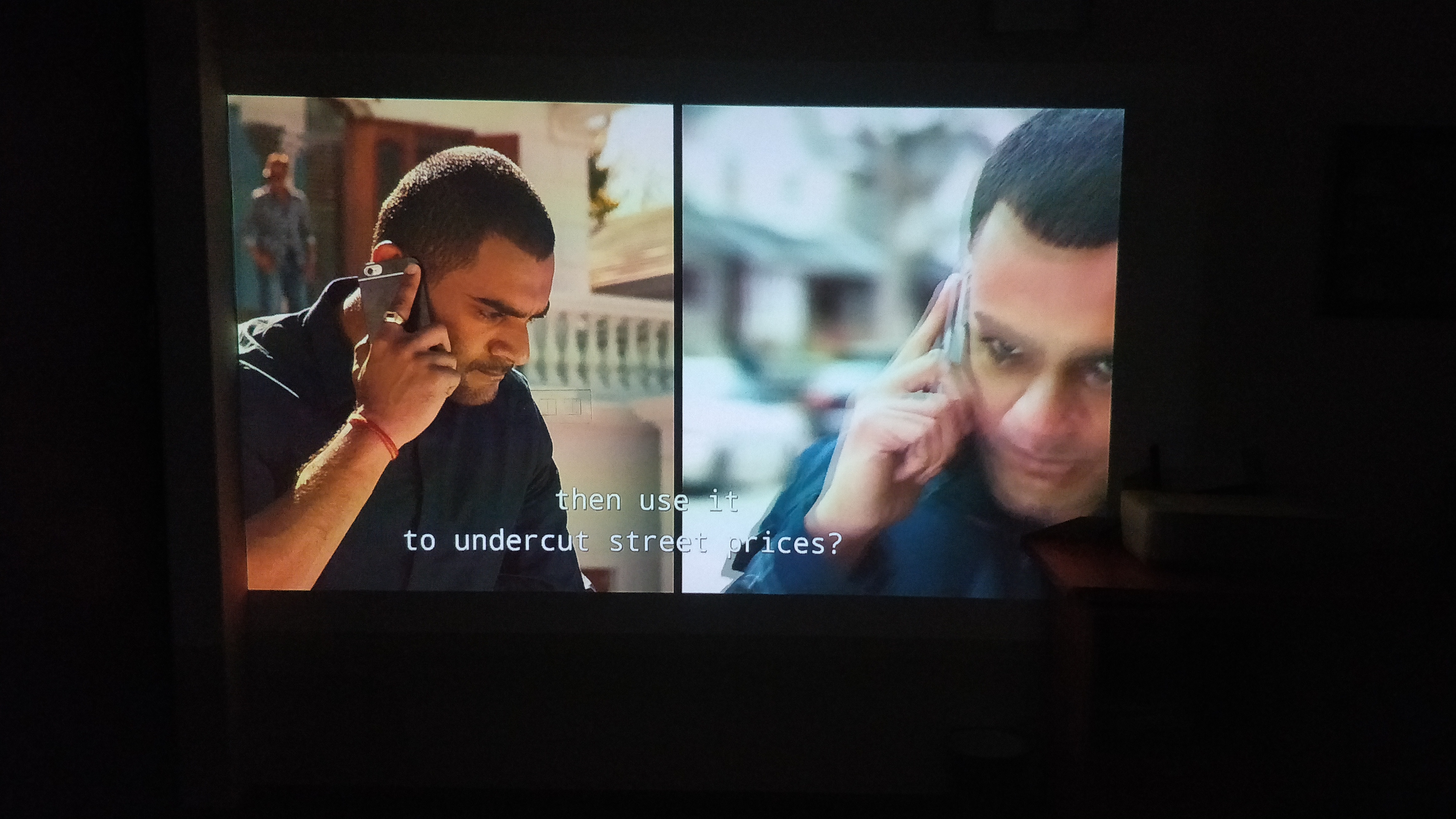

It skewed my image which used to be fine when placed flat facing the screen area …
Now image from the right is lower from the top as can be seen in this picture .

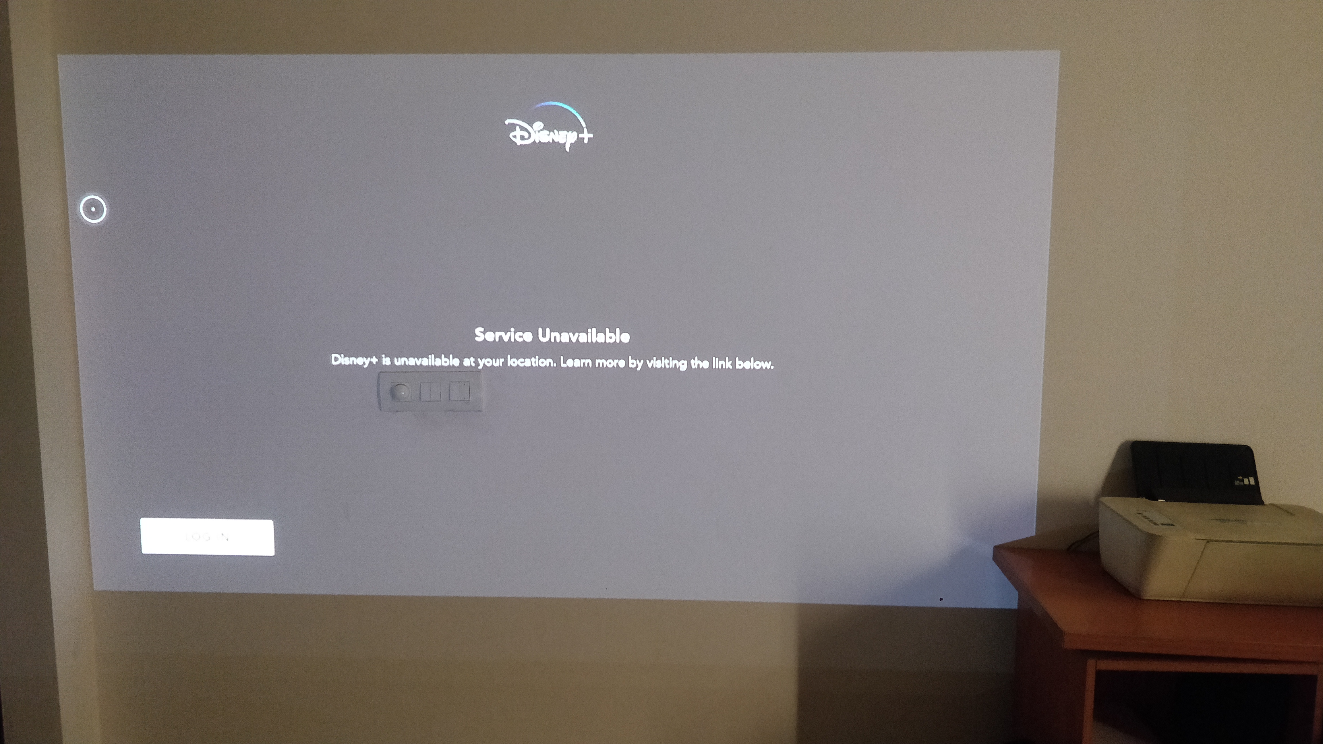

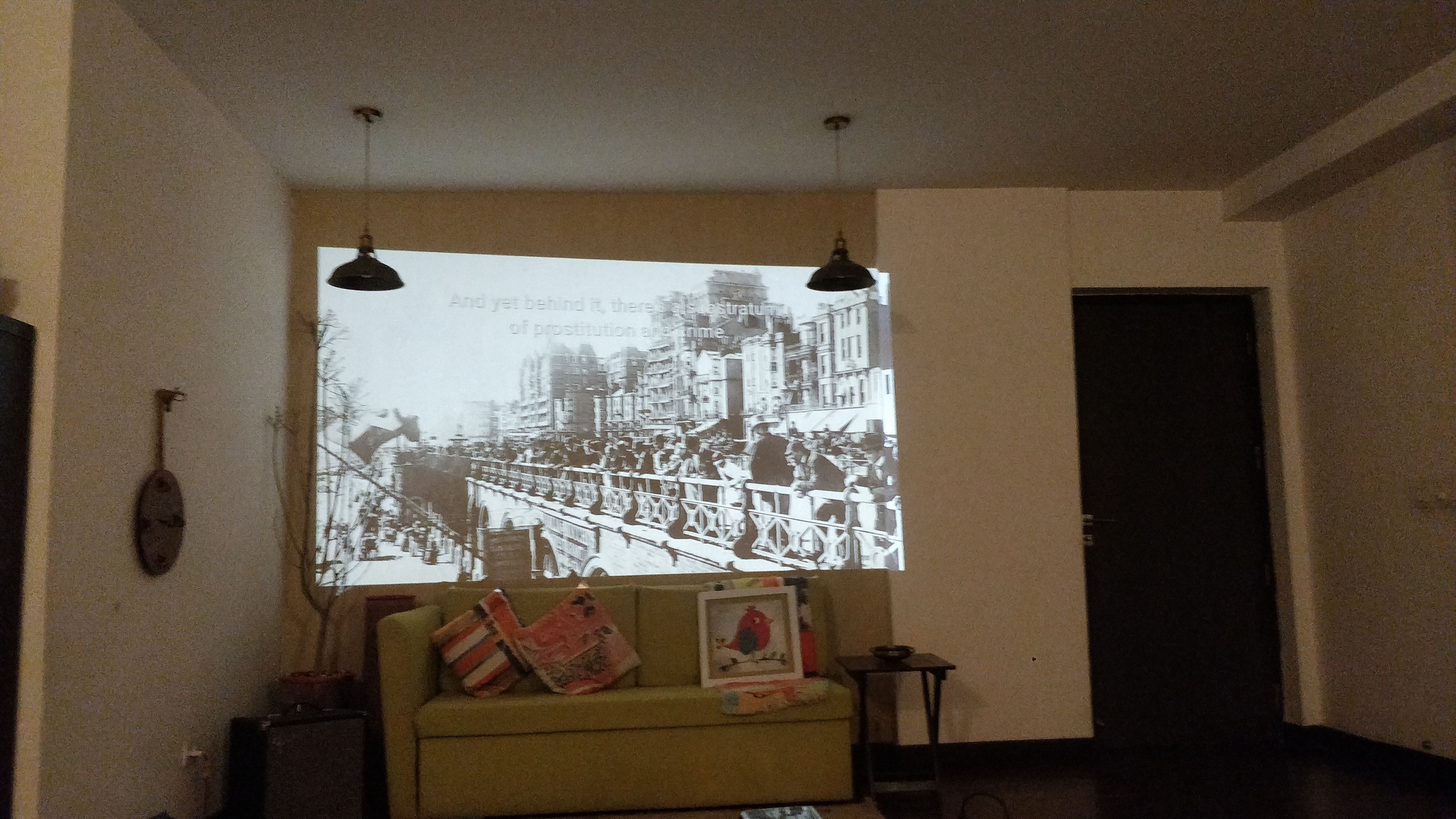

Hi @macsan0123 these don’t seem to be software issues. In the first picture after recalibration the image looks higher on the left side, in the 2nd pic on the right side. I think you should carefully check where your projector is sitting. It’s common for it to be a few mm higher on one side, or slightly turned to left or right side. Remember that a small variation on the projector will get magnified many times on the wall. If finding the perfect placement is proving challenging, you can always use the 4-/5-corner correction feature.

My issue was before this upgrade I never had to calibrate .
After this upgrade I had to and I calibrated using the leveller.
Im really not a fan of manual correction.
Anyway I now understood what you are saying .
Though I feel my pico is facing the wall straight ahead I had to slightly tilt it to get the rectangle to look better.
Plus minus some degrees it anyway should give a straight picture don’t u think ?

By the way is there no working disney in aptoide ?
This one is giving me region issues …

After reset (to fix my vertical auto correction issue and skeqed image )i got a non working disney and a Netflix which is different from the one you loaded on this update .
How do I fix this?
Pls advise
