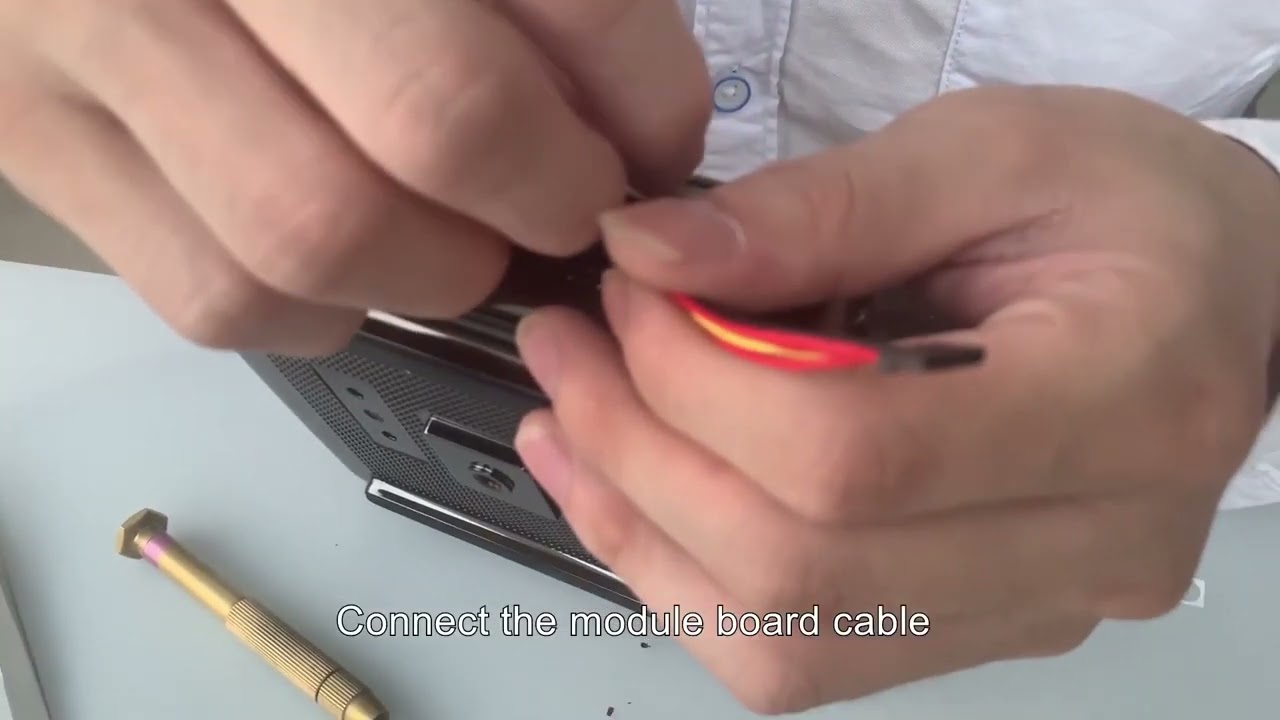

Hello community!
Our engineers in China made a video to show you how to change a bloated battery:
Best regards,
Thanks for the video. Where can we get a replacement battery though?
please contact our customer care at philips.projector.eu@screeneo.com
I also found the battery bloated today. Thanks for the advice. It is not necessary to remove all the cables and motherboard screws as shown in the video.
Good is that the projector also works without the battery and that the covers are not glued.

  1. You need something much more stronger than fingernails to open the case
  2. There is no need to remove the motherboard, if the case is open and you see the battery cable, that’s it, just unplug it and you are done with that part
  3. The battery is glued to the case with an adhesive strip, so it’s really hard to remove it
Mine
He obviously knows which cable goes where. The rest of us would be better off taking a photo before removing all the cables.
Also, he apparently grew his thumbnails just for a task like this :grin:
